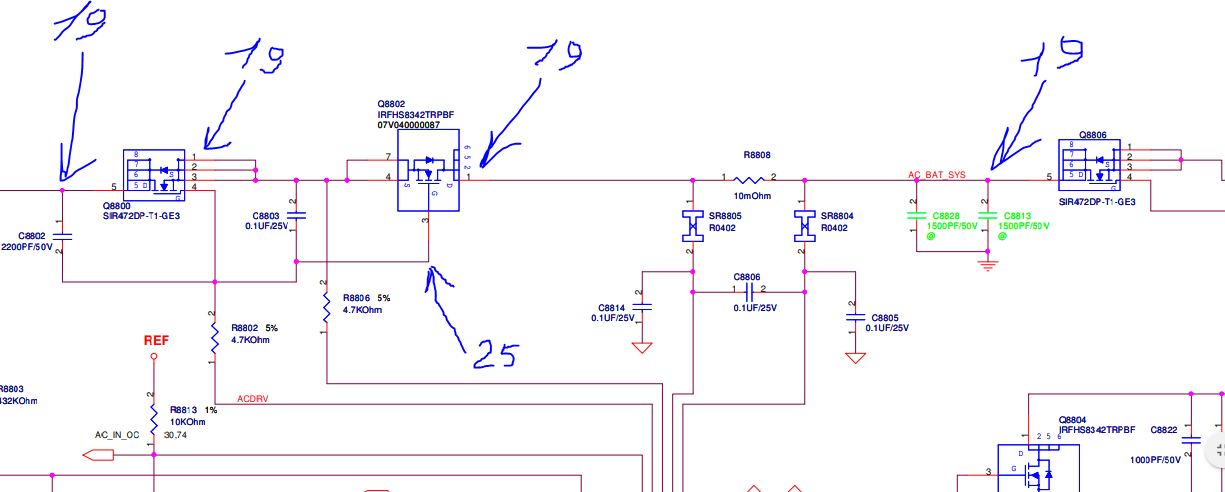

    hello everyone, this acer with battery turns on normally, so also with battery and power supply you turn on and charge the battery, but with only the power supply does not turn on, turn on a second all the LEDs, it is normal to turn on only with battery insert? usually they light up even without
  • mcplslg123
    • Jun 2015
    • 7262
    • india
    Re: acer aspire V3 771G VA70
    its not usual. Should turn on with only adapter. Check DC-in mosfet.

          unfortunately on the card I cannot identify mosfets because the name is not printed
            Bottom side of DC connector 2 Fets Caps & CLR test the Gate Voltage of 2 fets
            Gate Voltage must be high than DRAIN
              these are the voltages present by connecting the ac connector, without having yet pressed the button power

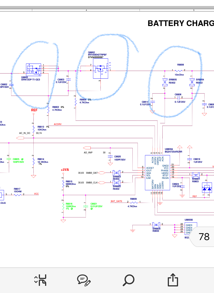

                thats good now test all pins of BQ24725 for voltage and AC_IN_OC pin 120 of U3001
                voltage L8100 L8101
                voltage U8100A pin 3 13 7

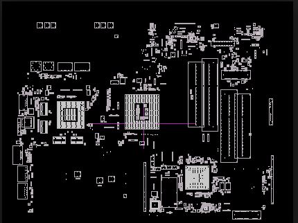

                  you have a boardview of this project otherwise I can't find all the components on the card, thank you very much
                  • mcplslg123
                    • Jun 2015
                    • 7262
                    • india
                    Here is the boardview
                    • poweron
                      • May 2019
                      • 371
                      • italy
                      I opened the file but it does not match my sheet: VA70 / VG70 Rev: 2.1
                      this is the right one
                          bottom side of the Boardview you have U3001 SIO chip it is matching, mcplslg123 have send
                          the board posted by mcplslg123 is this bottom side

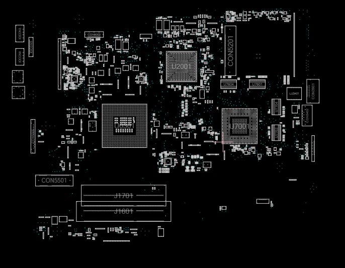

                            and this is the top side
                            • poweron
                              • May 2019
                              • 371
                              • italy
                              the one on my card is this top side, as you can see it's different, I found it on the net but I can't download it
                              • mcplslg123
                                • Jun 2015
                                • 7262
                                • india
                                as long as kbc is same in both versions of boardview, where is the issue. You can simply findout the pins to be tested and proceed further.
                                  these are the voltages on U8800 BQ24725:
                                  pin 1 = 19v
                                  pin 2 = 19v
                                  pin 3 = 19v
                                  pin 4 = 25v
                                  pin 5 = 3.2v
                                  pin 6 = 2.6v
                                  pin 7 = 0v
                                  pin 8 = 3.2v
                                  pin 9 = 3.2v
                                  pin 10 = 3.0v
                                  pin 11 = 3.2v
                                  pin 12 = 3.2v
                                  pin 13 = 3.2v
                                  pin 14 = gnd
                                  pin 15 = 0v
                                  pin 16 = 5.9v
                                  pin 17 = 5.9v
                                  pin 18 = 3.2v
                                  pin 19 = 3.2v
                                  pin 20 = 19v
                                  on pin 20 of the kbc U3001 I measure 3.2v AC_IN_OC
                                    pin 1 = 19v
                                    pin 2 = 19v
                                    pin 3 = 19v
                                    pin 4 = 25v
                                    pin 5 = 3.2v
                                    pin 6 = 2.6v
                                    pin 7 = 0v
                                    pin 8 = 3.2v
                                    pin 9 = 3.2v
                                    pin 10 = 3.0v
                                    pin 11 = 3.2v
                                    pin 12 = 3.2v
                                    pin 13 = 3.2v
                                    pin 14 = gnd
                                    pin 15 = 0v
                                    pin 16 = 5.9v
                                    pin 17 = 5.9v
                                    pin 18 = 3.2v
                                    pin 19 = 3.2v
                                    pin 20 = 19v
                                    Well as for the voltage's seems to be correct, these measurements taken with out battery inserted ?
                                    • poweron
                                      • May 2019
                                      • 371
                                      • italy
                                      exact, only adapter
