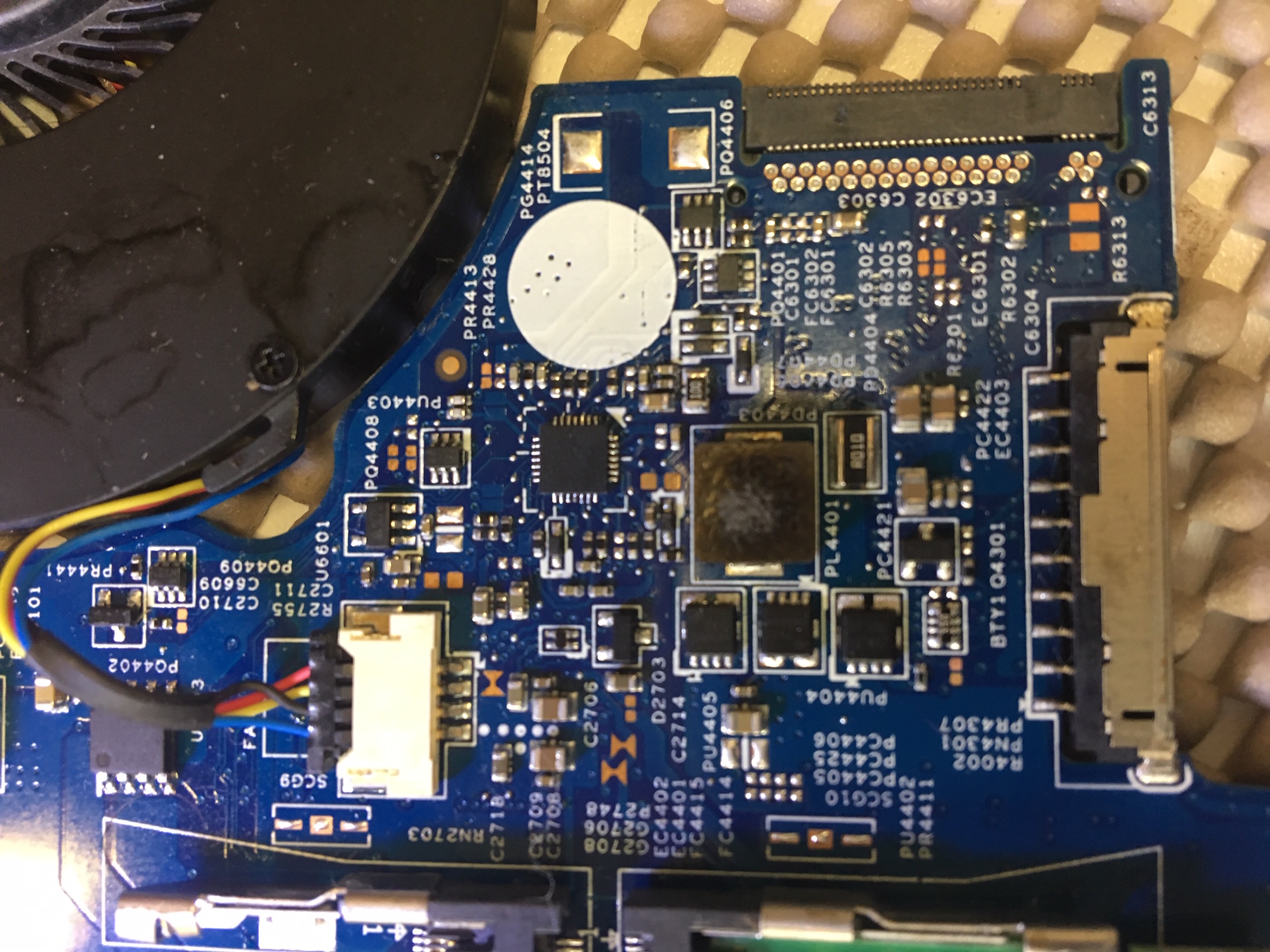

    Hi all, need help in repairing this notebook. Any help across the world will be greatly appreciated. I am working on ACER Notebook Spin 7 Model SP714-51-M5H3 logic board. The notebook is working fine but only problem is the battery does not charge. The battery is brand new. On the first instance one of the Battery charge MOSFET blew out. I replaced it & started to get voltages on the battery terminals of the main logic board. But this voltage is 18.5 voltage not the regular 11~12volts & when I plug in the new battery the Mosfet turns hot. Then I replaced with original MOSFET (A5 GNE) & checked the other mosfet (AON7410), they were all good but no difference with the voltage still 18~19volts DC. Checked the Schematics (Acer VN7-592G Rayleigh 15292-1) & the charging chip BQ24780S. I noticed on Pin 27 ("Phase" PWR_CHG PH) its generating 18.5V whereas the voltage on this pin should be 11.5 ~13V. Then I replaced this chip with a brand new, NO LUCK., voltage is not getting under 18v. Checked all the components nearby, all diode & resistors seem to be ok. Any help or tips to repair this board will be greatly appreciated. Thanks in advance

                        Thanks for all your replies. I checked the pin 26/27 & they are not short., checked under the microscope to see if I did not solder the chip right but all is fine.. Did a good ultra sonic cleaning to the chip & nearby components. This seriously has become a challenge for me.. Check the photo pls. of the replaced MOSFET & the location where I am checking & troubleshooting., & if one observes the inductor PL4401., it was draining so much amps when I installed the brand new battery that it became very hot & lost its color. But this was happening before with the old battery too, this is why the old battery does not give out any voltage on any of its battery terminal pins.. & if one observes the schematics, I see that pic of PU4402 is a PNP FET & when I actually check the PDF of this FET TPCC8103-GP, it clearly is a NPN channel. On the Gate & Source of this FET PU4402 I get 19Volts & on drain I should be getting around 12volts, whereas this is 19v too. So confusing!!!

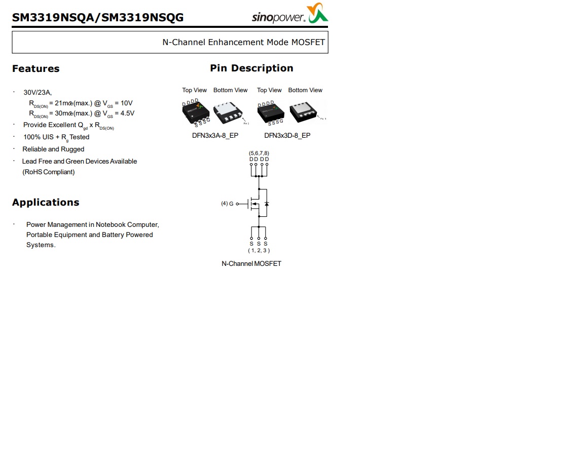

                          The TPC8103 shows a P-channel when I looked it up, so matches the sch. The other charging FETS (HI/LOW) are N-ch.
                          https://www.digikey.ca/product-detai...-CT-ND/2310694
                          Have you replaced PU4402?

                              I think the schematic you have is incorrect, or not the right one for your MB.
                              As per the BQ24780S pdf, the FETs are suppose to be N-ch. (1st page of attachment), including the BATFET (PU4402 in your case). All the FETs you have on the MB are N-ch as you have found out
                              I would still be looking at the PU4402, and also the BQ chip.
