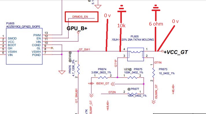

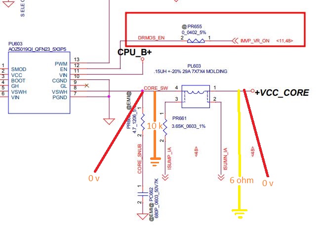

    Originally posted by poweron
    PL605 (VCC_GT) and PL603 (VCC_CORE) = 0v
    PL601 (VCC_SA) = 1.0v only for 1 sec, pressing power buton is present for 1 sec
    PL301 (+ 1VALWP) = 1.0v only for 1 sec, pressing power buton is present for 1 sec
    PL200 (+ 1.35VP) = 1.35v only for 1 sec, pressing power buton is present for 1 sec
    PL100 (+ 3VALWP) = 3.3v always present
    PL101 (+ 5VALWP) = 5.0v always present
    PL700 (+ 17.4V_BATT) = 17.4v battery charging voltage always present
    Test PL605 (VCC_GT) and PL603 (VCC_CORE) resistance mode not in DIODE
    Try and Remove one Leg of PL605 & PL603 to find out if the MB power up with no image

      Re: dell vostro 3559 la-d071p does not turn on
      I removed the two coils but the mobo does not switch on, the voltages are not present, the resistance to ground is 6 ohms

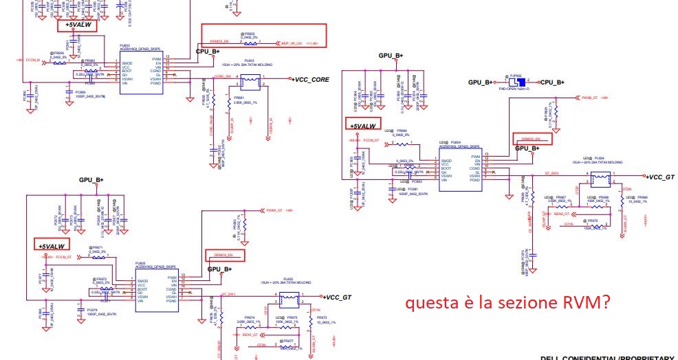

                      btw, did you checked the mosfets connected to vrm section. These are a bit complex fets where a single fet is made to replace 2 fets. I found one of those fets faulty on this very mb almost a week back. Symptoms almost similar-it turns on and turns off within few seconds without any display. So do check that part.
                      • poweron
                        • May 2019
                        • 371
                        • italy
                        #31
                        I will check as you say, but what is the vrm section?
                          That's for the CPU section and check this out for power Sequence
                            who enables the VCC_CORE and the VCC_GT the signal DRMOS_EN?
                            • poweron
                              • May 2019
                              • 371
                              • italy
                              #34
                              the signal DRMOS_EN not present,I note that this notebook had shut down by itself while it was working
                              • Techtiger
                                • Oct 2014
                                • 1602
                                • france
                                #35
                                trace back IMMP VR ON
                                • poweron
                                  • May 2019
                                  • 371
                                  • italy
                                  #36
                                  the IMVP_VR_ON signal is present only for 2 seconds together with the power led lighting up when I connect the power connector, but if I press the power button nothing happens
                                  I have to correct: DRMOS_EN is also present for 2 seconds in the same way as IMVP_VR_ON
