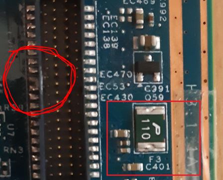

                Hell. I made a photo . Which one is F3 the big green or a small vertical element?
                Photo: https://imgur.com/a/oGxUIOo

                  Re: Probook 4520s no backlight
                  1A/6V that could be it
                    I saw that ona a bord. But which one is that? I don't have the other harfware from that laptop so I cannot try and power the board. I just need to know which one is correct so I'll try when I get other bits of that laptop.
                      just measure its resistance
                        Check the pins on the connector for short,and resolder them with lots of flux .
                          it is easier to check that on fuse. it is directly connected too
                            Tnaks. I ahven0t notice that. It's brand new board which I sold to a custoer which returned it as faulyt-no backlight. So I assume he conected lcd cable when MB was under charge.

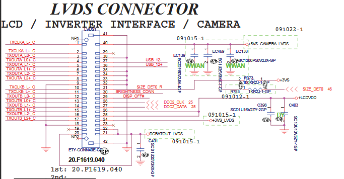

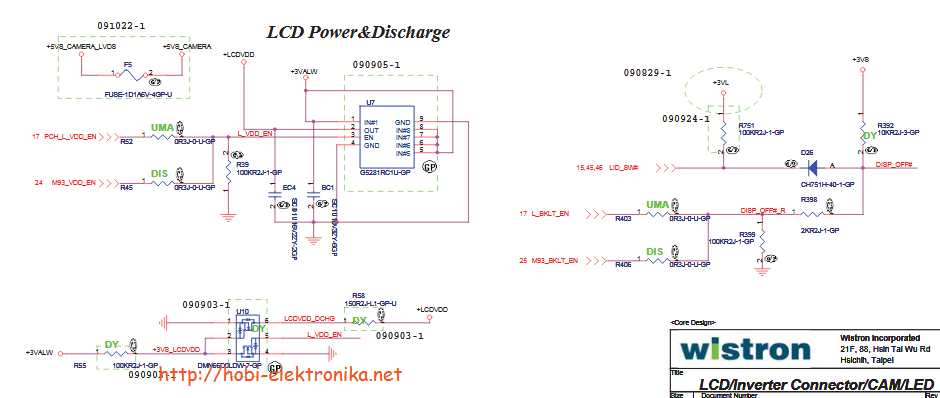

                              Check this attached schematics. Check the voltages
