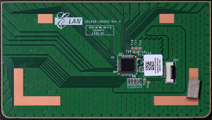

                          Re: Asus G751JY not turning on when touchpad is connected
                          Originally posted by SMDFlea
                          Can you take a picture of the whole touchpad pcb area .
                          Here it is. This picture origins from internet but it's same as my board.
                          Chip is marked as 33200D-3000 1448 BG14B01 or (BQ1)

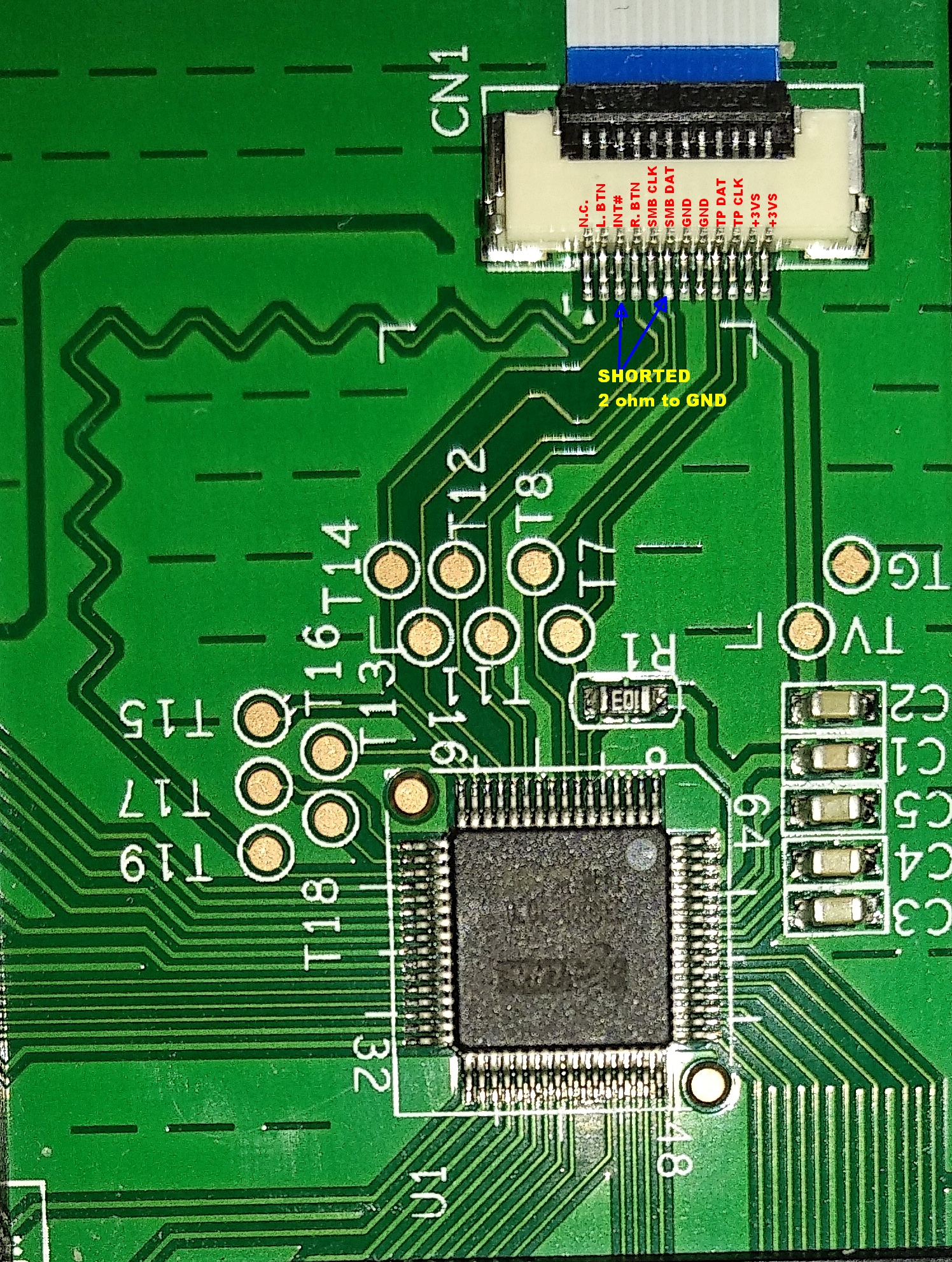

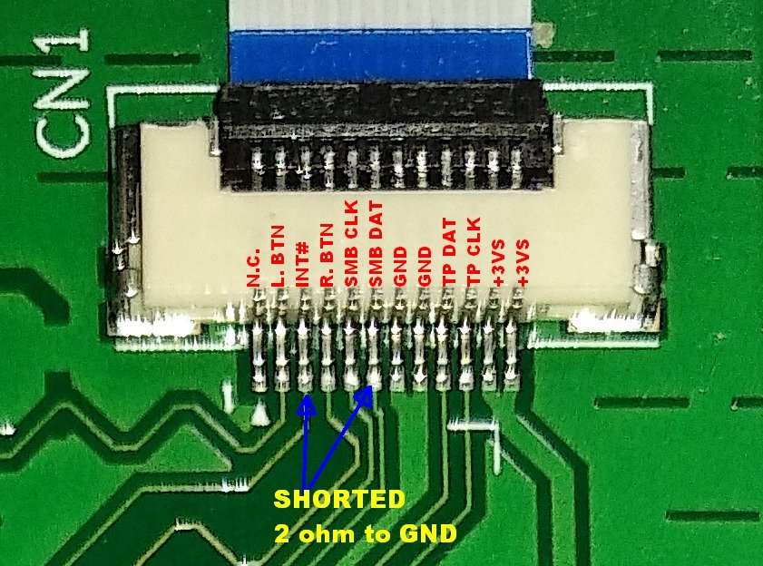

                                On touchpad, when not connected to anything:
                                SMB DAT and V5620 INT# have only 2 ohm resistance to GND.
                                All other resistances are in kiloohms or even in megaohms.
                                All capacirtors are OK, resistor is OK.
                                Maybe is better visible on picture.
                                There are no difference with or without D3110. Difference is only when power is applied, regardless of D3110.
