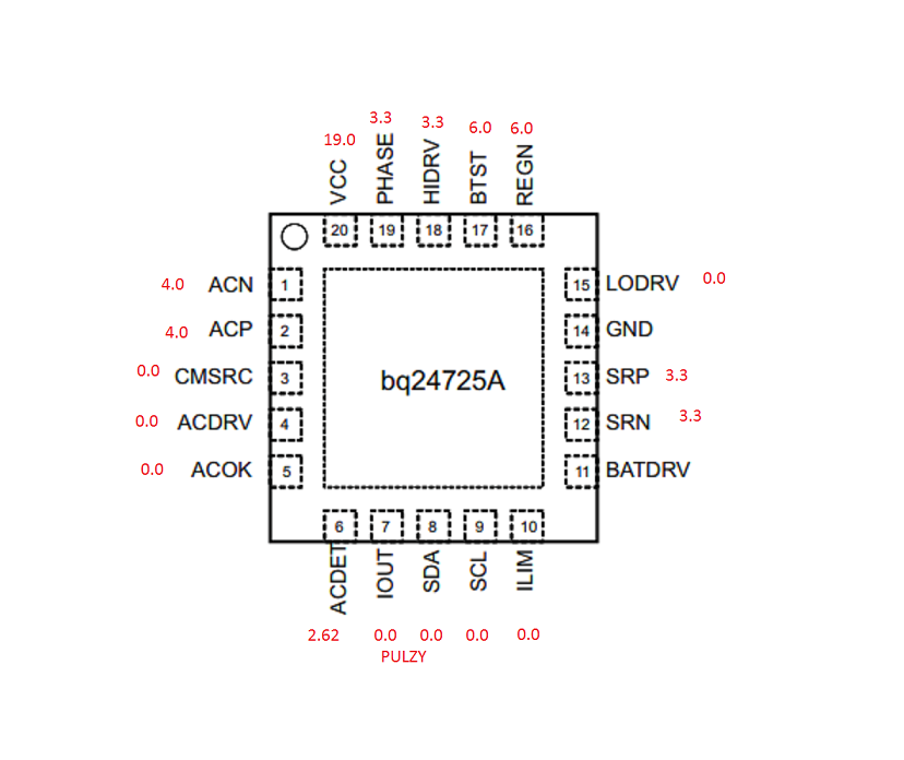

    Hello
    Dont have anything to repair so im messing with K55Vm booard that not work at all
    ACOK is pulling down from BQic because i removed all components from this rail and still pulling down
    I make measures on picture. no short, but pins 7-10 is getting short pulses of voltage. in suspecting IT KBC but dont have schematic or boardview to check more on it before i remove it. any hints?

    Heres a rev 2.2 boardview https://www.badcaps.net/forum/attach...0&d=1478116649
    Check +3V

      Re: k55VM - messing with BQ24725
      no voltage ?
        ok. i measured all mosfets for short and found nothing so i jumped that two mosfets and board and working.
        and now i have working ACOK and all others signals from BQ
        try to replace that two mosfets
          removed, tested with multimeter and was ok, but replaced to be sure and still the same story.
          BQ replaced two times and still the same
          i see that i have not the whole board. on my board is BIG slot i think for add board and in BV i see there is DOCK so there may be culprit.
          not detecting dock board so maybe KBC pulling EC_SMB_CLK and EC_SMB_DA signals down
          If anybody know more plase post it
