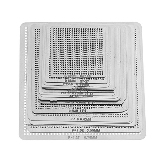

    hello gays
    i have a dell E7450 and it have problem with the i/o chip
    a have bay them but they need a stencil to build the legs of the ic
    the ic number is ECE-5048 or MEC5085 the both of those ic they have the same
    pins
    thenaks

    Re: need stencil ECE-5048 MEC5085
    hi
    take flux on the chip and then do with your soldering iron balls at them
    The same with the mainboard
      it is not working because it is a sort of chipset
      and it is very important to build those balls other wise it will not work
          Originally posted by mielta
          hi
          making balls on board?
          how the fck u can place it when soldering it?
            u can lower heat and make pyramid like this
            https://www.youtube.com/watch?v=rpOco3vuZO8
              if chip is not too big do manual reballing...
              clean pads, put flux, put chip in holder, get a nice tweezers and put balls one by one
              heat them up like you would after removing stencil and you are good to go
              also you might wanna try "universal stencils"
                you must have That
                Polyimide Stencil
