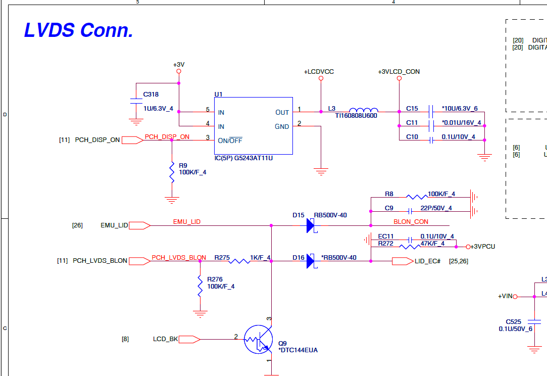

    HP 15-B142DX DA0U56MB6E0 Rev. E after water damage i have black screen, Laptop with external monitor is working ok.
    On U1 chip i have +3V on pin 4,5 but 0V on pin 1 & 3

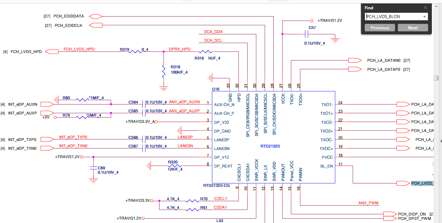

    On U16 chip i have 3.3V on pin 3, 9,10, 13, 18
    pin 16 ---> 3,02
    but pin 14,15 ---> 0V
    Any help or idea where is the problem, where to check next

    for the U21 pin 3 should get PCH DISP ON signel to +3V to transfer +LCDVCC +3VLCD CON L3 coil
    test Pin 16&15 for resistance to GND
    test pin 27.11.12.7.12 ?
    pin 1&2 +VIN LVDS CONN ?

      U16 resistance to ground pin 16 .0680
      U16 resistance to ground pin 15 .0564
      U16 resistance to ground pin 14 .0587
      Pin 7 ---> 1.17V
      Pin 8 ----> 1.19V
      Pin 11 ---> 1.17V
      Pin 12 ----> 1.18V
      Pin 27 ----> 1.17V
      pin 1&2 +VIN LVDS CONN ---->19V

        If you put a jumper U1 pin5 to pin1 you can transfer +3.3V to +LCDVCC +3VLCD CON L3 coil it might work it’s up to you
        ( remove the nap and test weather voltage get’s for the pins)
        Or change U16

                        I will try to make a jumper first also i found that L3 is missing can i make a jumper for L3 or must replace?

                          Re: HP 15-B142DX No image
                          What do you mean it's follen Down or it's Originally not there?
                              Follen down
                                Follen down
                                Ok then replace it
                                  Ok then replace it
                                  I can't find exact smd part, can i replaced with this https://www.arrow.com/en/products/ci...ctro-mechanics
                                  is the same but the Max Rated Current is 2.5A instead 3.Α
