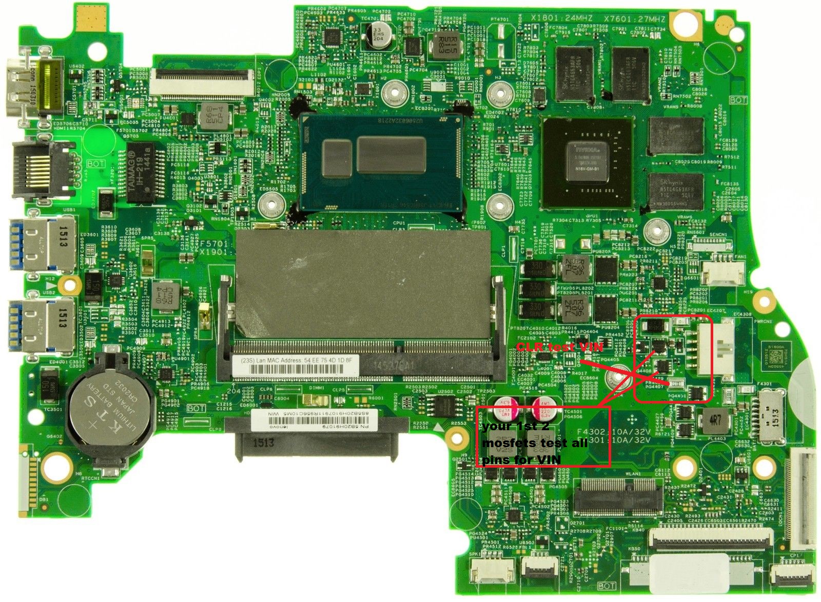

    hello guys....need your help
    i got lenovo yoga 500
    LT41 MB 14217-1M
    it turn on a few sec then off.

            updates ..
            i tried new battery and its work with the battery only..
            but not charing.
            not working with charger.
            checked charger " good"
            checked charging pin "good"
            checked voltage in mobo 20v "good"
            what is wrong guys...pls help

              Upload the Schematic if you can
              What is your Charger IC BQxxx or ?

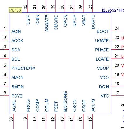

                    The Compal LA-D071P has a ISL95520HRZ (PU703) on page 4 of the schematic ,and on page 42 as ISL95521HRZ (PU703).

                        ISL95520HRZ test pin 1.2.30.32
                        • rickybucalan
                          • May 2013
                          • 322
                          • philippines
                          Re: lenovo yoga 500-141BD power goes off a few sec
                          pin 1 = 2.9v
                          pin 2 = ov
                          pin 30 =0v
                          pin 32=19v

                            Now test your 1st 2 Mosfets for voltage in all pins and for short in Diode mode multimeter without power or Battery

                              In pin 18 at ISL95520HRZ is one resistor 10 ohm.
                              In found this resistor with big resistance,about 80k ohm.
                              On pin 18 shoul be about 19v but was just 16v.
                              PR743=10 ohm on Compal LA-D071P.

                                  Yap you are good. I have board lt41-14271 YOGA with the same chip PIN 18, VERY LOW VOLTAGE (must be DCin adapter or battery). I found bad resistor (PR4437) 2.2 ohm.

                                    The low resistance may be normal and is for a current sense resistor. Can you link a schematic if you have one?
                                    Which pin has this resistor?
                                    Yes, the dcin should not be low. Remove all power and review to locate mosfets that will be nearby. The mosfets are like solid state relays that pass the voltage from your dcin adapter to this ic but only if the gate pin is the correct voltage.
                                    Share full details of the mosfet markings so we can check if the mosfets are N-channel or P-channel.
                                    Which logic board are you repairing? Post all details.

                                      ISL95520HRZ There is a 3.2k resistor in front of the 18th leg output, remove it, insert a 10 or 20 ohm resistor, the battery will start charging
