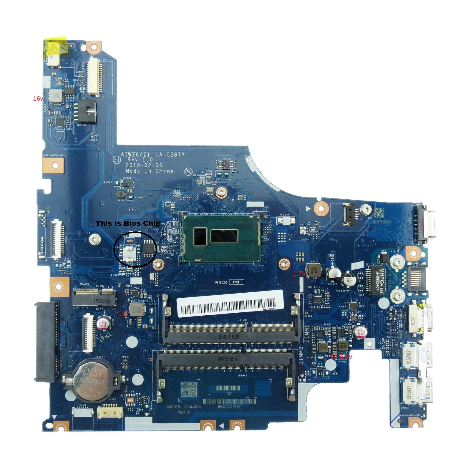

              ce que je peux dire deja c'est que pour les coils :
              -pres de la batterie : 0.228 ou 16v si la bat est branchΓ©e
              -pres des rams 1.3V que apres avoir appuyer sur power
              -pres du cpu : 1.7V que apres avoir appuyer sur power sinon 0V
              -entre les prises usb et les rams : 5V et 3.3V pc eteint ou pas
              -sur le bios : 3.3V toutes les pates
              il n'y a que ces 5 coils
              merci

                is this you Mob & the PL Coils Voltages are correct ?

                  yes this is the mob i have
                  and yes i have all this voltages, 1.3 and 1.7 are presents only when i push power button (i think it's normal : voltages for cpu and rams ?)
                  i have no shorts on coils
                  but when the laptop have done multiple loop, the coil of the cpu is a little hot.
                  new thing : once, when the laptop began to loop (when the light was on 1 second), i have touched the area near 3+5V cols , then the light stay on but fan was off , no display, no sign of life but this light.

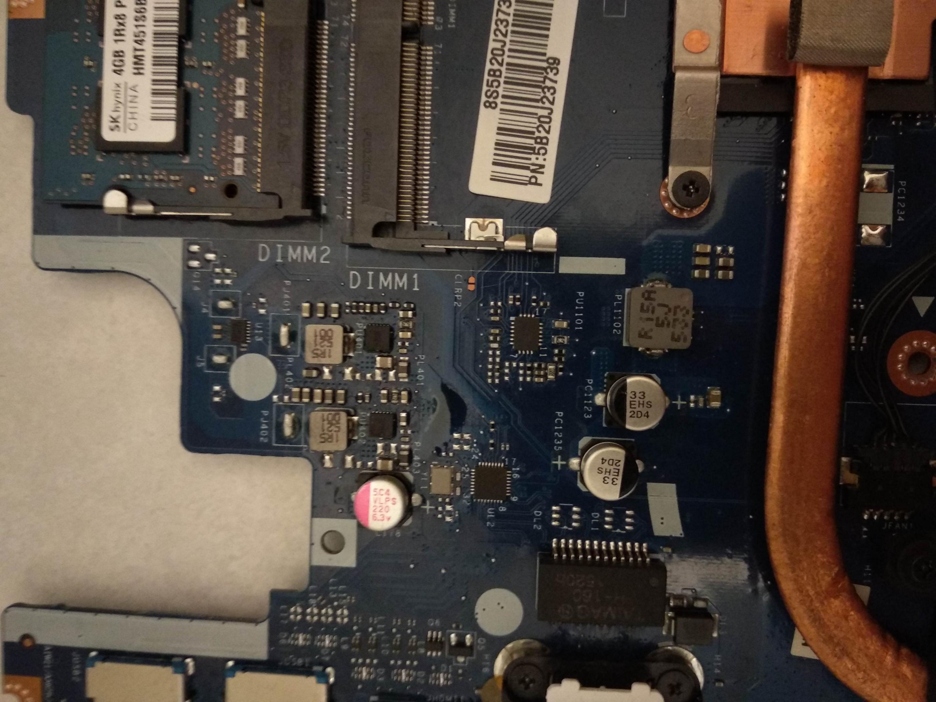

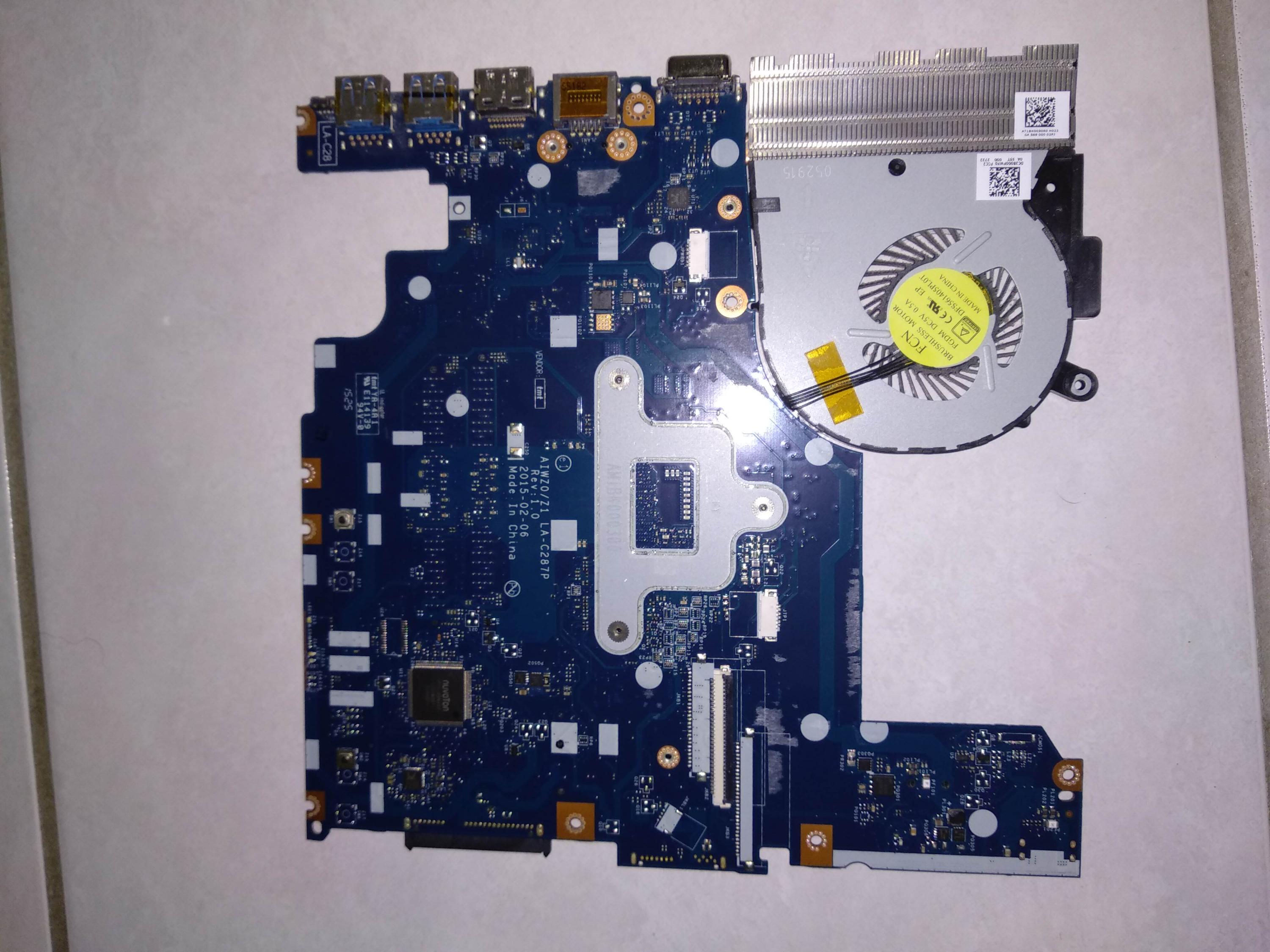

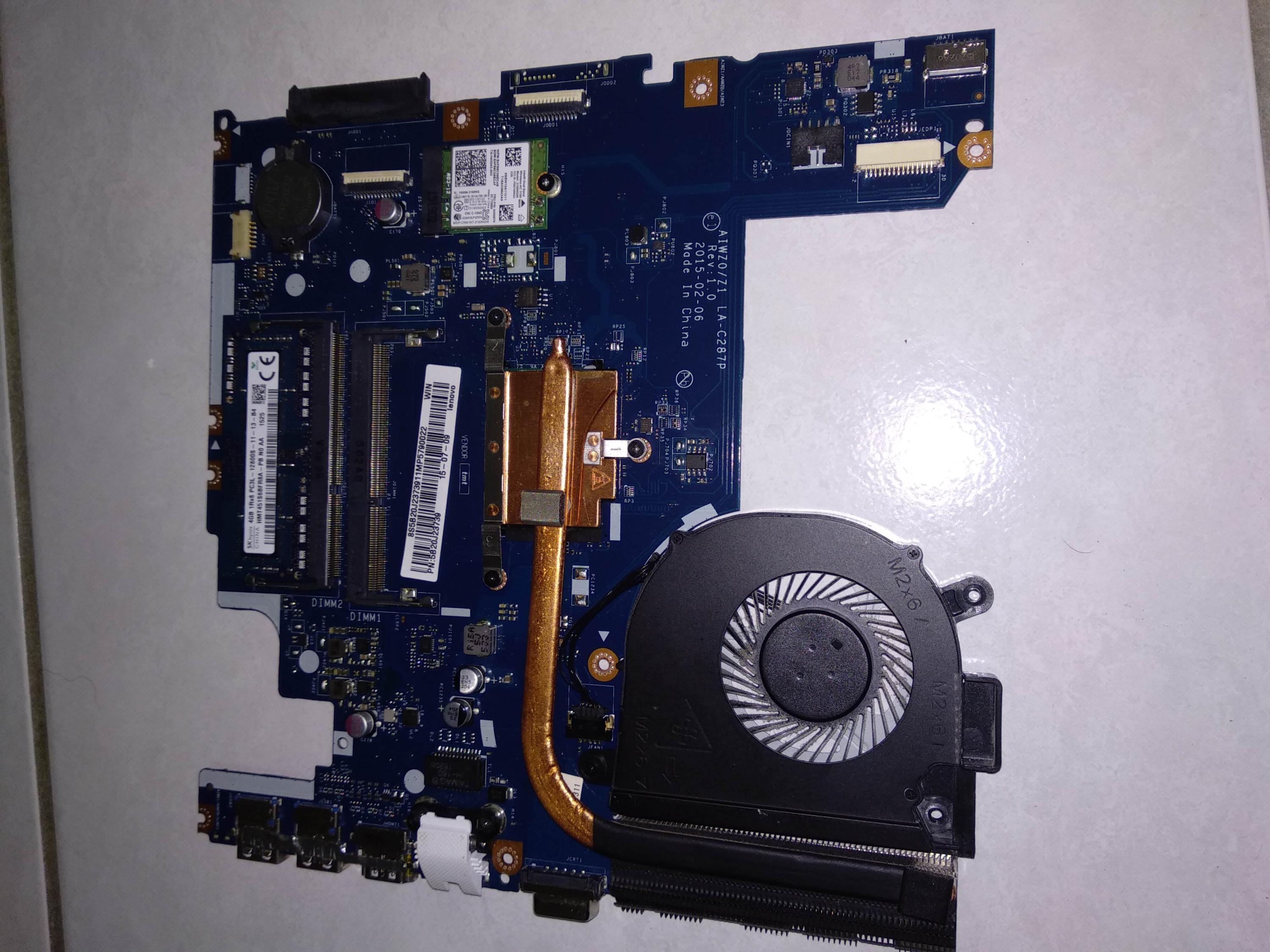

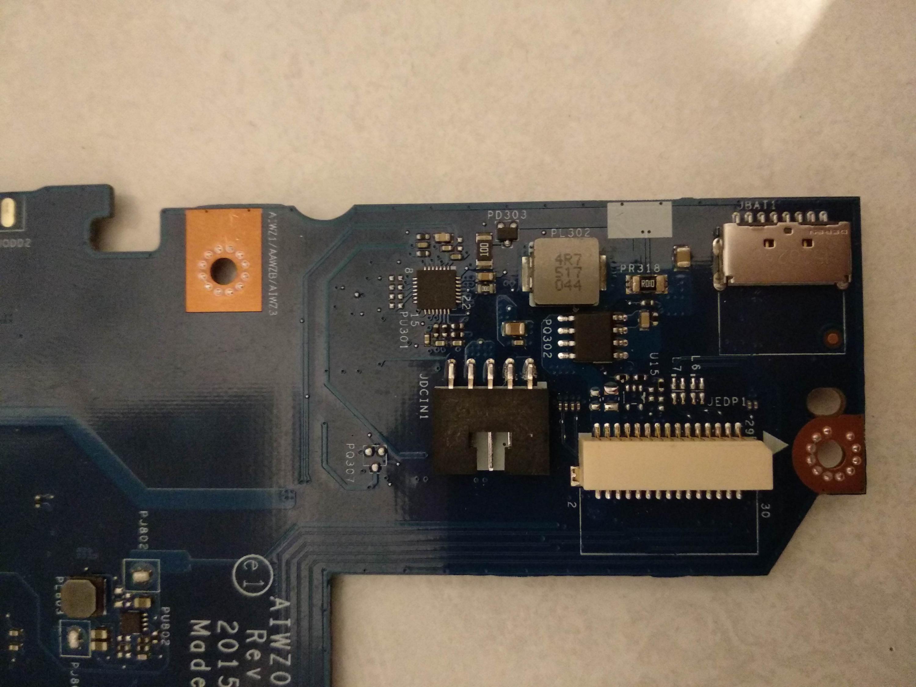

                            hello, here some pictures, not enough time to do it before, thanx

                              Re: Lenovo z51 : no display, fan spin and stop looping
                              this is your Schematic
