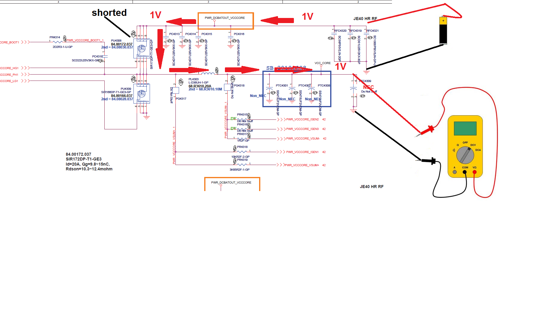

                        It appears that more of the original issue is that I have a short to GRD on B+ rail (I removed PR302 and the short is only on the one side). I tried using a power supply to the B+ side at 19V, 1A and couldn't find any component that was hot. Even went up to 3A, and nothing was really hot. What should I try next to hunt down the short? I've removed PC305-308 and still short is present. There is no cap at PC323
                          19V required for finding shorted??
                          1. B+ not only one page/block circuit.
                          2. Prefer starting inject with LOW VOLTAGE
                          3. Make list of parts that have possibility for shorted. For easy find that position on mobo. Capacitor:
                          • PC305-308 (charger).
                          • PC404-405 (3V/5V).
                          • next block +1.1VALWP/+1.5VP-------APU CORE.
                          • Also give more attention for HS Fet (high side mosfet each block circuit on regulator) if one them have shorted (drain-source). with 19V, i think will goes to Coil/output. Is it save for CPU, Chipset???
