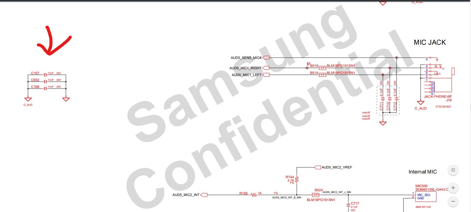

    IC chip getting hot when turn it on
    Hello everyone, I have a Samsung NP-N148 with motherboard code: BA41-01283A, the IC sound ALC269Q-GR getting hot when I turned it on. Checked 3 caps C157, C168, C632 with multimeters, its shorted to GND, after removed 3 caps C157, C168, C632 but nothing change. I'm confused with this schematics that I marked the red arrow. Which pin from IC ALC269Q-GR connect to these caps?
    Can you give me any solution to fix this problem, please? Thank you

    Re: IC chip getting hot when turn it on
    These caps are between common groud and audio ground, they are not related to ALC chip directly.
      If the audio codec IC is getting burning hot when powering on most likely it's the culprit. Could still be an overvoltage due to issue on one of its power supplies.
        remove the chip and test laptop. if its all ok, replace chip
          check the speakers for short circuit .
