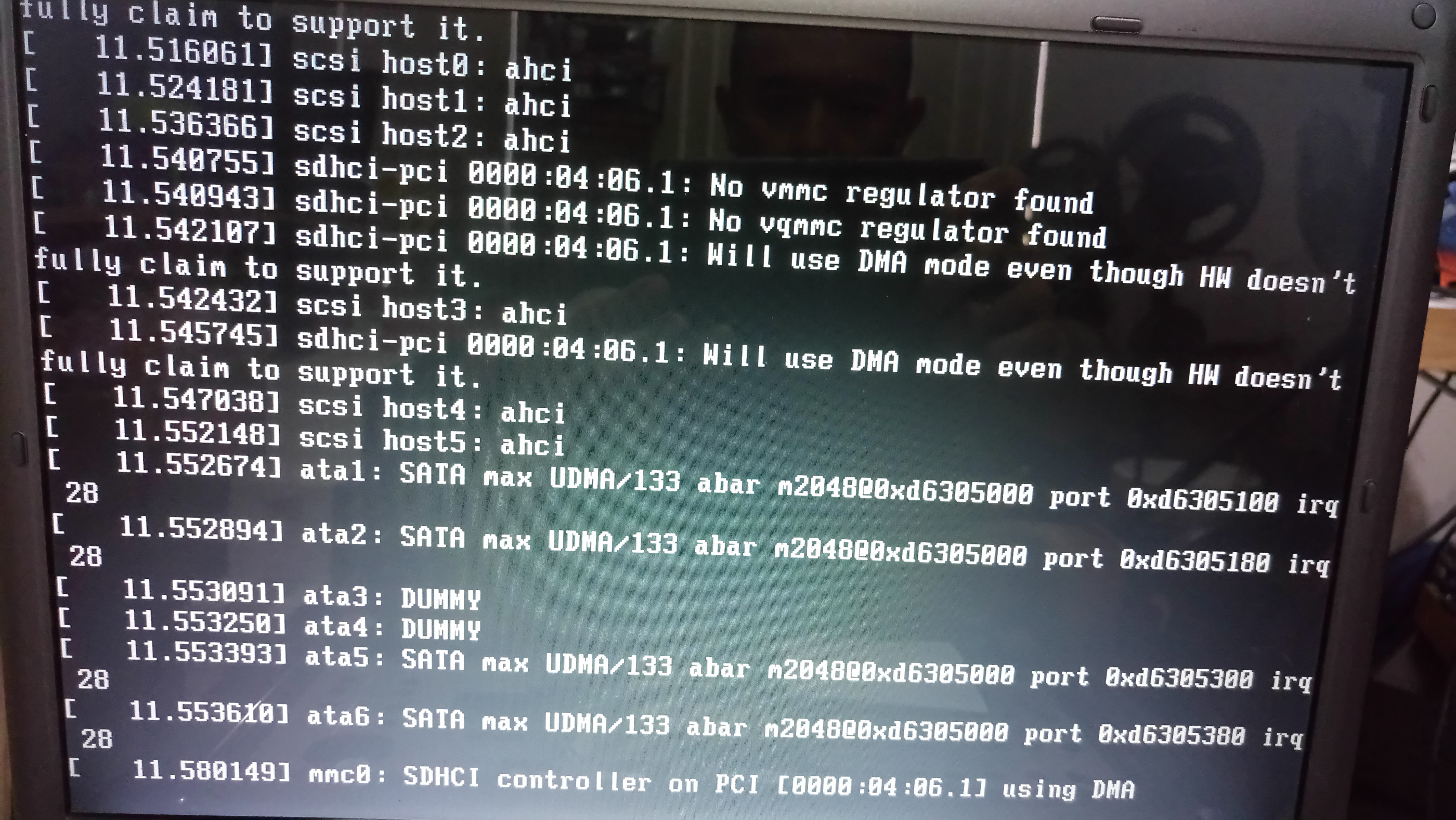

          Re: Toshiba A300 keep restarting ?
          That's the message and it's freezed on that point,
          What's wrong with it ?
            the problem seems to be related to a MMC card. If such a card is connected to the mainboard, remove it. then try again.
            does the laptop boot normally from the hard disk if you do not use a USB memory?
              I guess it's just randomly crashing and it happened that the SD controller was being initialized this time.
              Maybe the replacement caps for the NEC Tokin aren't good enough.
