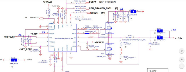

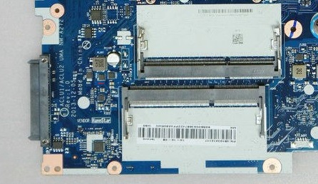

ACLU1/ACLU2 UMA NM-A272 REV 1.0 blinking led light
  • kalilinux25
    • Mar 2018
    • 2089
    • ZAMBOANGA SIBUGAY
    ACLU1/ACLU2 UMA NM-A272 REV 1.0 blinking led light
    When I test on the PU1207 chip the Pin 13 is shorted to ground
    and I dont have +1.3v and +3VALW
    When I plug the charger the led blinks and blink
    how can I find the short ?
  • khaahk
    • Dec 2013
    • 768
    • Estonia
    Re: ACLU1/ACLU2 UMA NM-A272 REV 1.0 blinking led light
    1. Sorry but the pictures are too small to be of any help
    2. Which led are you talking about (charger led, mainboard led, battery charge led?)
    3. 1.35V you get after power on for RAM, the controller that you are looking at has nothing to do with 3V and 5V. Look for PU904 (integrated SMPS with inbuilt transistors) which is generating 3V and PU905 for 5V respectively.
    • mielta
      • Apr 2015
      • 368
      Re: ACLU1/ACLU2 UMA NM-A272 REV 1.0 blinking led light
      Hi
      Open Jumper PJ316 + PJ317 and see witch side is shorted.
      Remove the ram to check if they are shorted
      • YasaCh
        Sony kdl 40p5500 red light keeps blinking 3 times
        by YasaCh
        Hello...
        my tv almost 2 years not powerd on and when i turned it on nothing happened and only 3 red light keeps blinking
        i opened the back cover no sign of damage on the powery suply or motherboard
        when i plug in the power i hear the reley sound like tik first and another tik..after that only red keep blinking..
        another thing is even after i unplugged the power, The tv keeps red blinking 3 times for 2 almost 2 munites
        07-07-2025, 11:53 AM
      • Fergal22
        Samsung UE40F5300AK blinking red light
        by Fergal22
        I have the above tv that just shows a red light blinking twice 5 times, i have taken the back off and all the capacitors seem ok,
        When i disconnect the mainboard from the PSU all the led's light up blinking fast but as soon as i reconnect the mainboard back to the power supply i get the red light blinking again twice 5 times,
        I have attached pictures of the Mainboard, PSU and a small video (zipped) showing what happens when i disconnect the lead from the psu
        Any help would be appreciated...
        02-02-2023, 09:19 AM
      • matty24
        Samsung UE50MU6172 - red light blinking
        by matty24
        Hello. I have problem with Samsung UE50MU6172.
        TV won't turn on, red standby light is blinking.
        Power supply BN44-00807A is fine. I replaced it with the new one.​
        Main board BN41-02568B (BN94-12530E)
        I've read a dump (W25Q40CL). Can someone check it od fix it for me?...
        03-02-2025, 08:57 AM
      • norbiszoke
        Samsung 50AU7172, only blinking red light
        by norbiszoke
        We have this set here in our shop that is not ginving sign of life besides red light that is blinking one time after pressing the button and nothing more... After detaching the mainboard from the PSU (this set has separate board thank god?! or not...) the backlight comes on. After reattaching nothing besides red light.... Can anyone from the forum help me here? Thank you in advance. Here's a link with images of the mainboard and the memory IC's that are on it.
        Regards, Norbert!...
        04-17-2024, 06:54 AM
      • huzo
        HP 470 G5 blinking amber light no power
        by huzo
        The board is daox8cmb6eo and i can't find no boardview or schematics on the forum or anywhere...
        So i plug in the charger, amber light starts blinking ,there is 3.3V and 5V present, and 2.4V on the power button,board doesn't turn on, no shorts...
        I've tried flashing the bios...
        interesting thing is the battery was around 7,8V, and it's 11.1V battery, the mosfet near the battery is open, but not charging,i desoldered it,tested it and it's fine ,but the amber light kept going on the charger so i charged the battery with power supply and got it to about 10.5V...
        06-08-2023, 04:08 PM
