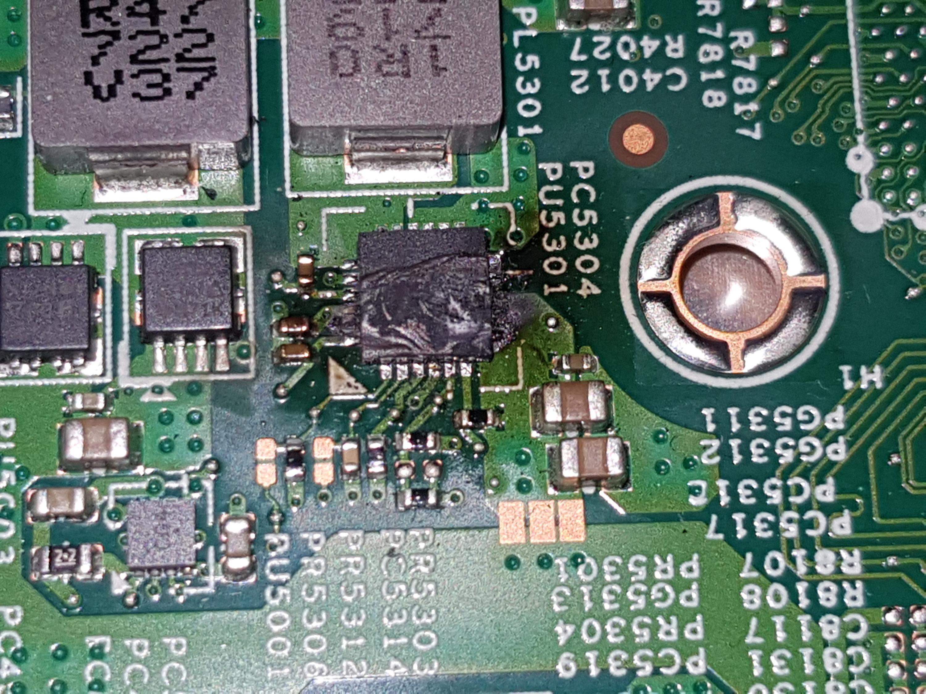

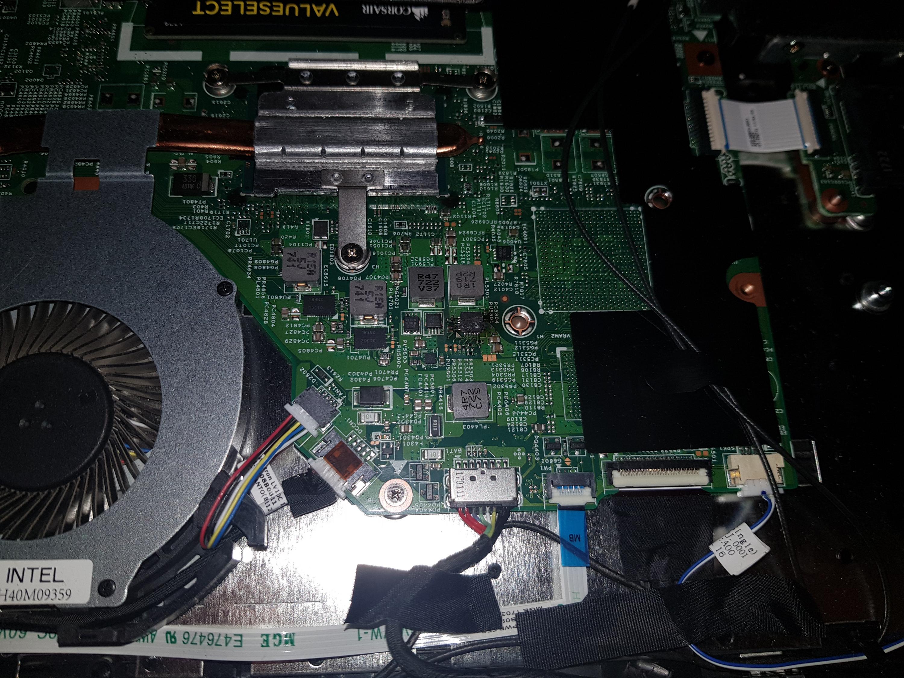

Lenovo v110-15isk please help identify burned component
  • barakuda666
    • Jan 2017
    • 23
    • englond
    Laptop lenovo v110-15isk
    Cpu i5 6200u
    MB: LV115SK MB 15277-1
    Please help identify burned component
    Pu5301

    Re: Lenovo v110-15isk please help identify burned component
    is there any schematics available for this laptop?
      As per vinafix, schematics not avlbl
        Aoz2262qia
