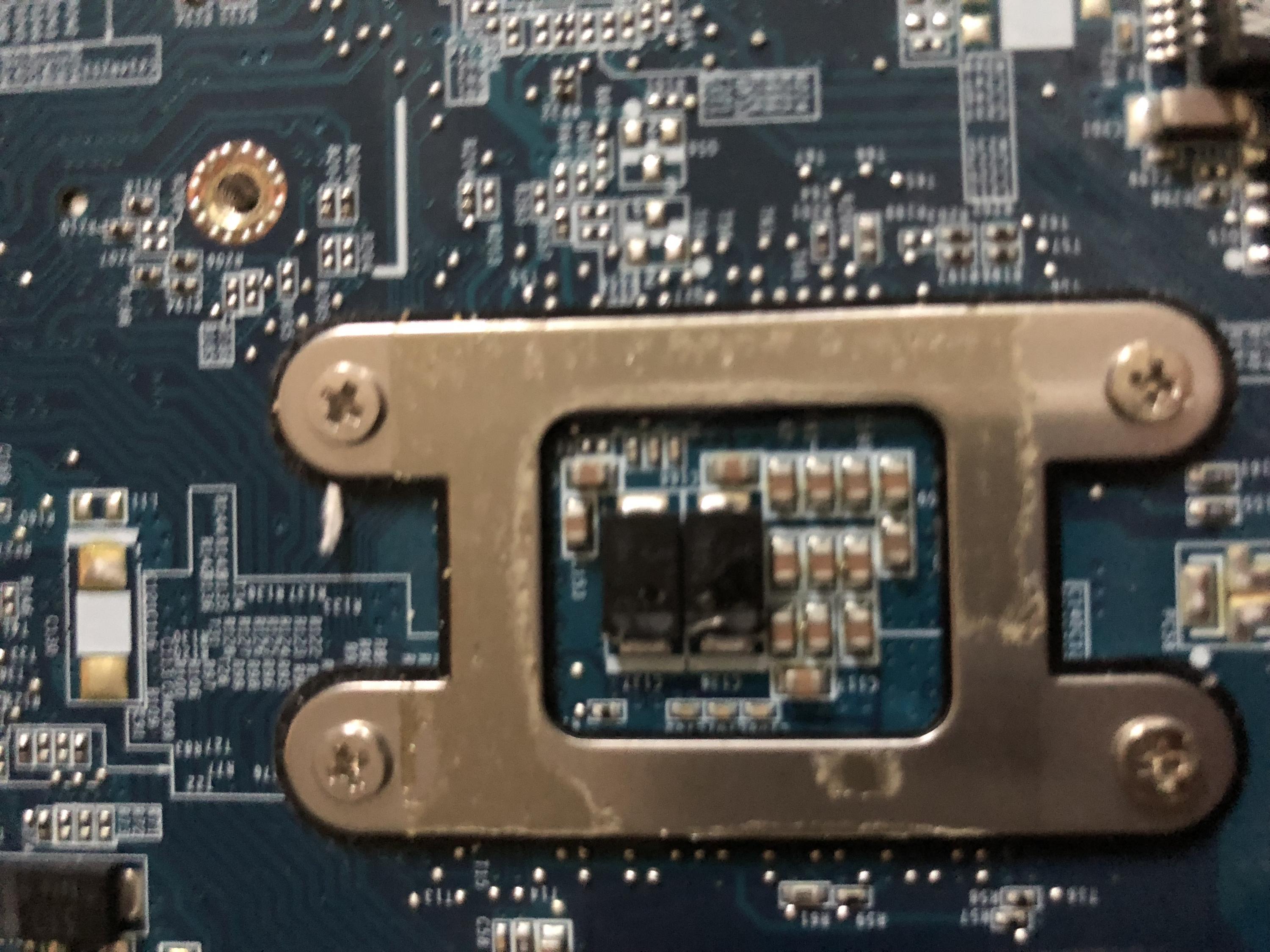

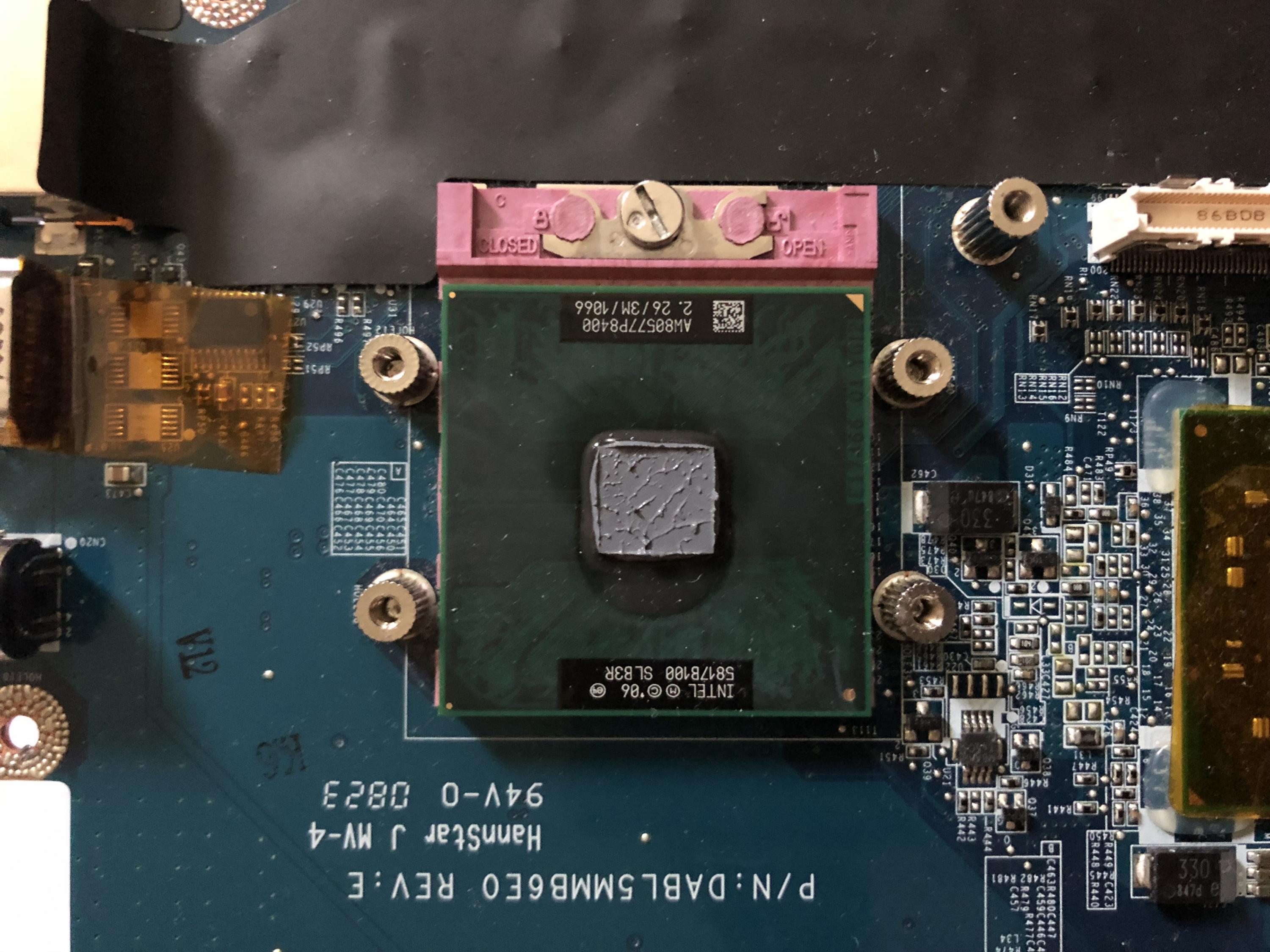

    I got this laptop Toshiba Satellite P300-156 DABL5MMB6E0 REV:E
    Symptoms stars up after reaching bios and some time's Windows loge shut downs.some one have repair it he have change the graphic card not in board apart with a used one I have attach the old bios need help

    Re: Toshiba Satellite P300-156 DABL5MMB6E0 REV:E
    does it have big cap under cpu? nec?
    if yes, replace it

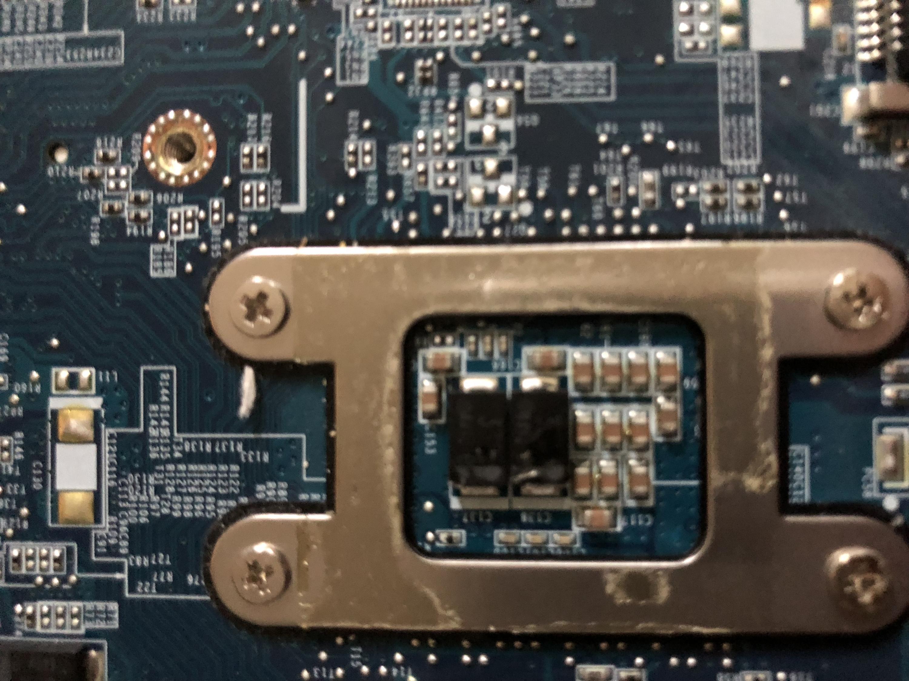

      ala_borbe
      i have uplode pic of the cap is this you are pointing about ?
        nope, that is different platform
                    I tested the bios from Bachir2004 / SMDflea but no luck MB start up no image but not shutting down like it used to do, any help Guys
                        Earlier tech have repair it he have change the graphic card not in board apart with a used one I don’t have the old one , any thing to do with ME Regina ?
