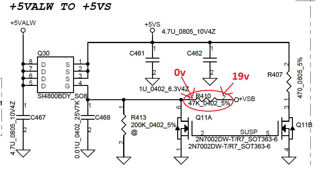

                +3valw and +5valw ok but No voltage on gate pin4 for mosfet Q30 (+5valw to +5vs)

                • dimah77
                  • Sep 2016
                  • 149
                  • ALGERIA
                  Re: Toshiba Satellite C660 Not Power On
                  If it can help :

                      Are you getting 5V vs on pin 1-2-3????? You didnt gave feedback on it. You only mentioned gate(pin4)
                      • dimah77
                        • Sep 2016
                        • 149
                        • ALGERIA
                        sorry, no voltage on gate and no voltage on source
                          Had the same problem, replaced q11a and fix the problem
