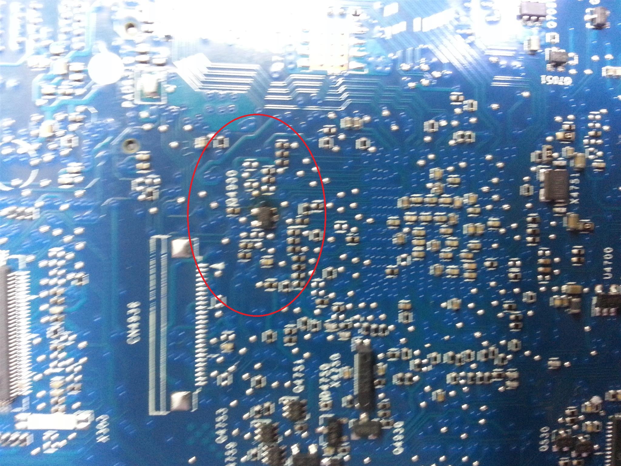

    hello Friend ihave laptop with no power
    i loock for a shematic :6050A2566301-MB-A04 15
    i found transistor ho is burned his number on matherboard is Q4900 end there's a short on his Pins

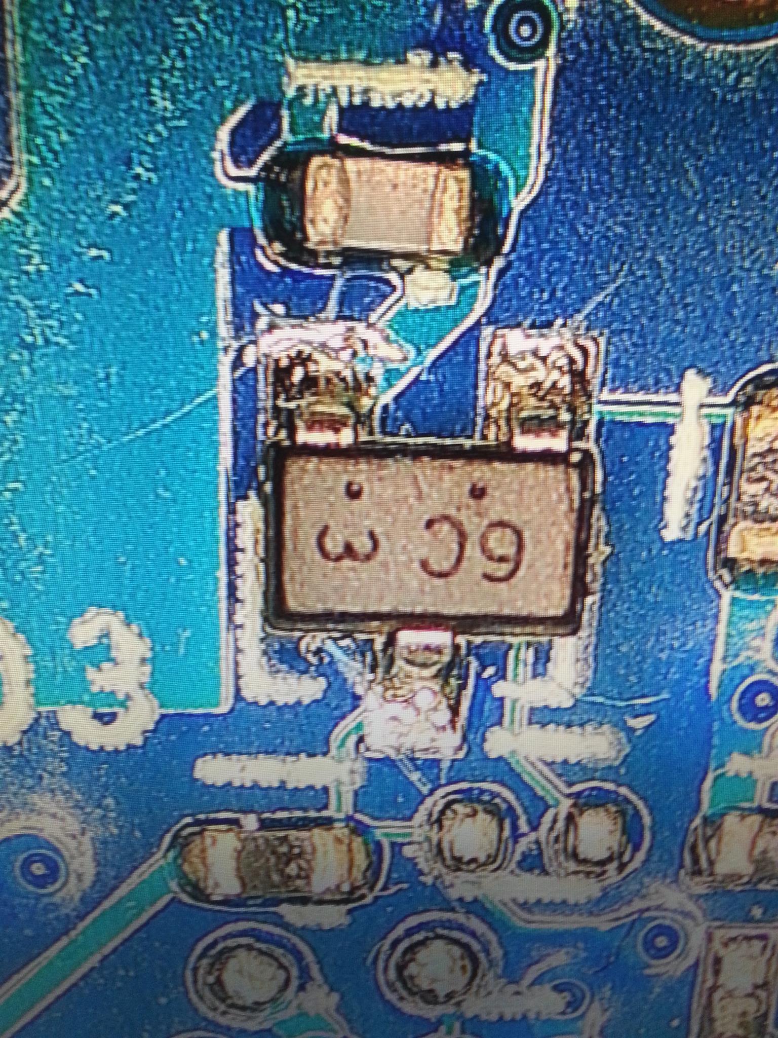

    Re: Probleme No Power on HP ProBook 650 G1
    The trasistor is like this
    writing on him 6c3 like picteur
      • 21853
      It could be a BC817 − 40LT1
              sir this transistor BC817 − 40LT1 are the same with my transistor
                • 21853
                I think its the right one.Read the datasheet.Page 1 , 6x = Device Code , x = A, B, or C .The DOT is lead-free
                6C, month 3 ,lead-free .(Note: Microdot may be in either location)
                *Date Code orientation and/or overbar may vary depending upon manufacturing location.
                The orientation means that the date code can be either vertical or horizontal .
                http://www.s-manuals.com/smd/6c

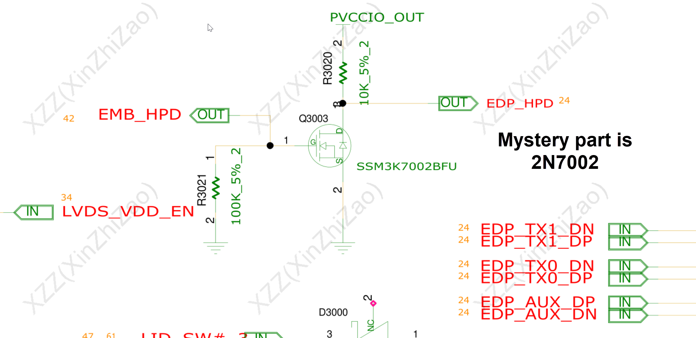

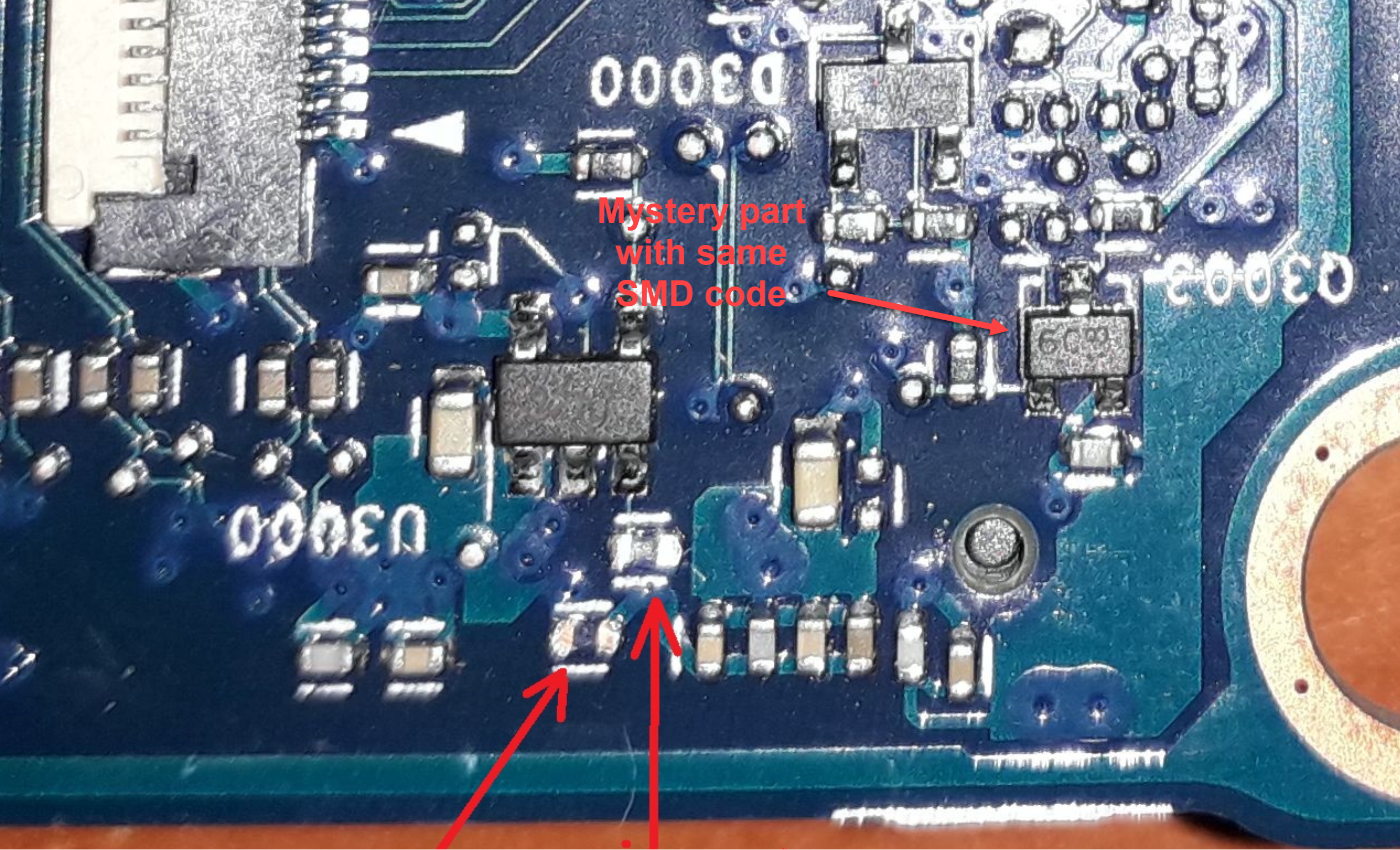

                                Follow this investigation:
                                1) go here:
                                ProBook 650-G1 płyta 6050A2566302-MB-A04- prośba o identyfikację elementów • Forum ELVIKOM
                                2) zoom in on the shared picture and you will see a close by SOT-23 device @ Q3003. Looks to be the same as the above mystery part. Would you agree?
                                3) For this logic board, found a schematic in my database.
                                Q3003 on the above HP board is a 2N7002 mosfet.
                                Click image for larger version  Name:	mystery_part.png Views:	0 Size:	296.9 KB ID:	3202358

                                  Originally posted by mon2
                                  Follow this investigation...
                                  Thank you for your search..
                                  In this case, even if it is a MOSFET, 2n7002 still cannot work like this. Of course, with my experience, because the voltage of 19 volts causes damage.
                                  In the same case, I replaced this part with a transistor and the ec-pch chips became defective!
                                  Because in this case, the gate pin must be connected to 19 without resistance and switch between pins 2 and 3.

                                        For safety, leave the 19v out of the equation. In the end, the mosfet is acting like a switch. Bridge the source & drain pins to force the 'switch to be closed'. Do not solder in a part at this location at all.
