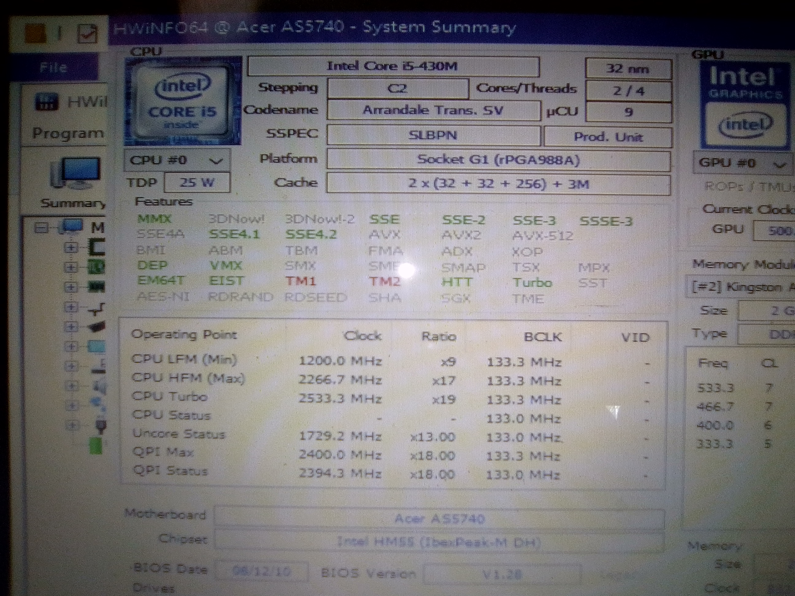

    Hi!
    have a Acer 5740 wich is shutting down when in full load.
    I check the temps and reach 100 degress in a matter of seconds,idle stays with 65-70.
    Now,the problem i found is that the fan is not working properly,starts for a few second then stop.
    Change thermal paste,clear the dust and reset EC.
    Obviously since the fan is not working the processor can"t handle the temps.
    Thinking update bios but i am afraid that it could shutting down in the process.(also the baterry is dead)
    Any ideea how to solve the problem?
    Thanks.

      Re: Acer 5740 fan spinning stops after short time
      hi and thanks for you response
      the laptop is shutting down or freeze when put load to processor,monitoring the temp guess is normal since they arrived at 95-100 degrees.
      now,the fan start spinning for 5 seconds when boot then is shutting down.
      today i observe that the thermal monitor of the cpu is disable and think that not allowed the motherboard to properly activate the fan status.
      searching for ways to enable it since the bios does not have such option.
      my guess is i am dealing with a bad processor or motherboard.
      reflash bios could help but as i said ,afraid not to have the notebook shutdown during te process. notice that the processor power is spec with 25w( HWMONITOR) wich is wrong since is an 35w processor.
      Also found this page: https://www.hwinfo.com/forum/Thread-...-How-to-enable ,wich expose the same problem.
                well,i could say i solve the problem
                First, i was take the risk and flash a mod bios wich has thermal configuracion and many other advanced options enabled.Ventilating the motherboard with a plastic cover it was a succesful flashing despite my fear.
                After that the fan had moments when kick on but it was behaving erraticaly.
                Then i install notebook fan control with an acer 5738g config. file and that gives me total control of the fan since the bios is not properly control the fan.
                I lost my programmer(thinking by a new one)otherwise this BIOS and EC dumps could be very useful.
                Thank you all for your advise and your help.
