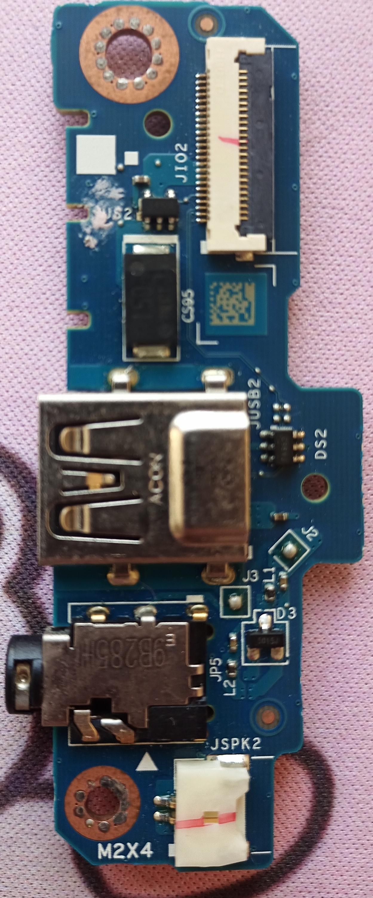

    Does the logic board/laptop power up at all after this event?
    The damaged component is likely a USB load switch that fuels the vbus power rail to the local USB connector. It is possible that this damaged USB load switch is halting the boot up process. Respectively, you will need some soldering tools to remove and replace this damaged part. At the very least a multimeter is required to take same measurements of the damaged region of the board.

      Re: Acer Nitro 5 An517-51 mainboard short circuit - Boomer needs help
      Hi. Thanks for your answer.
      After waiting some time I tried booting it again. It booted for a few seconds and got super hot at that port again. It was the board on the small side-mainboard. Since then never ever again.
      Any ideas on which other mainboard might be ok to use?
      • mon2
        • Dec 2019
        • 14183

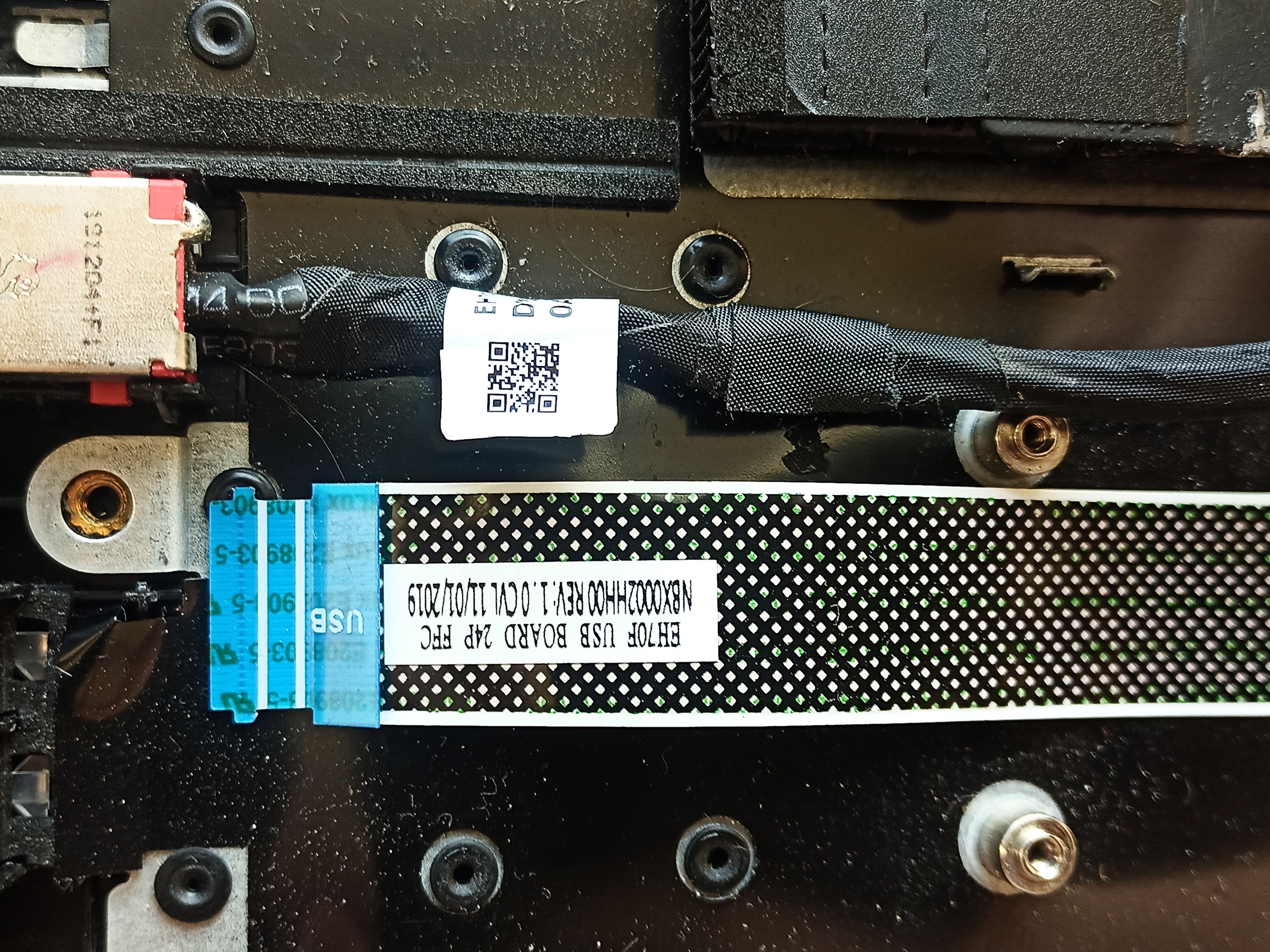

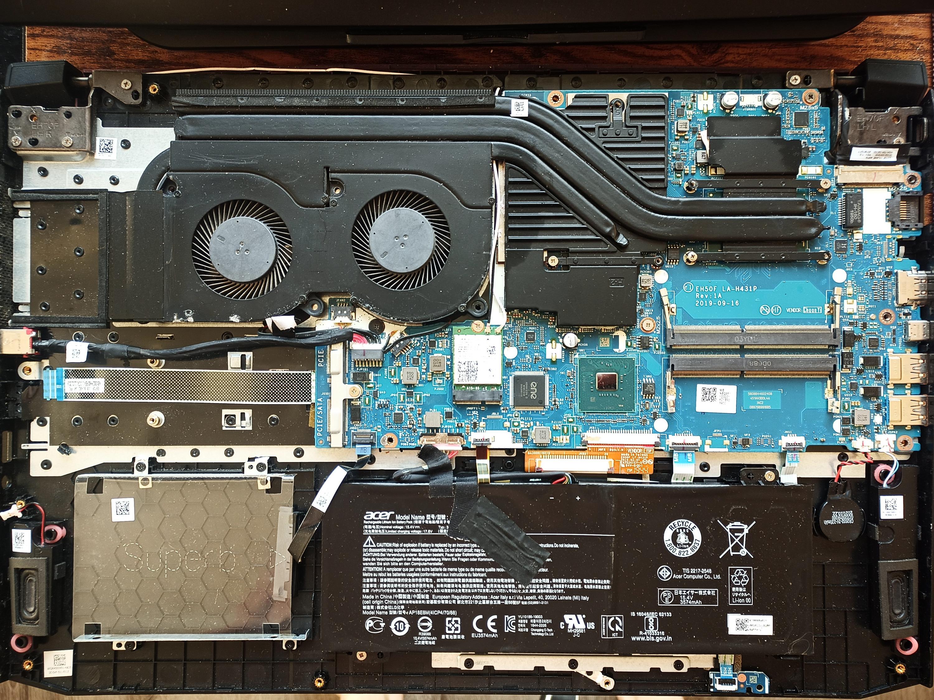

        Is the area that was getting hot a removable daughter board?
        Post pics of this board and USB daughter board.
        If possible, disconnect this daughter board. If not clear on how to disconnect, wait for additional advice.
        • 2Stupid4U
          • Aug 2023
          • 6
          • Northeurope

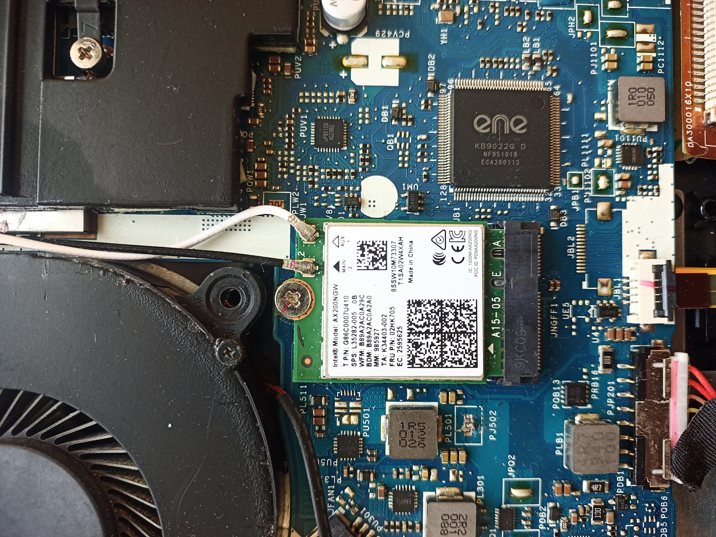

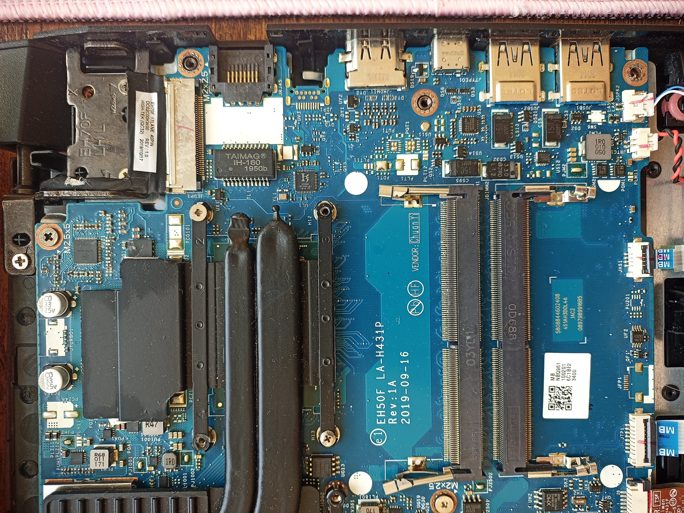

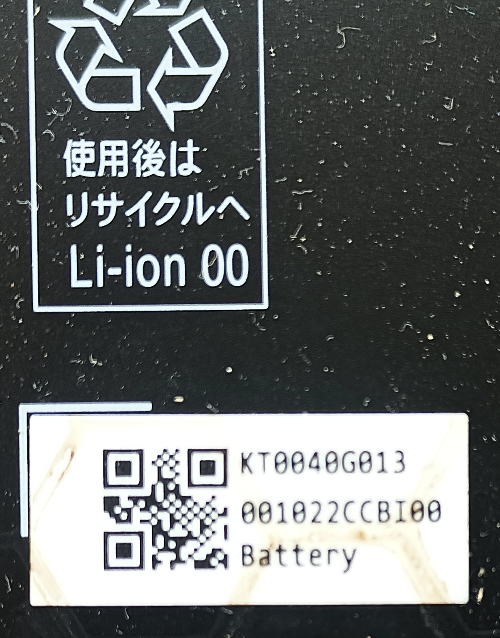

          Hi. Thanks for your help so far.
          New pictures attached since I cannot edit my initial post.
          As far as I remember it was the small motherboard that got super hot when the circuit happened. I am not 100% certain on this.
          I tried booting with and without the small board. With and without the battery. Combinations as well. Tried booting with only battery, only charger and both.
          No reaction at all. No lights flashing.
          When connecting the charger the adapter on the board gets a little bit warm so I guess it is charging.
