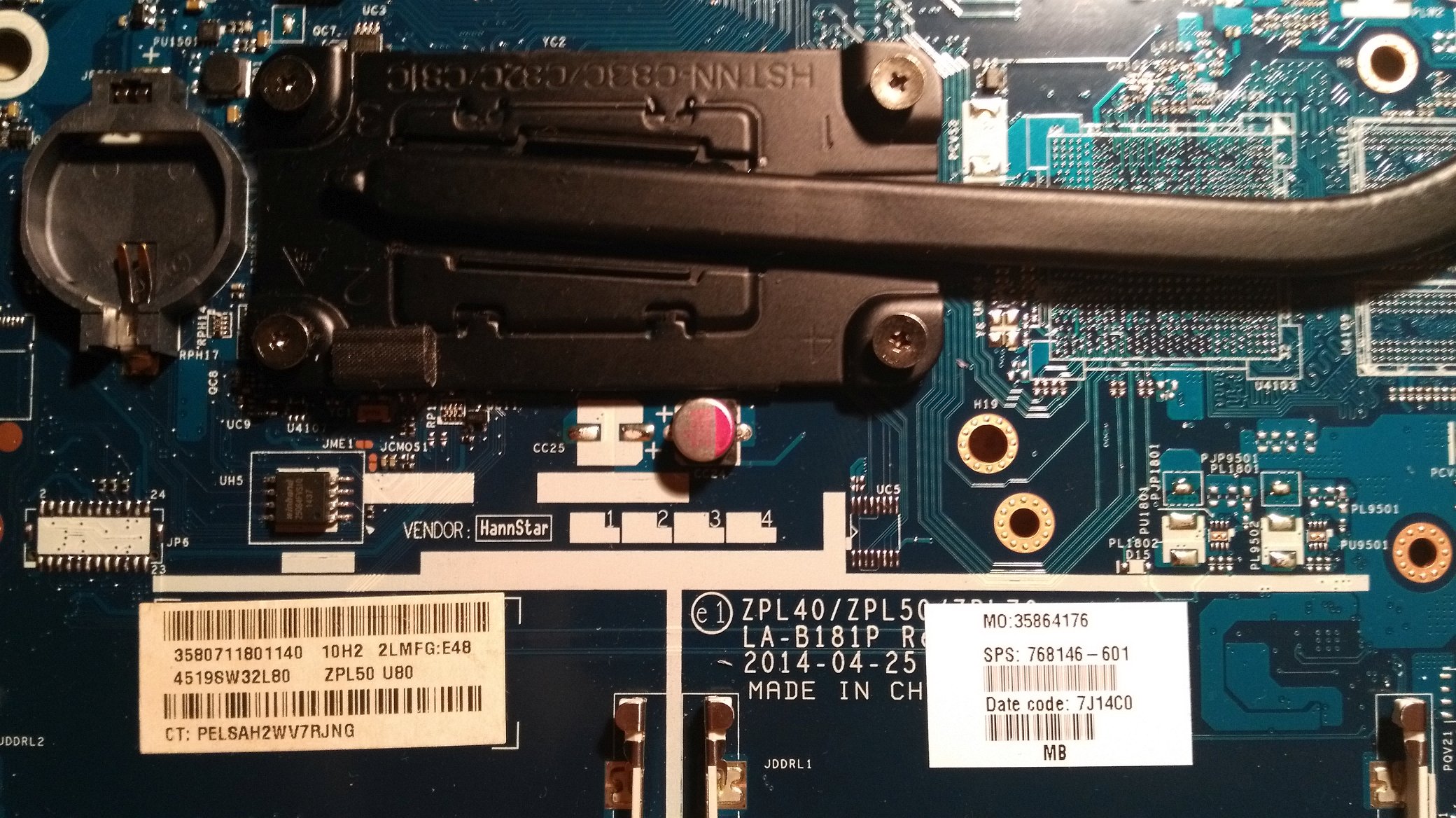

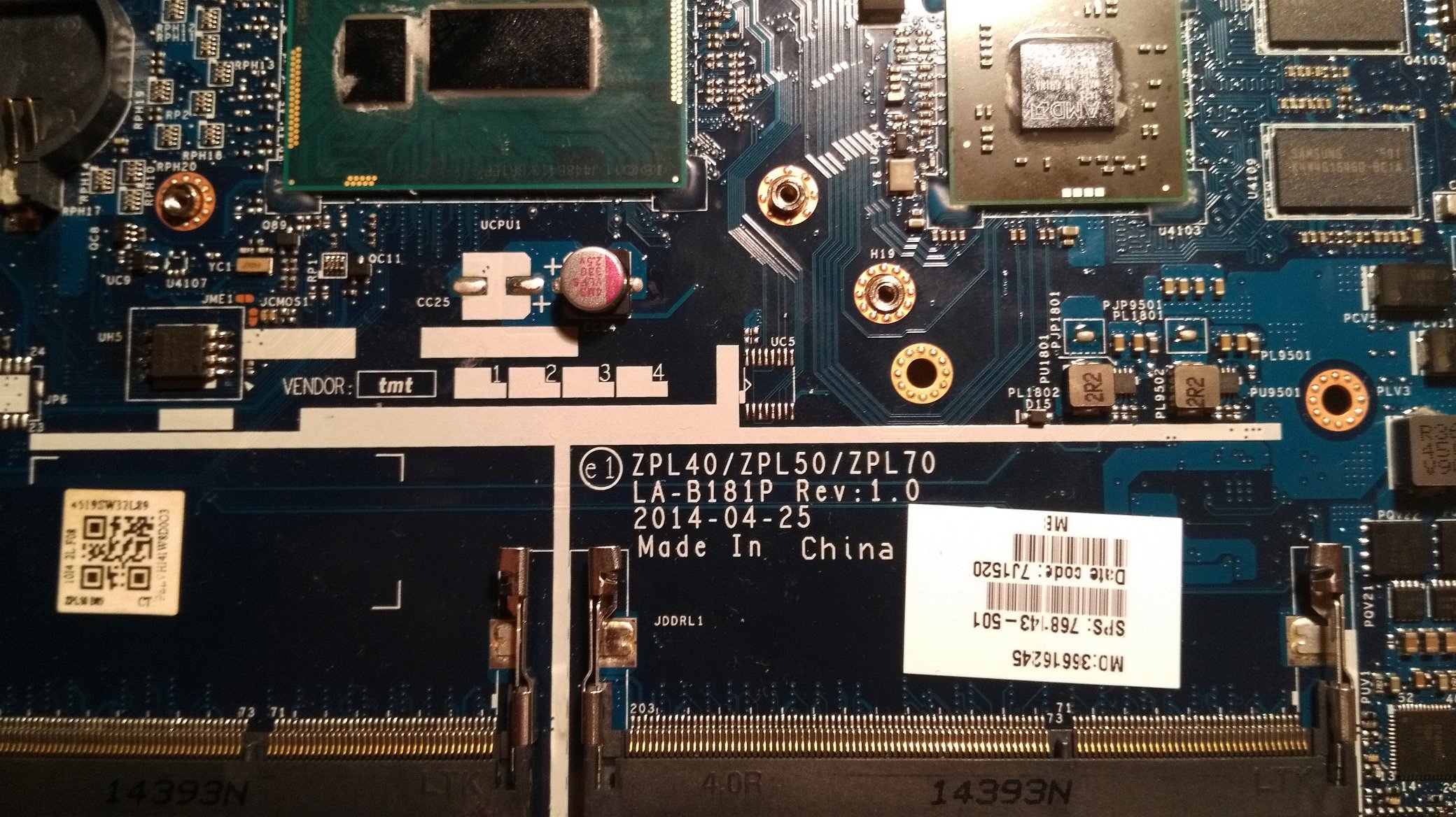

    I bought this one just for DC-jack cable that I needed in this case:
    https://www.badcaps.net/forum/showth...067#post846067
    Laptop I bought is without ATI graphics chip on board. Just Intel i5.
    Laptop is going into loop when power plugged on, regardless of power button but when turned off by holding pwr btn, don't try to start over autimatically - untill pressing button or reconnecting power. Same scenario is when battery is connected. When laptop is turned off by pressing power button, it charge battery without problem and signaling right abuot that. I charged 2 batteries without any problem or unwanted laptop turning-on and loop.
    When plugged on, or when power on by button, in about 10 seconds it firstly supply all voltages, start short fan burst and than faint image show on the screen but without any backlight , not even momentarely, regardless of screen position. Than loop became shorter and every 2-3 seconds whole process repeat. Nothing is overheating.
    I mesured values only on big coils and results are:
    PL303 - 3V; PL302 - 5V; PLM2 - 1.34V; PLZ2 - 1.7V; PLH2 - 2.5V;
    PL1501 - 1.47V.
    When measuring, screen was detached, nothing was connected except RAM, power, fan and power button.
    Before dissasembling, with everything attached, laptop was in the same loop.
    Any ideas? For both cases
    If needed, I can upload schematics.
    TY

      I didn't convert anything but bought laptop "as-is" in hope that has same mobo version and, of course dc cable. Unfortunatelly, I can't see picture now because under any kind of light I use it is not visible. At the daylight, I think I saw white circle with red X inside in the middle of screen, somewhere. Both mobo's are on pictures.

          No, those are 2 entirelly different boards, from 2 different laptops. I didn't touch anything and not replaced or modified anything. Board with ATI chip show only ALW voltages and doesn't turn on any other power lines (as explained on other thread, link is on first post). On other one without ATI, startup-loop is present with faint image and no backlight. I'll try to see if anything is visible on screeen.
