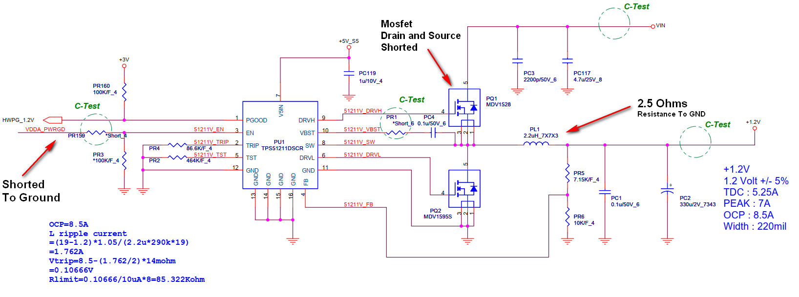

    Repairing An Acer Board ZRI
    Problem : When Press power turn on light then off
    Culprit : Shorted VDDA_PWRGD line and solved by removing the PU1 and the unit power but no 1.2v
    Tried to replace the damaged part but when plugging the charger, amp goes to 3amp shorted board caused of the HI side mosfet shorted, I replaced it and same thing happen to the mosfet

    Re: Acer v5-552 zri
    PU1 damaged

      Re: Acer v5-552 zri
      PU1 is Newly replaced, Problem solved but I dont know the real reason. After I replace new mosfet, It is not get short but the problem of the unit came back, When Power On it shut off if this circuit for 1.2v supply is in the circuit
