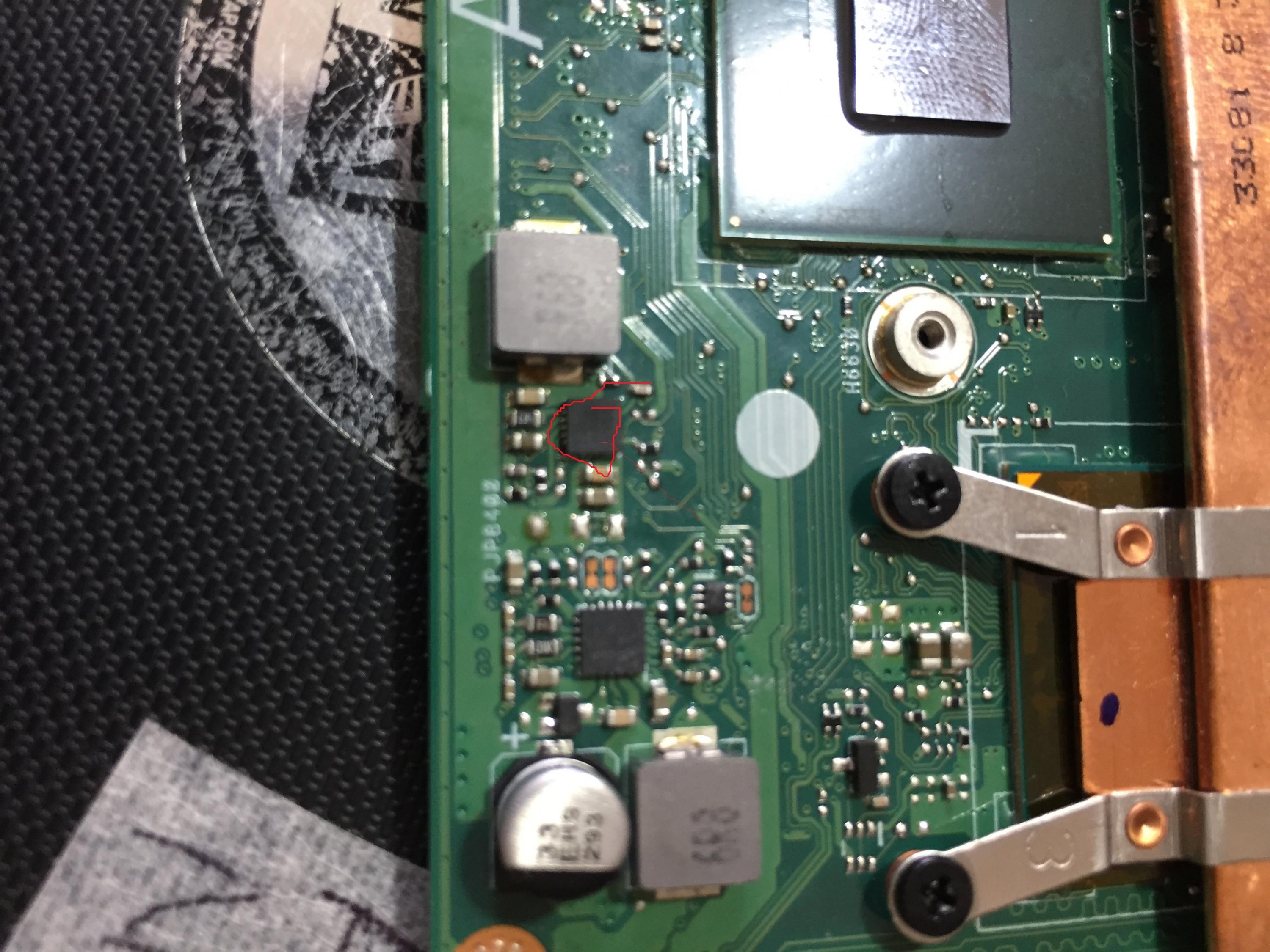

    I need help to identify this shorted chip on asus x200ca it has a mark AESD 552 i have attached the image of the board, can anyone help me identify this chip please

    Monolithic Power Systems NB671LGQ

      thanks piernov for the response i need to find the same chip for this

        Re: asus x200ca need to identify this chip
        https://www.aliexpress.com/item/5pcs...ceBeautifyAB=0
