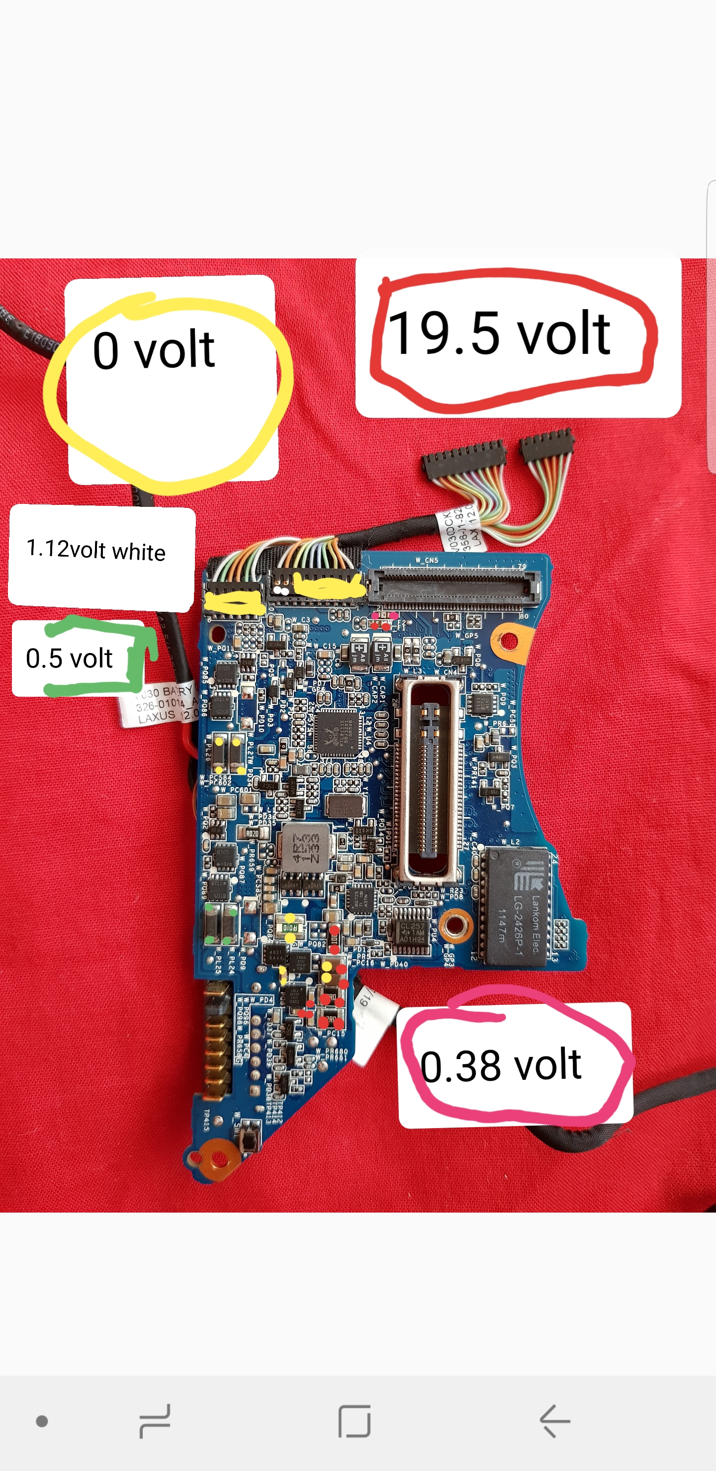

    Hi to all (sorry for my bad englisch i speak italian) my problem ist that i have no power and no chrging battery on my sony vaio vpc sa4w9e it see like the cnx 458 dont give out 19 v fuses are okay please help

                    Re: Cnx 458 problem on sony vaio
                    So i have meauserd w_pq81 and w_pq82 and at w_pq82 at all 6 pin 0 v. at w_pq81 at pin 8 i have got 0.8 volt changing then 0 at pin 7,6,5 0.3 volt
                      W_PQ81 and W_PQ82 have no accessible pins. I think you did not measure them properly.
                      unfortunately, W_PC22 and W_PC19 and W_PC10 are not labeled on the board.
                          they are connected to W_PC19 which is not labeled. Now, you should measure 19v on at least one pin of W_PQ81. then, make sure you measured the other pins of W_PQ81 and W_PQ82 correctly.

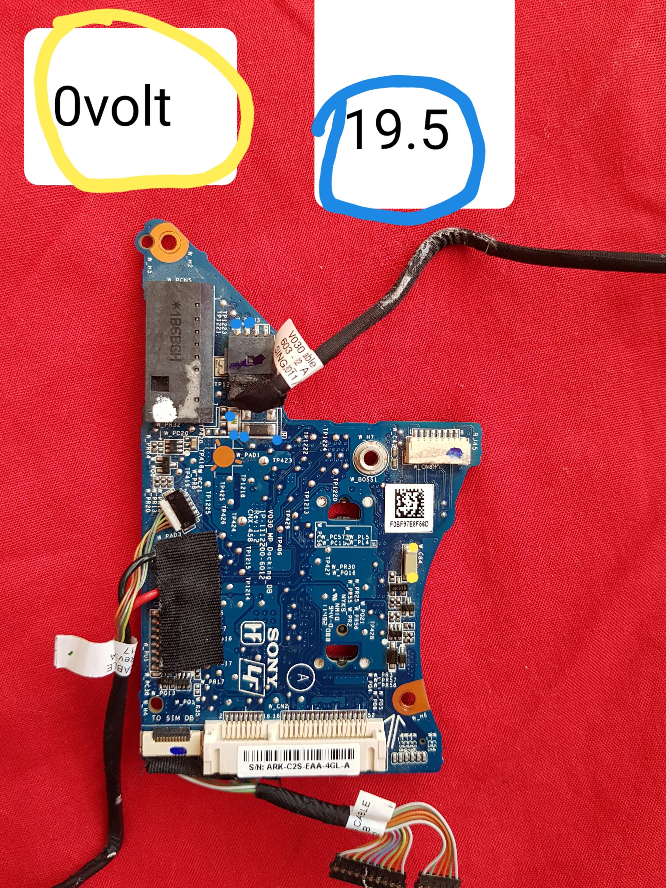

                            So definetely DC_IN_MOS are 0 volt i sourced at all the point but still everywere 0
                                    So i think the problem is at w_pu2 BQ24725 beacause on pin 1 to 3 i have 0 volt but i should have 19v can be this the problem ?
                                      And at w_pq81 pin number 3 on the schematic i v got 19 volt
                                        it can be w_pu2, but w_pq81 seems a more probable suspect. have you got another mosfet of the same model of w_pq81?
