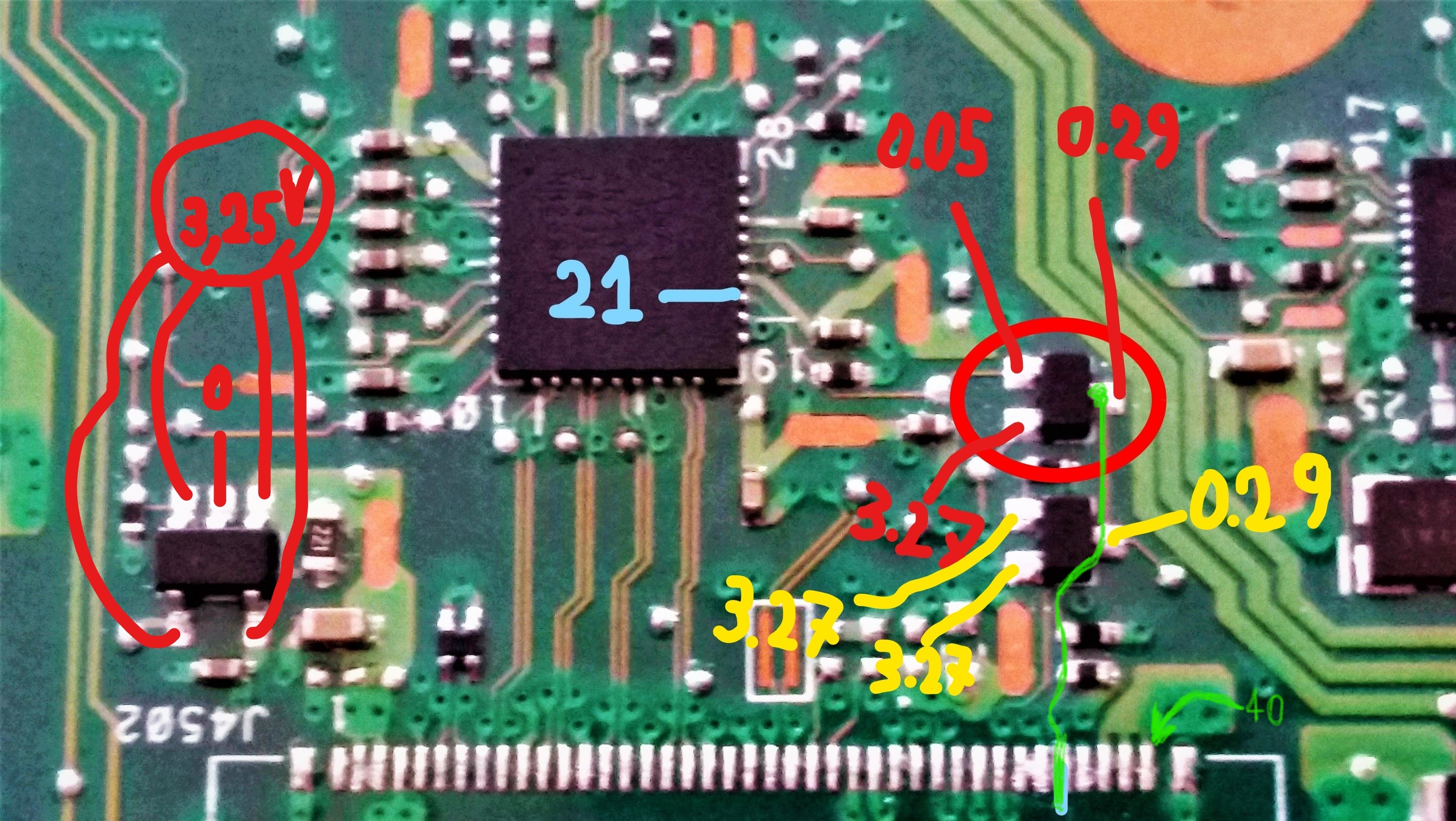

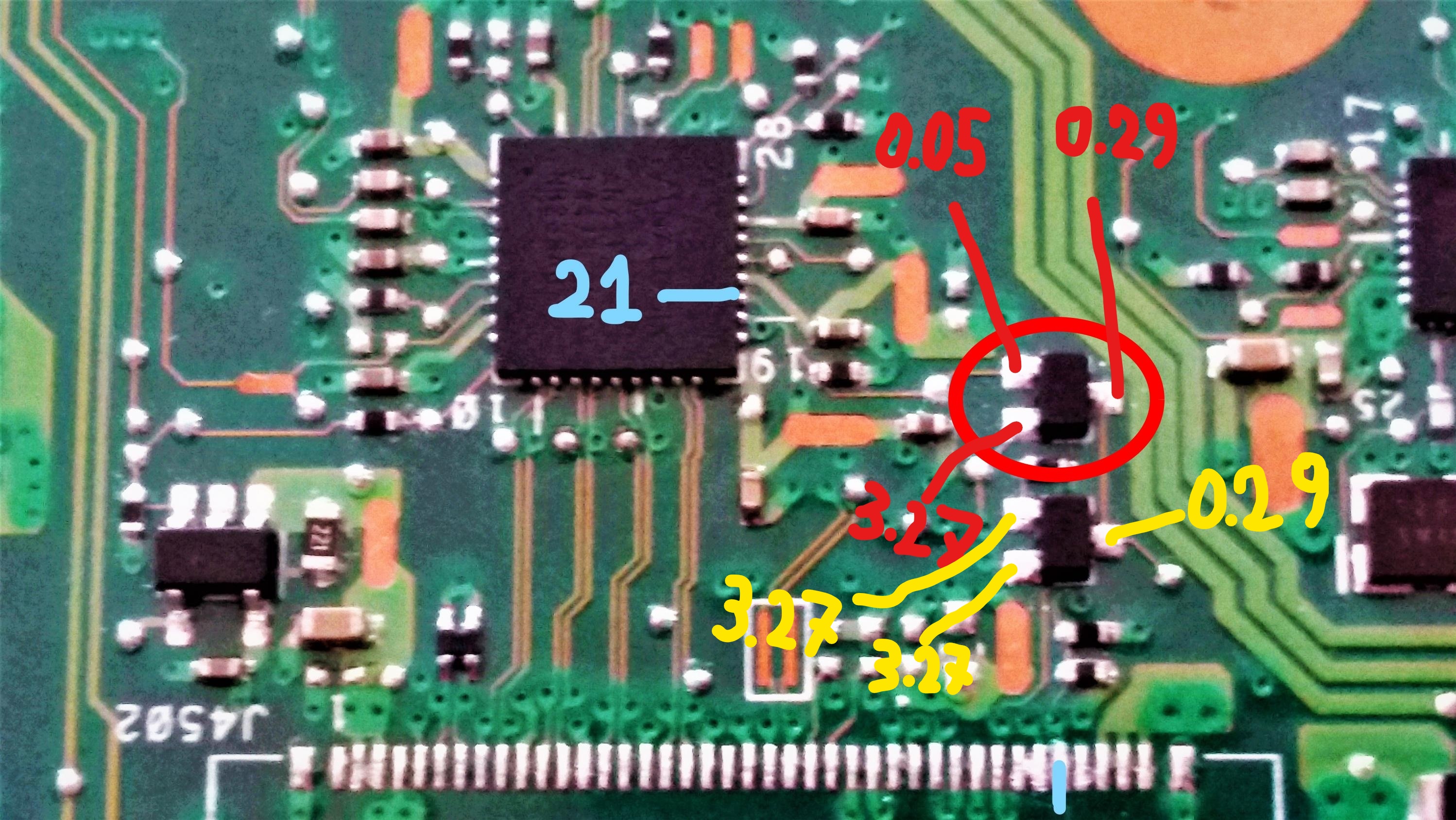

    Thi is the voltage detected on the pin on SCHOTTKY BAT54AW (UP)
    The SCHOTTKY BAT54AW (BELOW).

      What's the voltage on all pins of this power switch?
      Do you have image on the LCD?

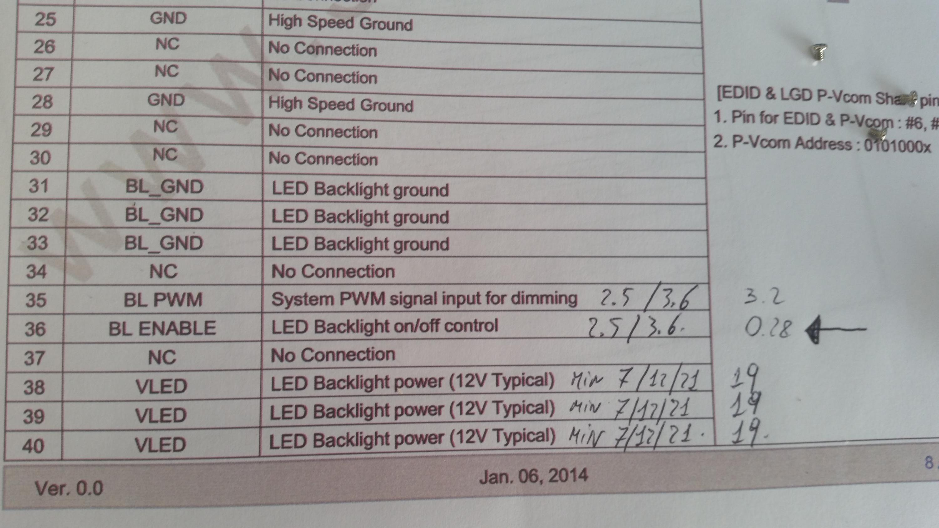

        I have the image on the LCD but no backlight because the pin 36 (INTERFACE CONNECTION MODULE PIN CONFIGURATION - CONNECTOR LVDS) don't have the sufficient voltage

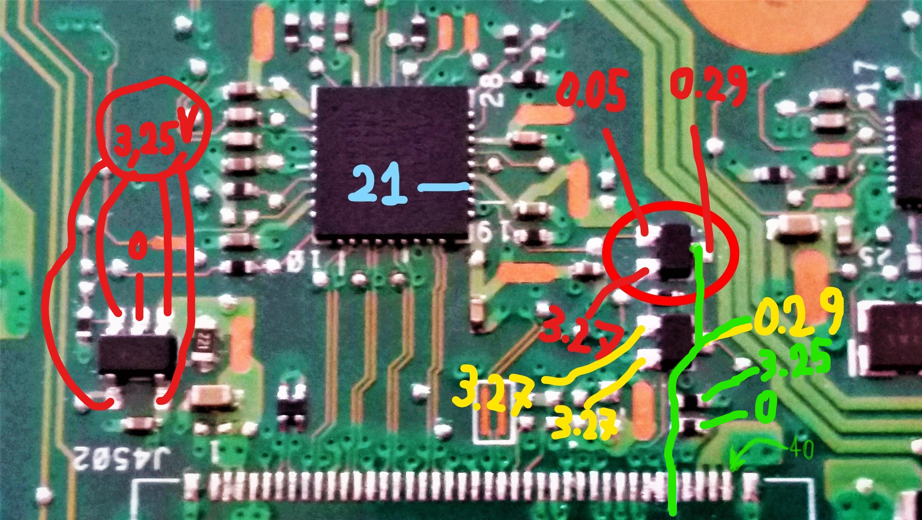

          Re: Asus x555ld rev 3.1
          This is a new picture.
          Have you a Asus X555ld rev3.1 boardview schematic ?
            Boardview available here: https://www.badcaps.net/forum/showpo...43&postcount=5
            Check voltage on both pins of the resistor, check resistance to ground of pin 2 of the resistor, check resistance across pin 1 and 2 of the resistor.

                This is a new picture. The green line should be 3v (on the scheme numeric, pin 36 BL ENABLE), instead it is 0.29v.
                      See up the new picture with control voltage, resistance to ground of pin 2 of the resistor and resistance across pin 1 and 2 of the resistor.

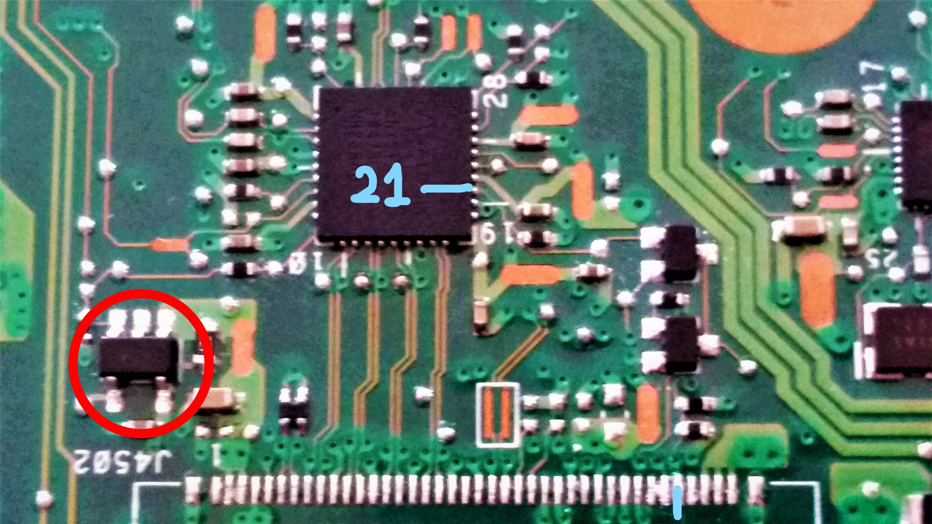

                                #35
                                Picture of Analogix 1121
                                Replace it. It always break down. But test LCD panel on another laptop. When this Dport->LVDS decoder breaks down in many times it destroy every LCD that is connected to it. it cost few bucks
