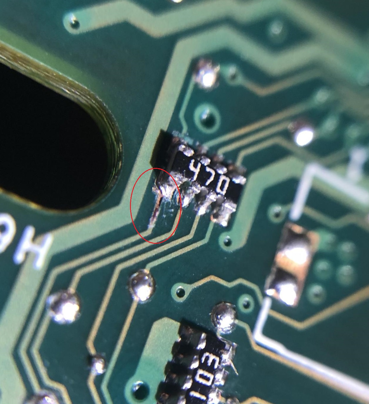

    Asus x555ld rev 3.1
    i have this motherboard with All voltage
    power LED and charger led lighting and fan rotating
    all things ist ok but dont have screen
    i programmed two time Bios chip but nothings( i attached two file and original bios)
    CPU i7 4510U
    Geforce 820M
    any idea ?

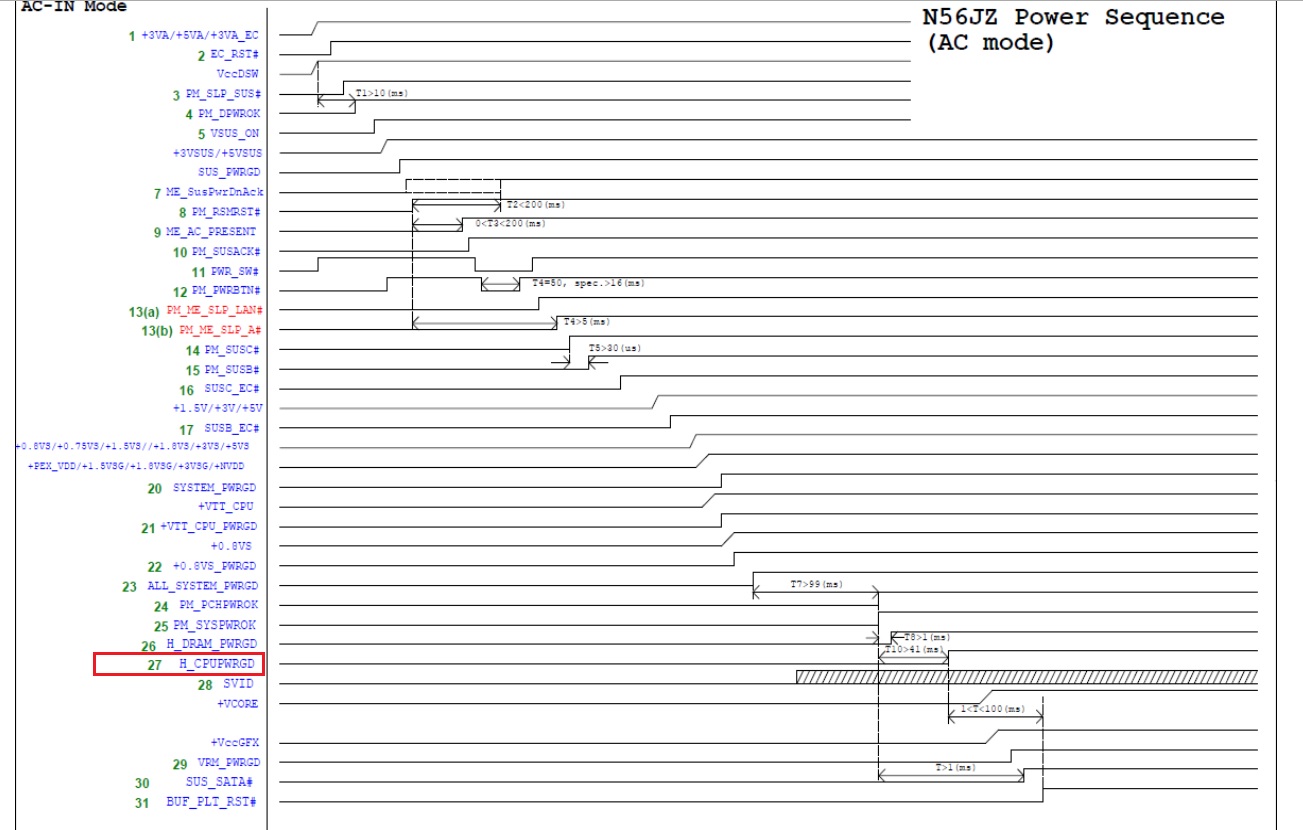

            Today i changed four jumber in this video and again not happen
            https://www.youtube.com/watch?v=CAfV43L0tco
            i tested many version bios and tested without onboard ram
            unsuccessful
            EDIT: maybe this video not good for REV 3.1
            i checked "H_CPUPWRGD" signal and ist ok .

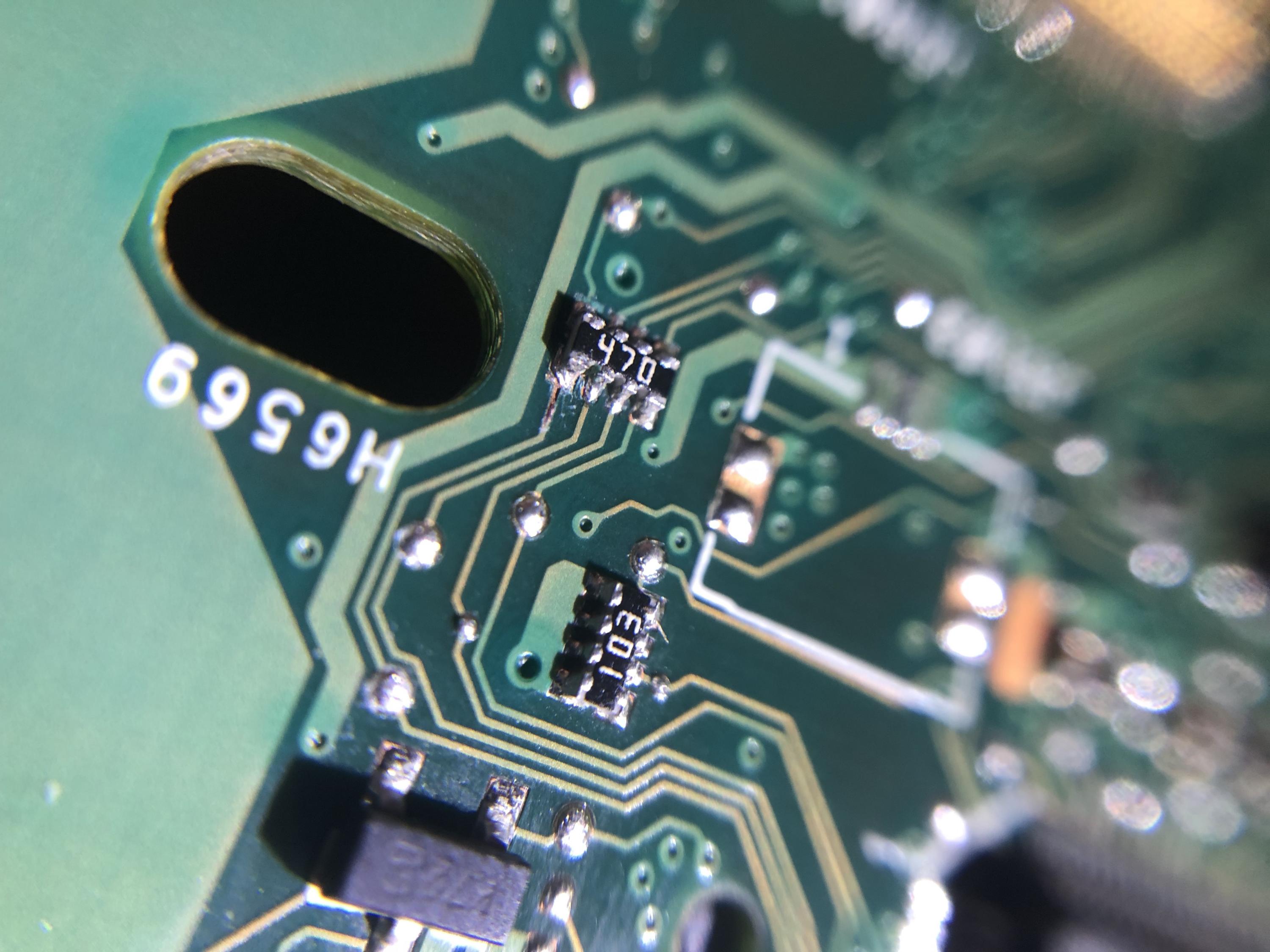

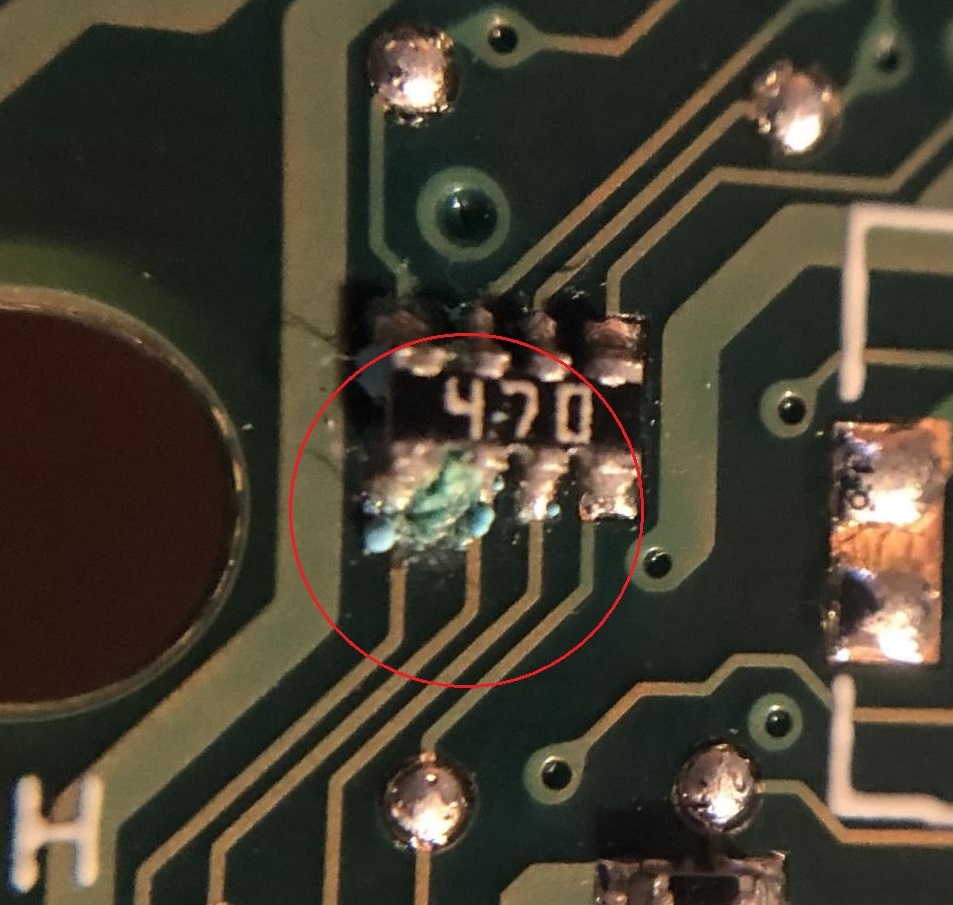

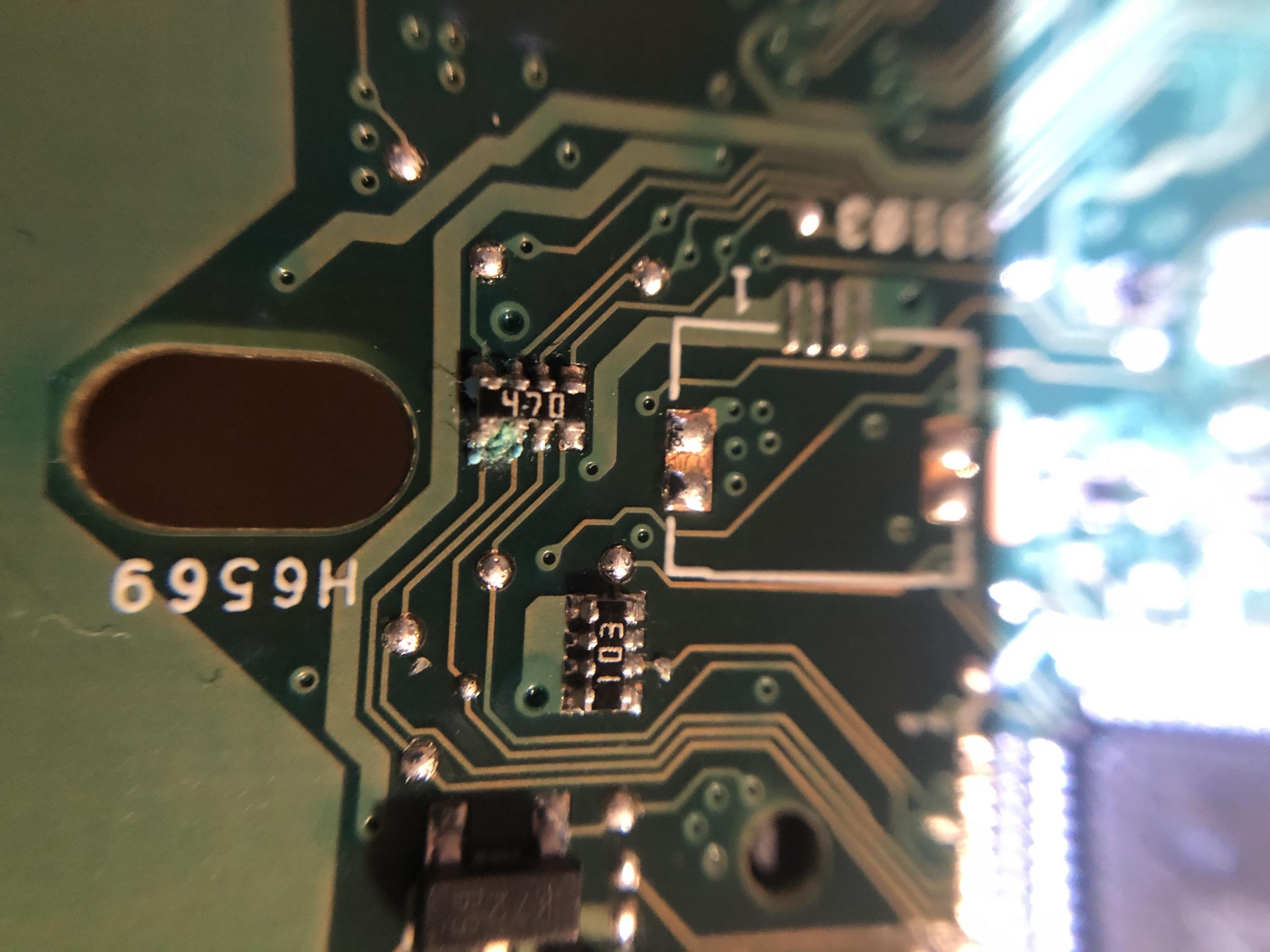

                          • tibimakai
                            • Jan 2012
                            • 3680
                            Re: Asus x555ld rev 3.1
                            What exactly you have done?
                            I don't understand from those pictures.
                            • kokono
                              • Jun 2018
                              • 203
                              I had an oxidation and eventually a signal breakdown
                              • tibimakai
                                • Jan 2012
                                • 3680
                                Aha, it was a simple fix, but hard to find. Maybe I should look over my board as well.
                                Congrats!!

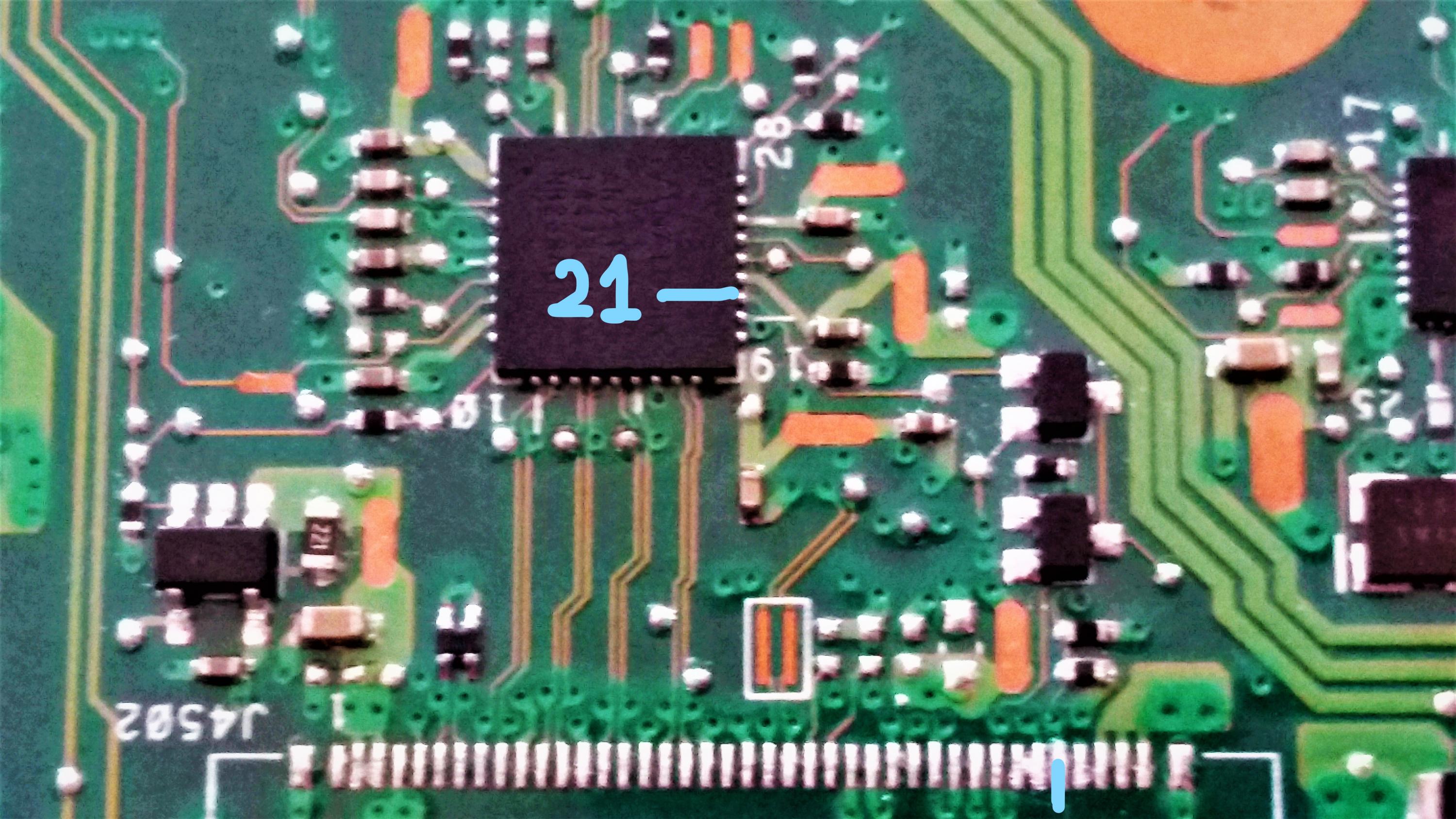

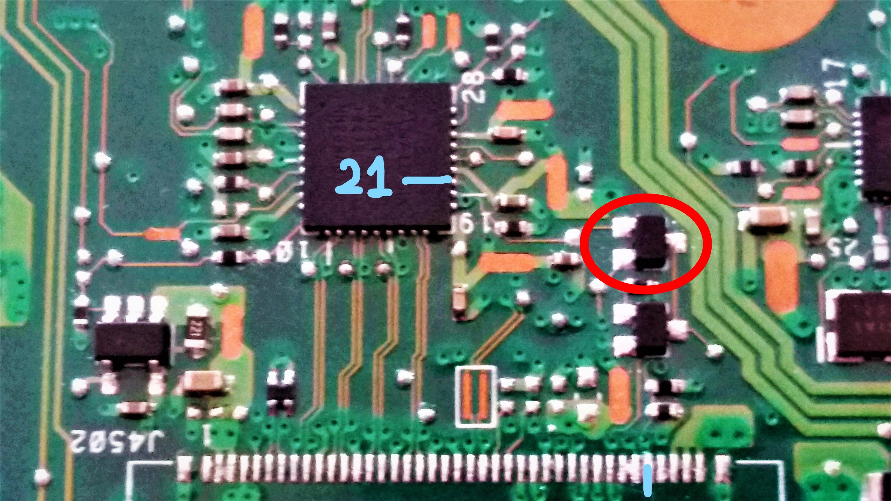

                                    Hi, i have a problem with Asus x555ld ver. 3.1
                                    The tension of 3V Backlight panel on/off in the pin 21 of Analogix ANX1121 is down.
                                    Help please
                                    • Raziel
                                      • Jul 2018
                                      • 11
                                      • Italia
                                      Picture of Analogix 1121
                                      • piernov
                                        • Jan 2016
                                        • 4439
                                        • France
                                        What's the voltage on all pins of this diode?
