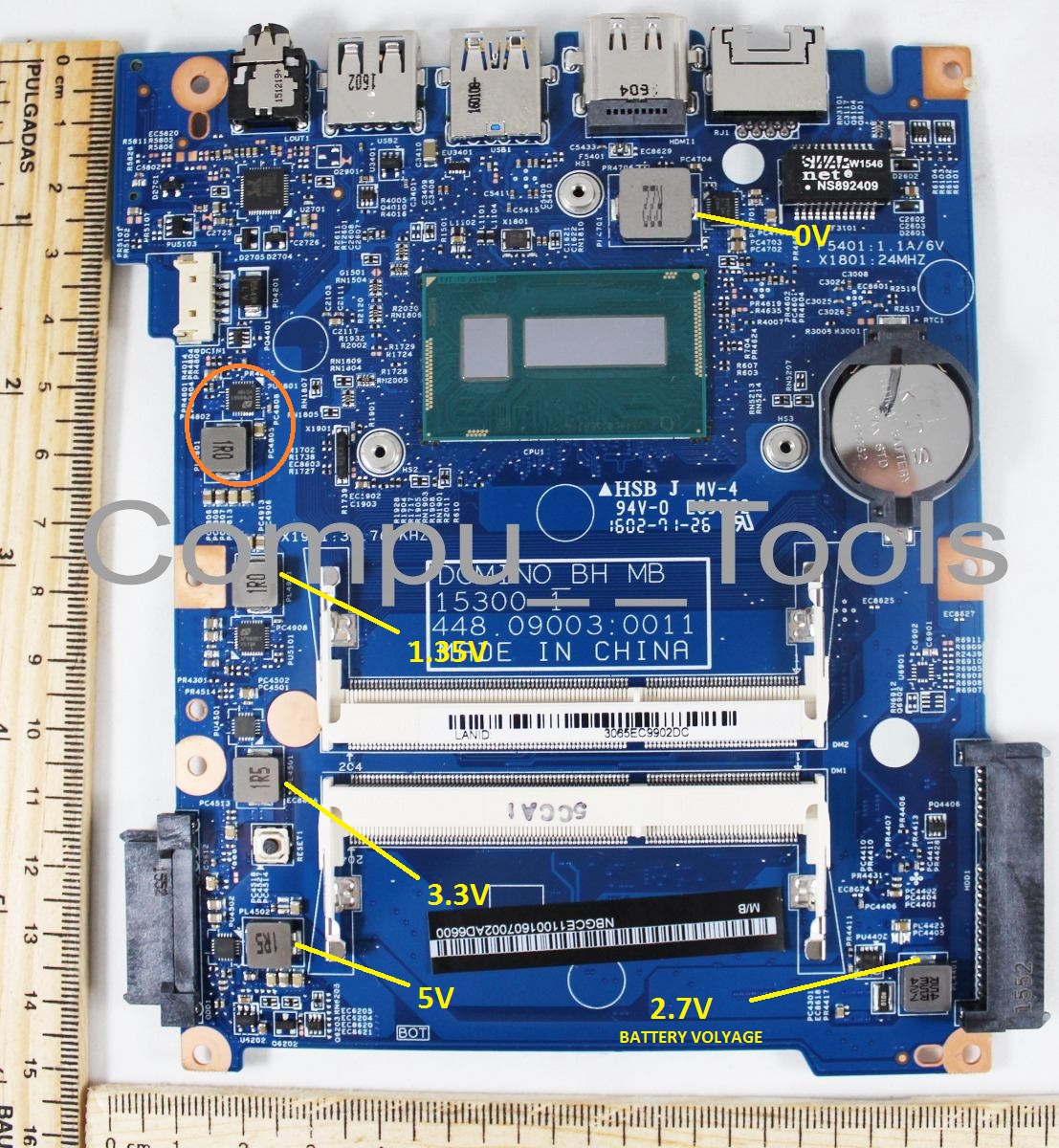

    I have laptop acer es1-571 with board: DOMINO_BH
    When i puch power button just blink once and off
    voltage present 19V
    Voltage missing 3.3v and 5v
    i don't find a schematic for this Board
    ic charge: BQ737
    IC FOR 3VALW: SY8286CRAC_QFN20
    IC OFR 5VALW: SY8286CRAC_QFN20
    Nb:
    - Find Water damage in RTC BATTERY
    - When i pull up coil of 5VALW (3.3V is present) there is no short in all Coil
    Please Help Me

    Finly i found the problem and the mothrboard turn on
    I REMOVED COIL wich is selected with orange color
    i went to know Ic (APW8861) Jobe because i have't Schematic for this board

              check for short on vin rail. u have probably some shorted capacitor on it
