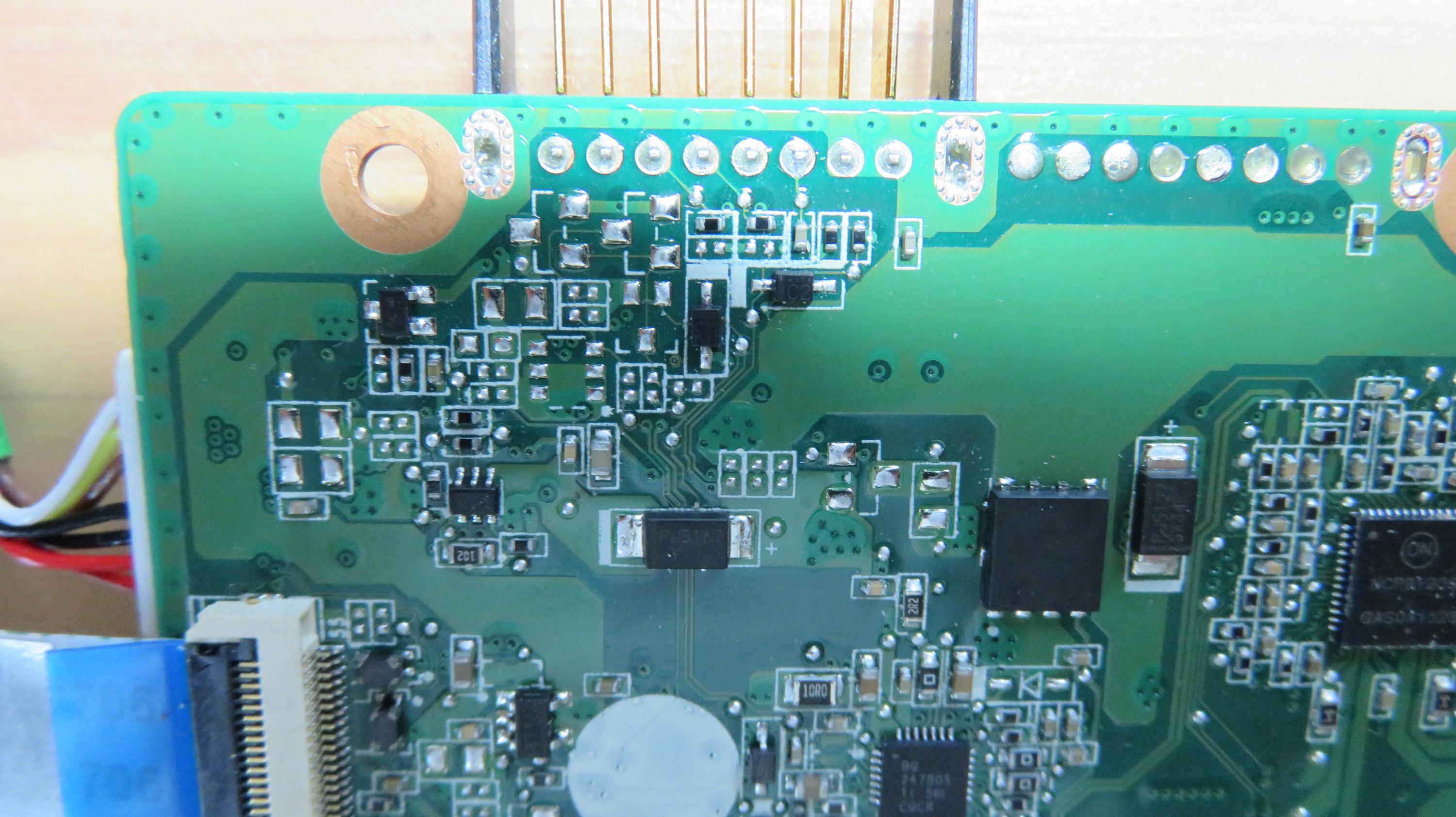

      First, we need to know the voltage on all pins input FETs. You mentioned the source and drain pin voltages, but we still need to know the gate pin voltages.
      Second, a clear picture of that area of the board (front and back) would be helpful. The FETs are on one side and the charger IC is on the other. At the very least, the part numbers of all those would help.

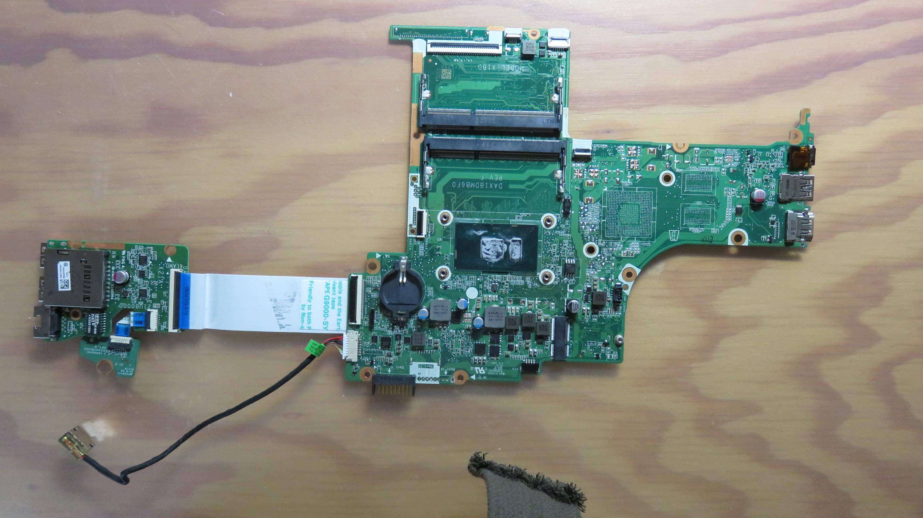

        Re: DAX1BDMB6F0 Power Issue
        Thanks for the response. I have uploaded three pictures of the board, one of the entire board, the other two of the area of interest (front and back). If you zoom in a bit, you can read off the part #s (One picture is here, the other two are in the next post.).
        https://www.badcaps.net/forum/attach...1&d=1530143848
        The voltage on the first FET after the red power wire coming into the board is 19.7 on all 4 pins. On the other side of that FET it is 15.5 on the first pin and 19.7 on the other 3 pins. On the next FET it is 19.7 on all 4 pins and on the other side, 0.7 on all four pins. On the third FET, it is 0.7 on all four pins and 0.00 on the other side on all four pins.
        There is a bigger FET (I gather it is the "gate" you referred to) that has 24.6 on one pin and 19.7 on the other three and on the other side it has 19.7 on all four pins.
        If I turn the board there is a FET that has 19.7 on all four pins and on the other side 0.7 on all four pins.
          The previous pictures did not seem to upload correctly. Try these.
          https://www.badcaps.net/forum/attach...1&d=1530145060
          https://www.badcaps.net/forum/attach...1&d=1530145252

            There are a couple ways to get pictures to show up in your message. The best is to just use the "Manage Attachments" link and upload the pictures there. They will show up at the bottom of your post without you needing to add anything else to the body of your message.
            For the pin voltages, it's best to list pin numbers they were measured on. For help with pin numbering, see here.
            The connections to a FET are named "source", "drain", and "gate". The FET is basically a switch that connects the source and drain only if the voltage on the gate is within a certain range. That range is determined by the type of FET that it is. For more about MOSFETs, see here.
            The 2 input MOSFETs on your board are indicated in the first attached picture. It sounds like you measured the small FET on the left, then the 2 small ones on the right, and finally the large one in the middle. Therefore, you seem to have 19.7V on all pins of the first input FET (red), except for 15.5V on pin 4. And 19.7V on all pins of the second input FET (yellow), except for 24.6V on pin 4. Am I understanding you correctly?
            If that is correct, then 19V is passing onto the main power rail like it is supposed to. So, the next thing to try is to measure the voltages on all the grey coils. The coils are indicated in the second attached picture. I gave them names so they are easy to refer to. Measurements should be taken with the heatsink/fan, memory, and 3V coin cell battery installed. Each coil has 2 pins, but it doesn't matter which pin you measure.

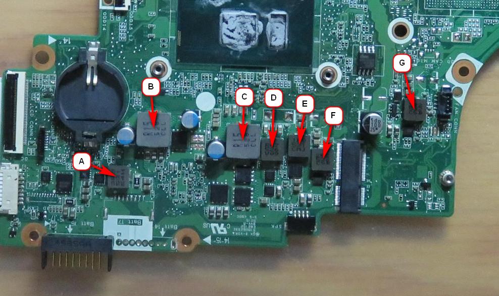

                Thanks again for all the information, I see that you have taken time to explain this so it is appreciated.
                I had a mishap happen. The center pin in the power supply connector broke just now and of course I'm stuck...
                I took the measurements of the grey coils before the pin broke but please note that the charging light was not on. Please note as well that the fan was not turning but was plugged to the board and the battery was in its place on the board.
                A= 0.19v
                B= 0
                C= 0
                D= 0
                E= 1.02v
                F= 5.07v
                G= 3.33v
                About your question, you are correct, and yes it is pin 4 with 24v. I took measurements on the pin that gave me 15.5v and made a better connection and that pin went up to 19v

                    Thank you to ggallarde. I can now attach real names to everything without wondering how different the X1A schematic is from the X1B.
                    A = PL8 = Battery charge voltage (+BATCHG)
                    B = PL16 = CPU graphics (+VCCGT)
                    C = PL14 = CPU core (+VCC_CORE)
                    D = PL12 = CPU system agent (+VCCSA)
                    E = PL13 = Deep Suspend rail (+1.0V_DEEP_SUS)
                    F = PL11 = 5V rail (+5VS5)
                    G = PL17 = 3V rail (+3VS5)
                    And one I didn't label, way over next to the memory slots, is PL26 for the memory power rail (+1.35VSUS).
                    So it's actually getting pretty far. It has the 3V and 5V rails powered.

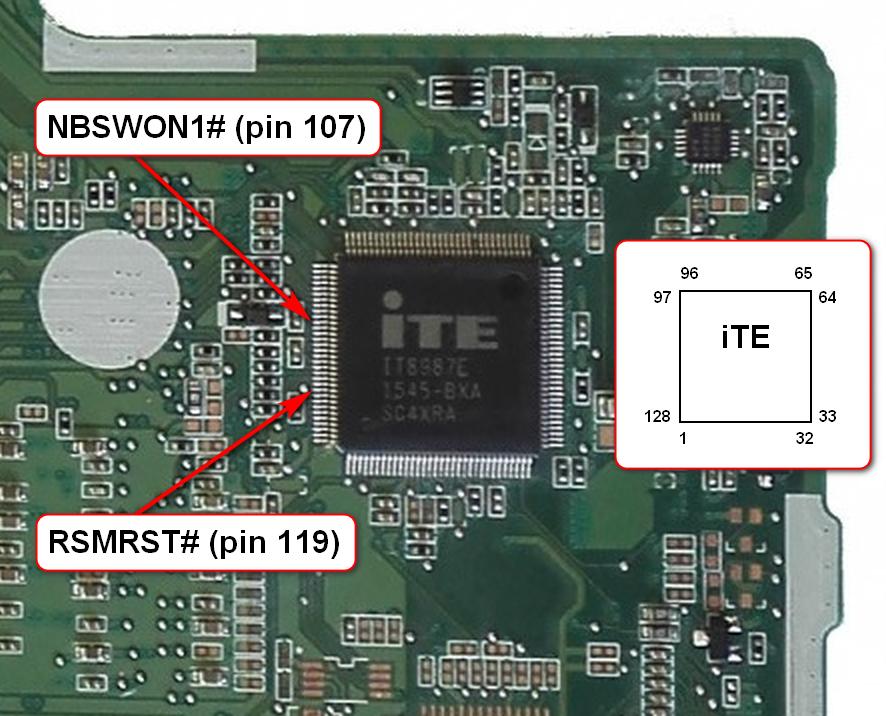

                    Next, find the EC chip. It's on the back of the board and has "iTE" written on it. See the attached picture.
                    - Measure the voltage on pin 119 (RSMRST#).
                    - With the power button board connected, measure pin 107 (NBSWON1#). There should be 3V. Press the power button. The voltage should drop to 0V. Release the power button and the voltage should rise back to 3V.
                    Count the pins carefully. And be very careful not to short out adjacent pins. It is safest to just look at where the traces go from those pins and measure the voltage at a nearby component or test pad.

                        Okay, so everything you've measured is working right up until RSMRST#, which is supposed to go up to 3V.
                        The last few pages in the schematic describe the power sequence. And if we work backwards from the RSMRST# step, we can see if there is anything else missing. There are 3 outputs we haven't tested yet.

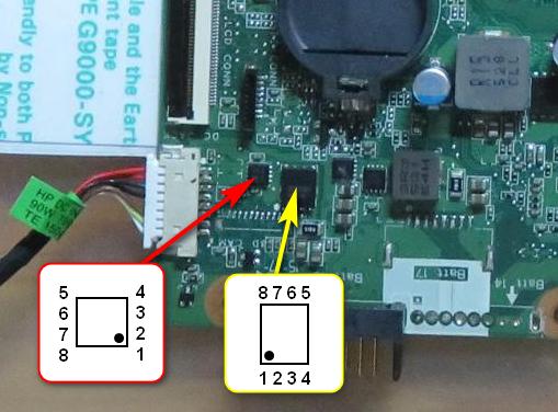

                        Measure voltage on:
                        - iTE chip pin 89 (SLP_SUS_ON)... refer to previous post for pin numbering
                        - Firmware chip pin 8 (+3V_DEEP_SUS)... see attachment
                        - 1.8V regulator output inductor (+1.8V_DEEP_SUS)... see attachment

                          ITE chip pin 89 = 3.02V
                          Firmware chip pin 8 = 3.33V
                          Regulator output inductor = 1.78V
