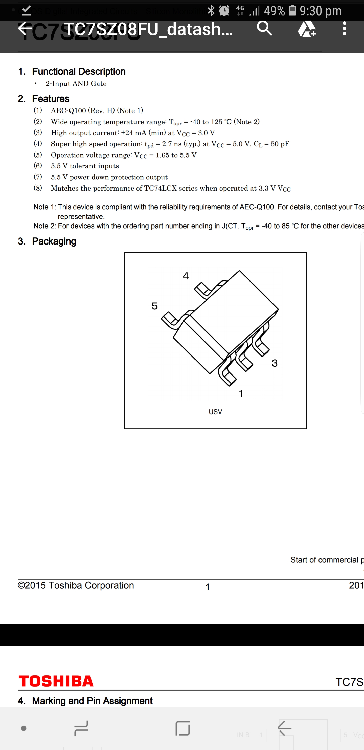

        Then check PWR_GOOD_3. Pin 4 U1012 should be 3 volts.
        • Johndill
          • Aug 2015
          • 314
          Re: HP EliteBook 8760w - No CPU VCore
          According to the data sheet for pin arrangement, U1012
          pin 1 is 3.3V
          pin 2 is 1.4mV
          pin 3 is 0.0mV
          pin 4 is 0.0mV
          pin 5 is 3.3V

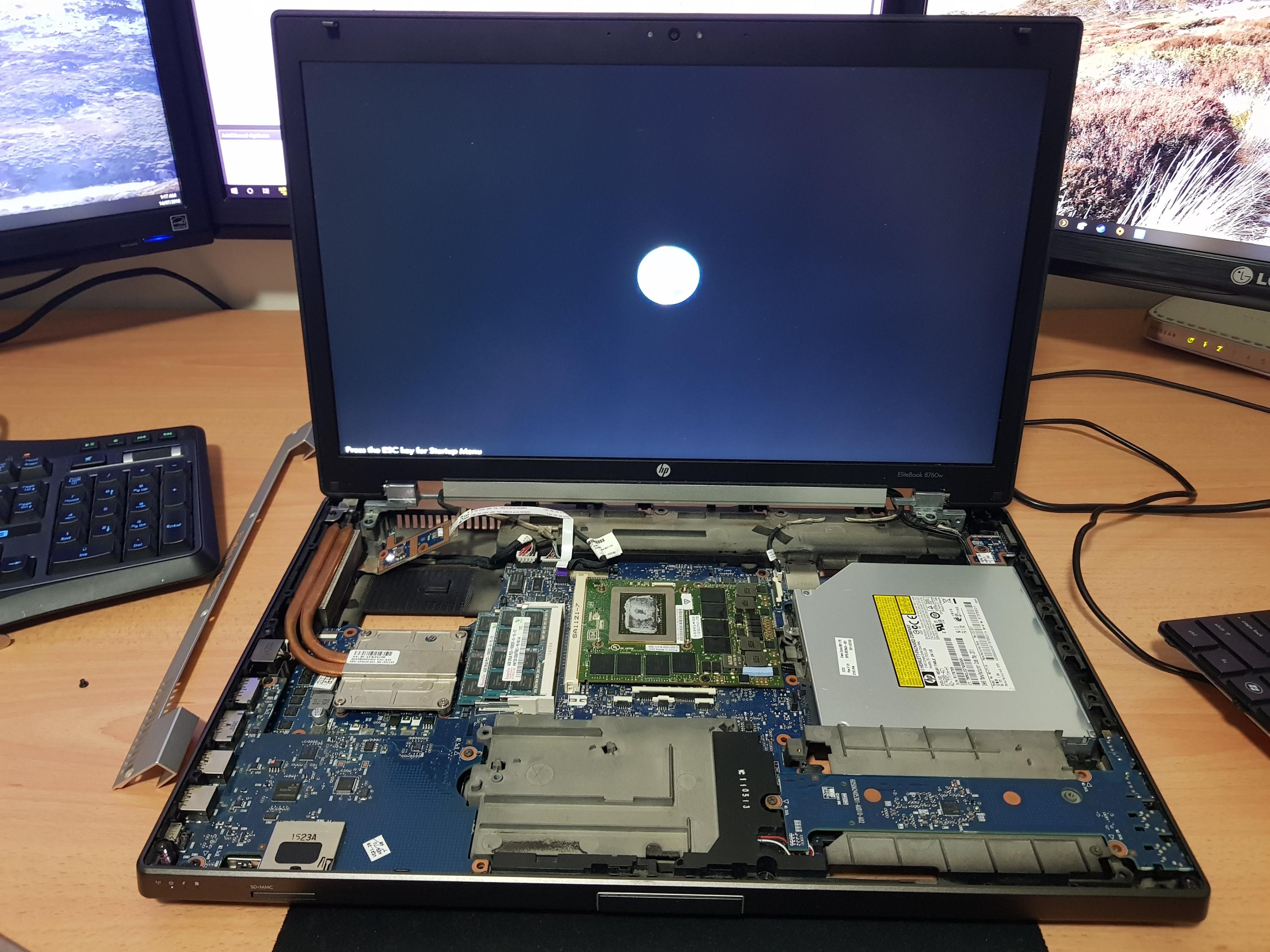

                              Problem solved! I put my Alienware GTX 675M in it and it now boots and displays, is there a way of troubleshooting the MXM card or could I heat it up with a hot air reflow station and see of that will work?

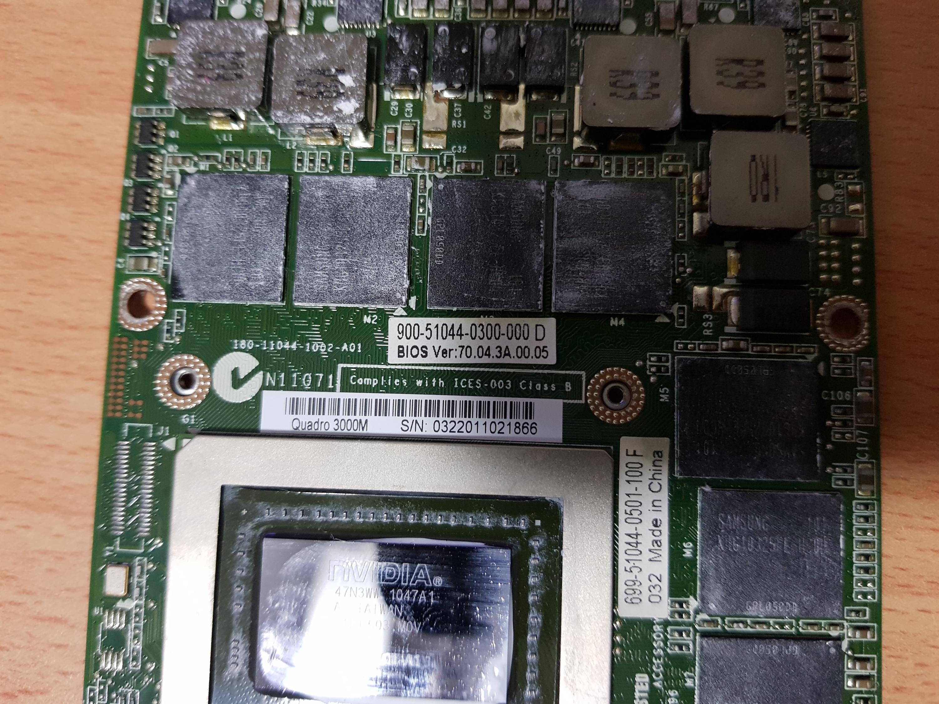

                                Could you take pictures of the dead MXM card?
                                • Johndill
                                  • Aug 2015
                                  • 314
                                  Originally posted by piernov
                                  Great!
                                  It's a Quadro 3000M
                                  • caspian
                                    • Oct 2015
                                    • 1591
                                    • Laptop
                                    MXM graphics cards has 3 different versions which are probably not compatible. In addition, if you buy a MXM card, it can not be trusted. Thus, finding and buying a compatible MXM card takes time.
                                    to test the old card, first check whether the tantalum capacitors or the coils are shorted or not. but probably, the gpu chip should be failed.
