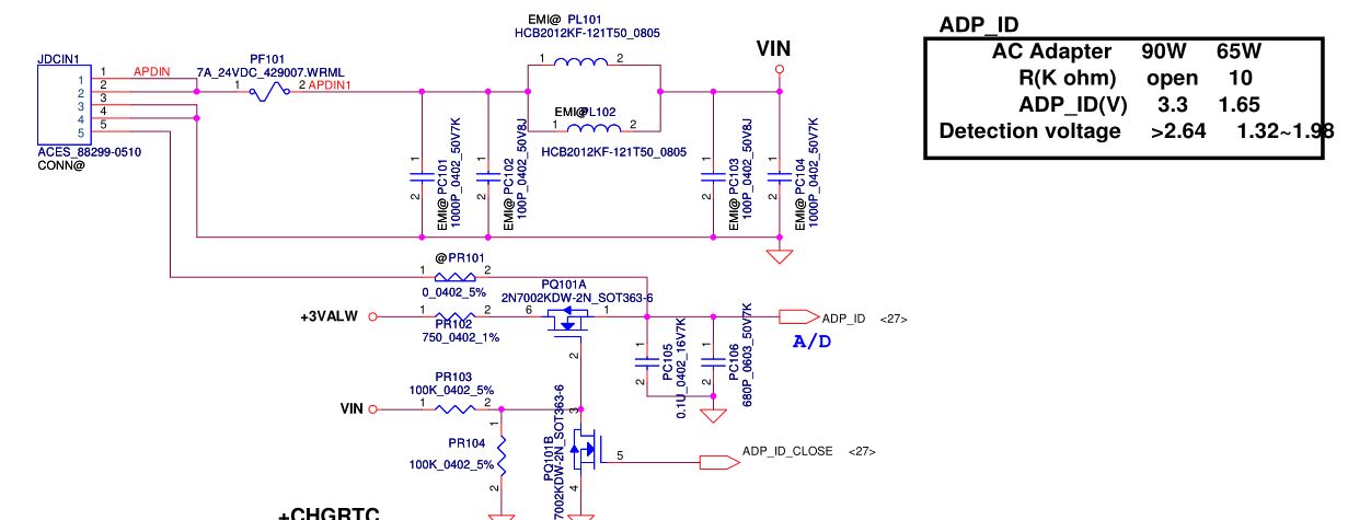

    Re: Lenovo b50-45 dc connector help
    Check the schematic and see the . Compal LA-B291P
      pin-1 red
      pin-5 black
      not sure can you help
        you can safely ignore any pins other then RED & BLACK. Red is for 19v and black is for ground. Rest of the pins are adp/ps id pins which are not necessary for dc supply. Those pins are important while charging battery.

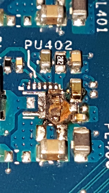

          this is what i discovered this is causing the short.
          wonder what part this is a cap or resister.
          and the scratched surface.

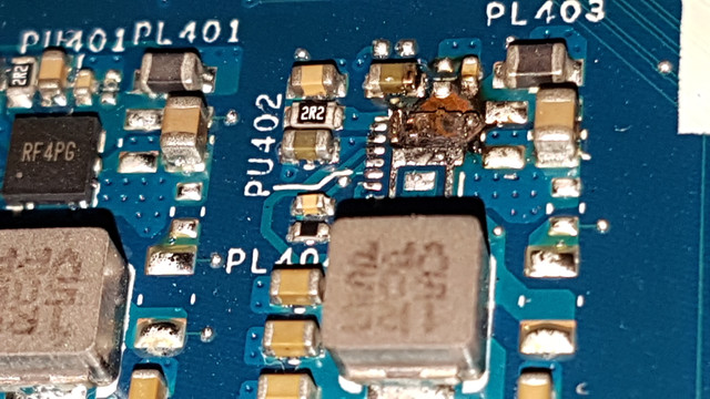

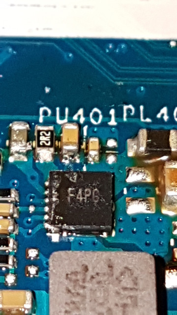

            What is blown is similar to (PU401) RF4PG likely PU402 is a RG4QJ
            Could be an SY8208CQNC_QFN10_3X3 but I am not 100% sure
              2r2 resister??
              • R_J
                • Jun 2012
                • 9551
                The whole ic is missing!
                  ok this is the bad ic
                  were can i get one of those,ebay will be best if you can help me thanks.
                  with the help of thermal i tracked the bad part fast,life saver
                    I do not know, I don't usually repair laptop boards, likely ebay/China. Maybe someone that does laptop repairs can be more help
                    I see that same ic location with what lookslike the same ic but with a different marking code

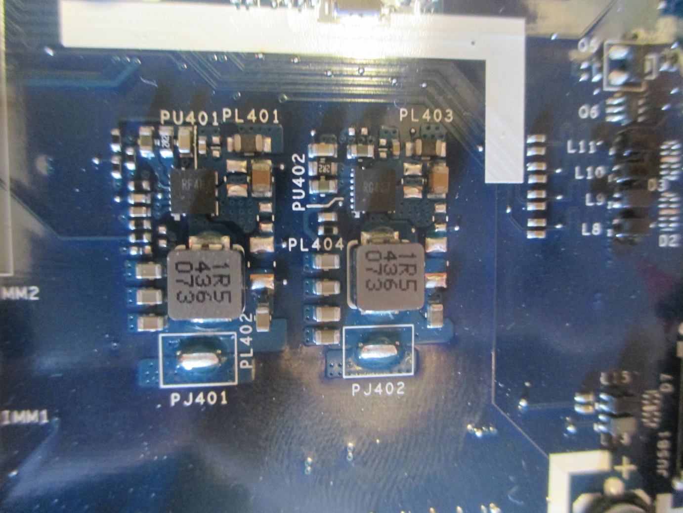

                      i think it maybe this
                      SY8208BQNC_QFN10_3X3
                        PU402 is a silergy SY8208CQNC . PU401 is a silergy SY8208BQNC
                          I believe there is a difference between the SY8208CQNC_QFN10_3X3 and the SY8208BQNC_QFN10_3X3
                          See if this helps (page 46)
                          I also saw this:
                          SY8206BQNC / Sy8208bqnc - 3.3V
                          Sy8208cqnc - 5V
                          Sy8208dqnc - 0.95V
                          So you need to replace it with the correct IC
                            Yes, there is a difference, the SY8208CQNC is a fixed 5V regulator and the SY8208BQNC has a 3V LDO

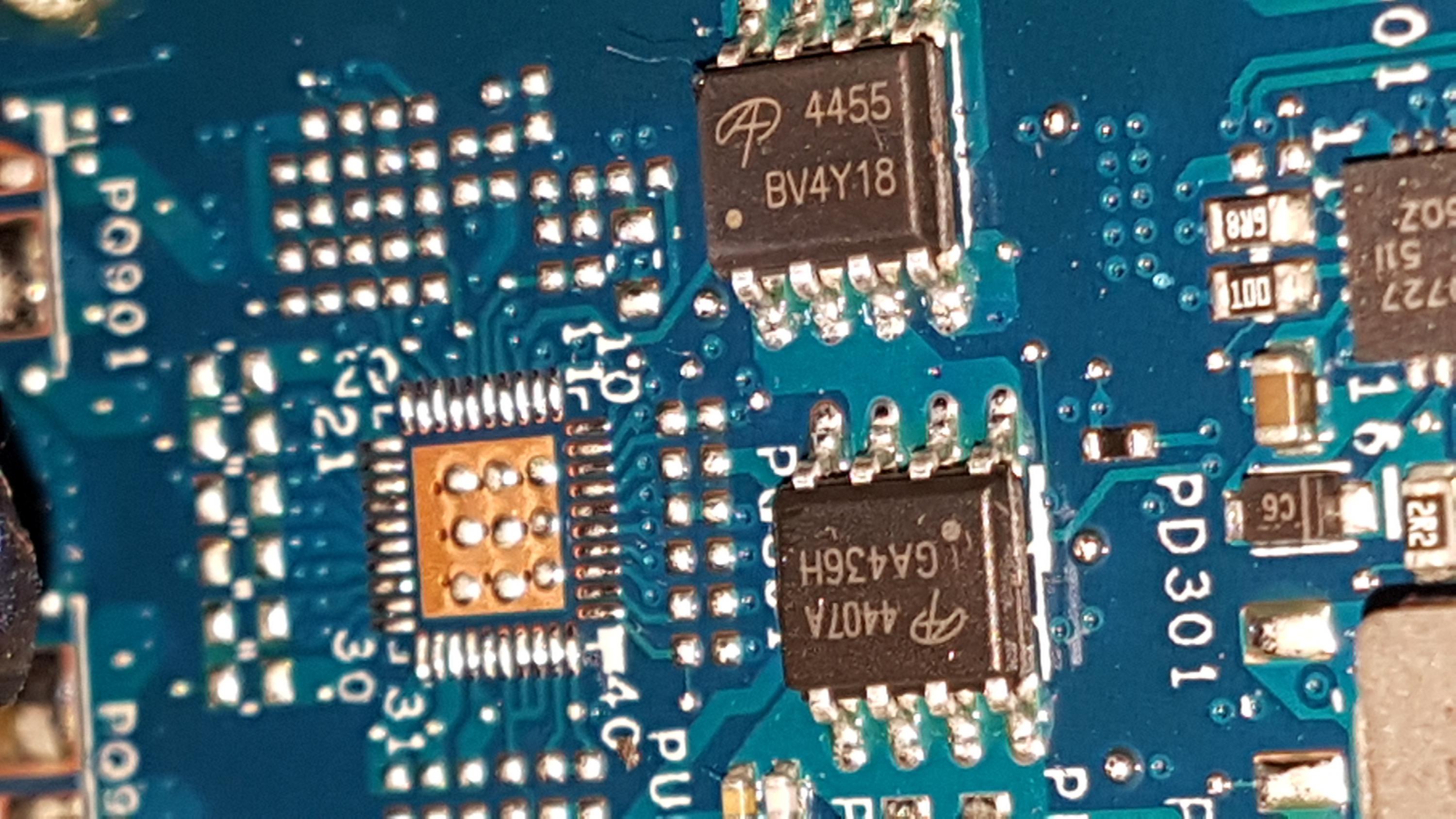

                                I changed the ic and now no amps drawing just 0amps 19v.
                                Were can it be
                                • Stevie2001
                                  • Apr 2018
                                  • 183
                                  • irland
                                  This mofset beeps on both sides
                                  bv4y18 4455
                                  drain and source beeping while it's on beep mode
                                    Test using diode mode, both ways to be sure but it sounds like it could be short.

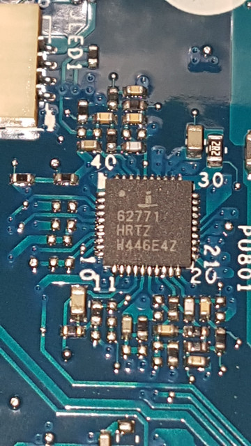

                                    • Stevie2001
                                      • Apr 2018
                                      • 183
                                      • irland
                                      This was shorted injected amps and detected this ic heating up checked using thermal also,this was replaced with another one that looks same but different value.
                                      I think this is the main problem,it is beeping on most of the pins with gnd.
