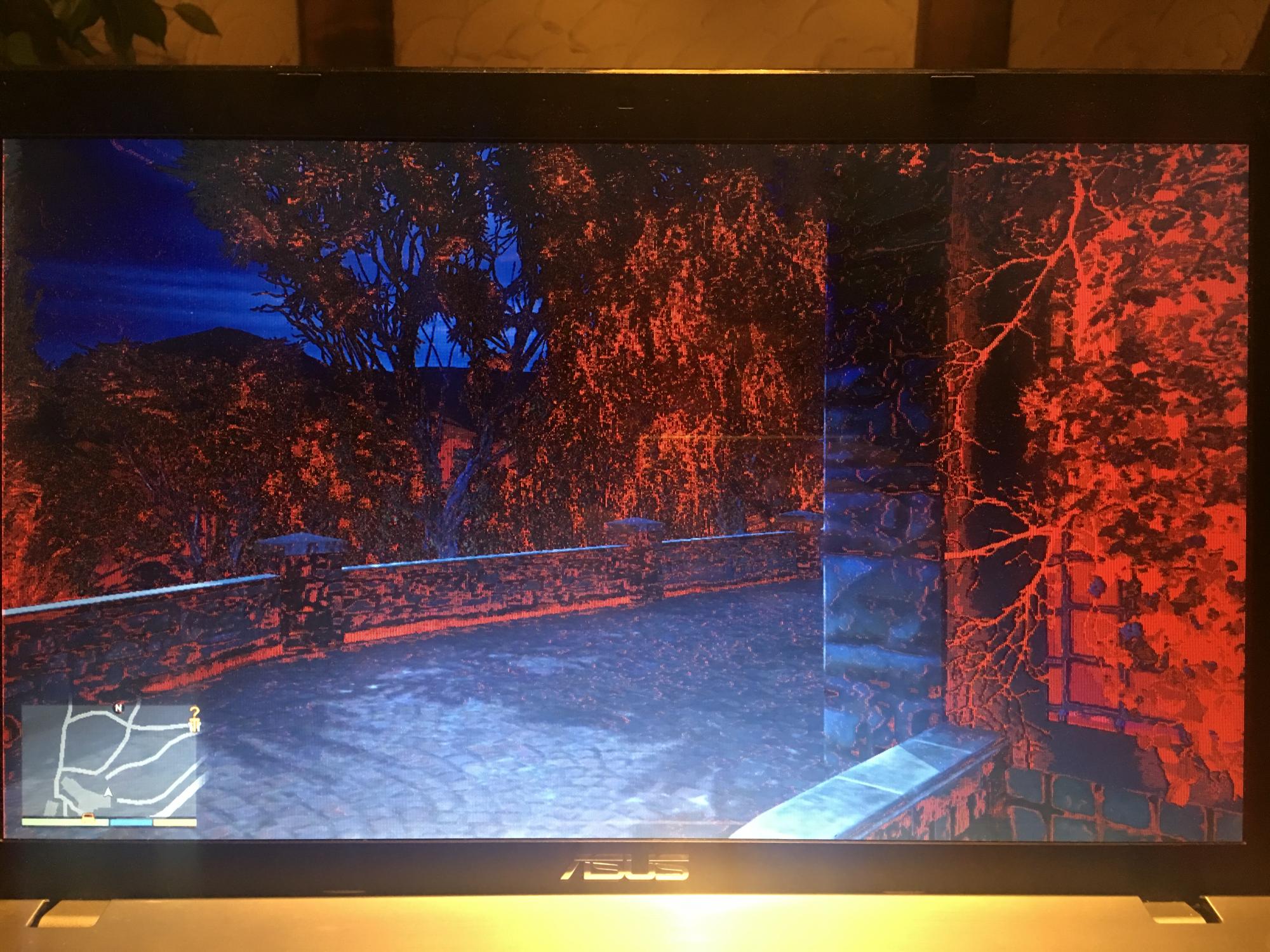

    So today the GPU in my ASUS F750L decided to die. The laptop had a really bad liquid damage before but i cleaned everything up really well and it worked perfectly for a month now. I even played some hours of GTA V on this machine.
    Im pretty sure it is not due to thermal stress because the GPU was hitting 70°C at max. I guess there is still some residue of the liquid damage under the chip? I'd try to reflow the chip with plenty of flux and clean it in an ultrasonic cleaner but i want to ask on the forum before i mess with this since it is a quite powerful machine in my opinion.
    And no it is NOT a driver issue. I reinstalled Windows and after installing the latest nvidia drivers it BSOD'd when i open a game. it spits out the common error message VIDEO_TDR_FAILURE and shows up in the device manager with error code 43.
    Any suggestions before attempting to reflow it? I know that the chip itself could have gone bad and that heat temporarily fixes the issue which has nothing to do with the solder balls. I know about the baking voodoo.

                    I did what you guys recommended and it works again. I hope it was just junk under the GPU. But i will see that in a few days. If it fails again then the chip is dead i guess. I have some really runny flux which is like water. I used this to flood the chip and vram and then heated it up to 200C. Same with the alcohol to clean it up. We will see how it goes. As for now it is working and currently running GTA V for testing.
                    EDIT: 5 Minutes in and i got red pixels everywhere. I guess the chip went bad, hm?
                    EDITEDIT: It was just the LVDS Connector. Sorry!

                        Red/magenta pixels everywhere, without the system locking up or crashing is almost always an indication of a poorly seated or damaged LVDS cable, or, in some cases, a bad screen. Bad GPU will commonly give blue or yellow pixels and usually in patterns, together with crashes in intensive programs and games.
                        Glad that you got it going.
