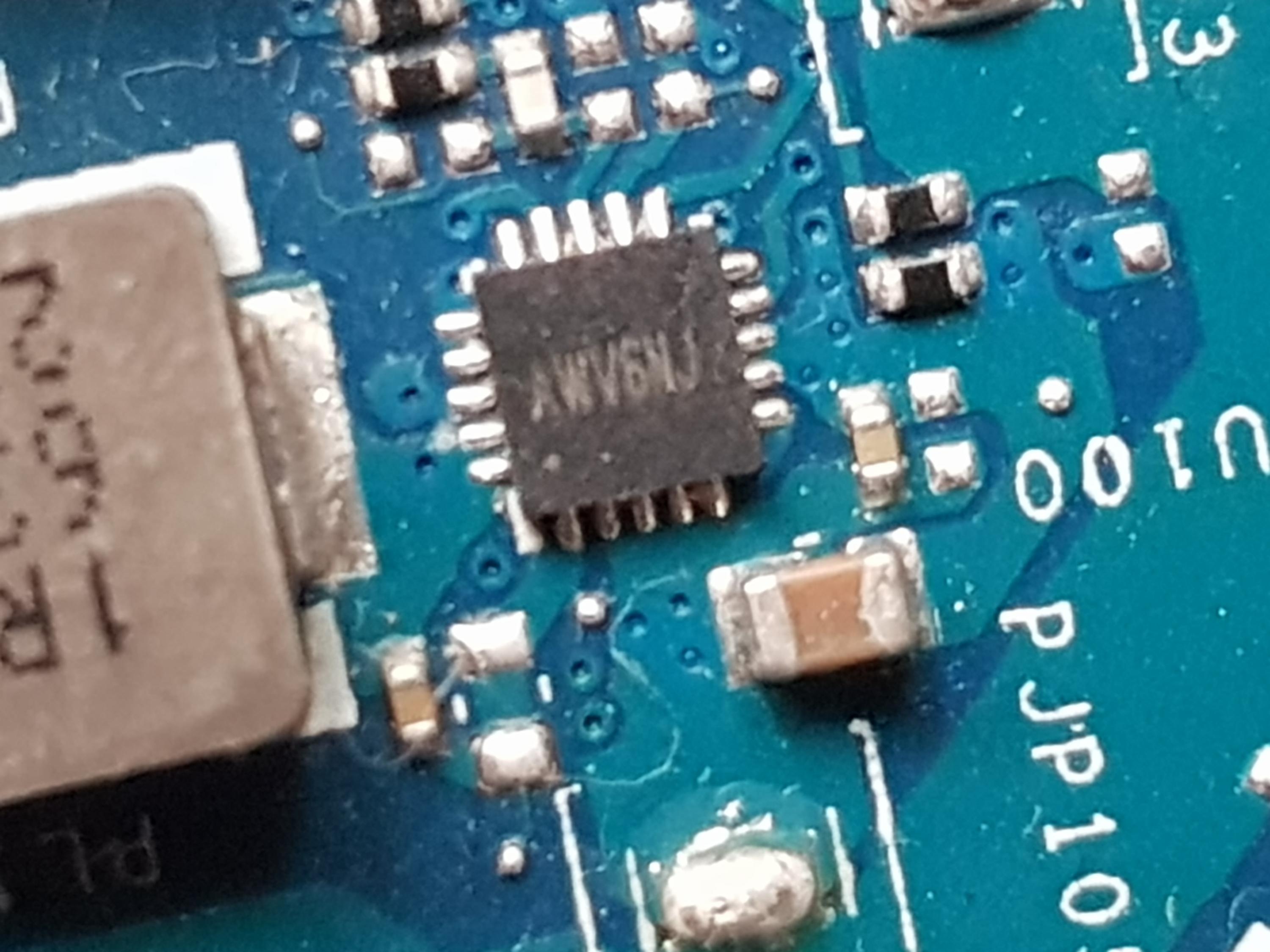

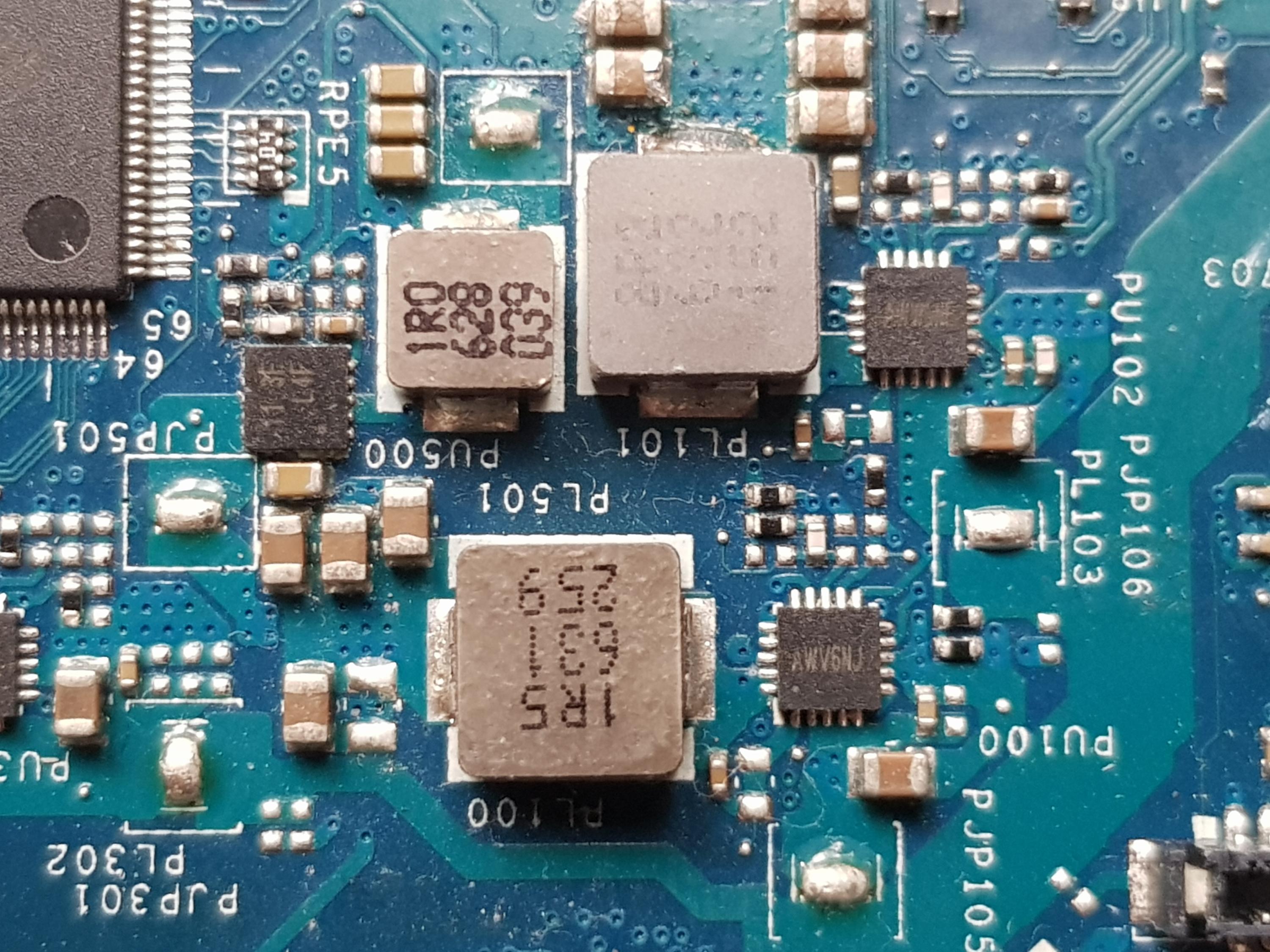

    dell 5567 i3 7100u
    mb LA-D802P ( no scematic)
    Laptop dead , low resistance on main 19v rail line and on and around 3,3v coil
    short circuit test done and chip AWV6NJ ( 20 PIN ) PU100 is heating up right next to 3,3v coil (pl100)
    Im attaching pictures
    Please anyone can help identify AWV6NJ chip?????
    Thank you

    Most probably theres a short in +3vs rail, much likely a short mosfet. what voltage you registered on pl100?

      Re: Dell 5567 i3 7100u dead shorted please help identify chip
      Hi
      Chip is SY8286BRAC

        Hi after pluging charger light going off and no volatge anywhere ..... bench power suplly indicate short after second main protective transistor pq718 , i worked on this mb before becouse it developed differnet foult on 3.3v line and im 99% sure that this peticular component is burned/shorted/dead i just need to identfy it a replace it
        any help appraciated
        thanks!
              are the AWV6xx interchangeable with AWV5XX???
              • BlueMidnight
                • Jan 2015
                • 489
                The last 3 characters are the year, week, and lot code. Only the first 3 characters matter.
                AWR = SY8286ARAC
                AWV = SY8286BRAC
                AWW = SY8286CRAC
                etc..
                And the chip is a step-down/buck regulator with integrated FETs.
                    Only chip SY8286BRAC will work. SY8286CRAC is for 5v
