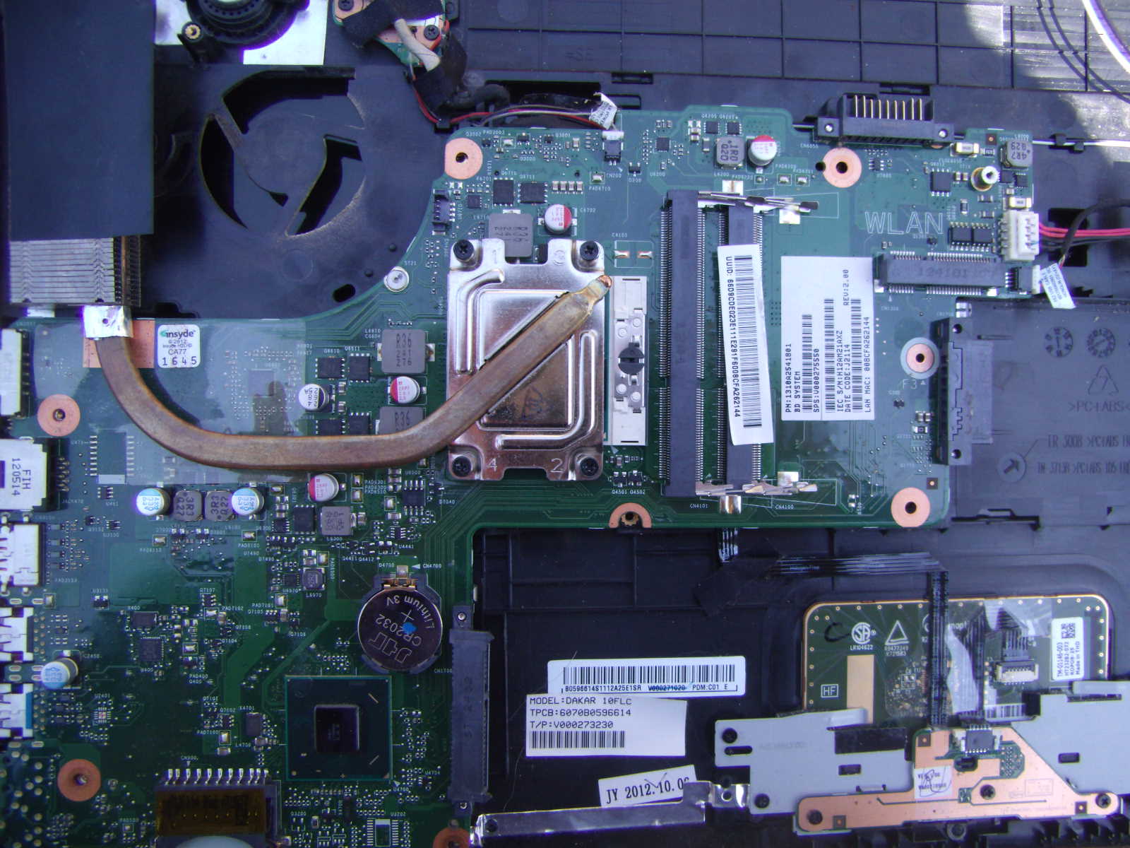

        hi
        can you point out in photos which mosfets?
          Re: Toshiba laptop C855 no power dead
          Dear shelby. look for some shorted cap or mosfet in vcc area-just near heatsink pipe. thats the area where fault occurs in this mb most of the times. I came across fault in that area atleast 3 times in this mb in last six months. Your pic#3 to look for.

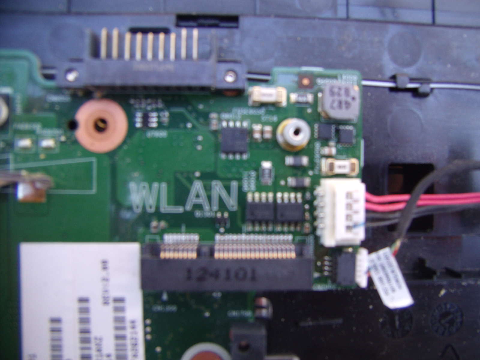

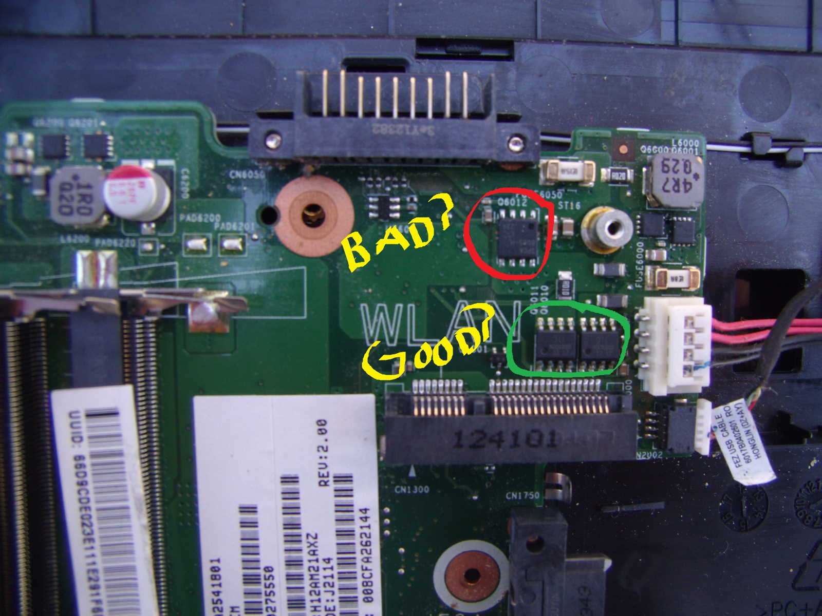

                  Other day i was probing board and with plugged in i get 19v at input and then there are two mosfets near input area and near 2 fuses....u can see in pic...
                  When i probed these mosfets...the one closest input power tested 19v at all 4 pins on one side...other 4 pins were 0v
                  The mosfet next to it tested 0v on all 8 pins
                  Not sure if this means anything at all

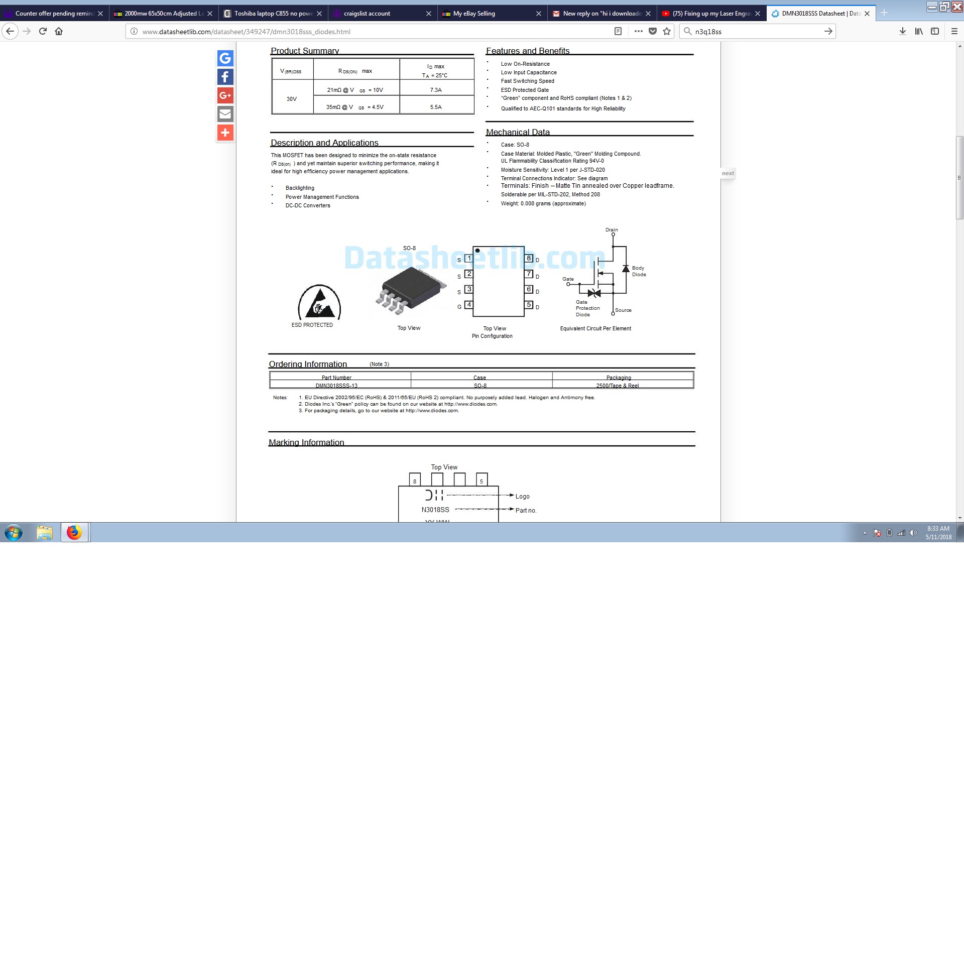

                        here is a data sheet for the 2 mosfets near power input
                        apparently you asked me to test pins source to drain and pins source to gate..correct?

                                hi

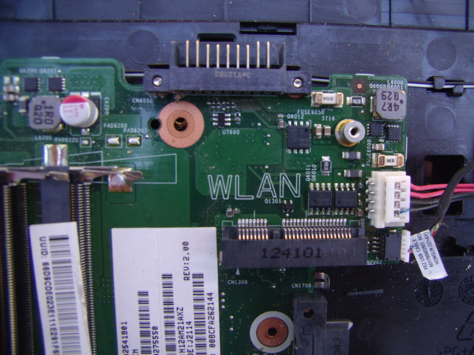

                                i may have found a suspect part..there is a mosfet alone north of the 2 mosfets and north of the power input that is near a fuse.and just southeast of the battery charging port .i just tested it and with power unplugged when i test S-D i get a 500 reading using diode....this should be no reading correct / no continuity correct??
                                mosfet part is TPCA 8065-H

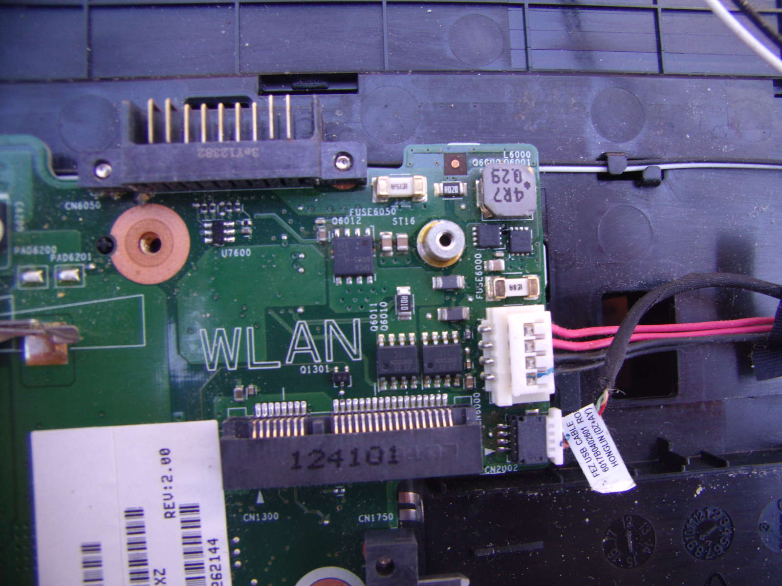

                                  see photo
                                  maybe im getting somewhere?

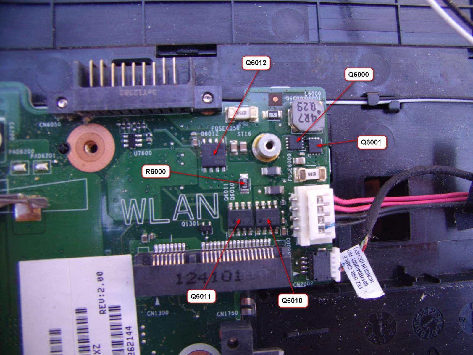

                                    Let's take a step back. You need to follow the power sequence in a systematic manner to determine at which point it is having trouble.
                                    First, measure the voltage at R6000. This will tell us if power is being allowed through the input MOSFETs. If you get 19V there, then measure the voltages on L6100 and L6150 (these are for the 3.3V and 5V rails). However, if you do not get 19V at R6000, then instead measure all 5 MOSFETs in that area (indicated on the attached picture). You only need 3 measurements per FET because some pins are tied together (pins 1-3, pin 4, and pins 5-8). And also measure all pins of U6000 (located in the same area, but on the back side of the board).
                                    The schematic is attached. U6000 and the surrounding circuitry is located on page 5.

                                        q6012 is the mosfet that i think is supect during testing in circuit via diode ....testing S-D in which i was told should be open circuit but its not testing open....but maybe since its in circuit it could be giving inaccurate results
                                        i get a reading of 550 in diode mode when testing S-D on Q6012 and switch probes i get same reading
