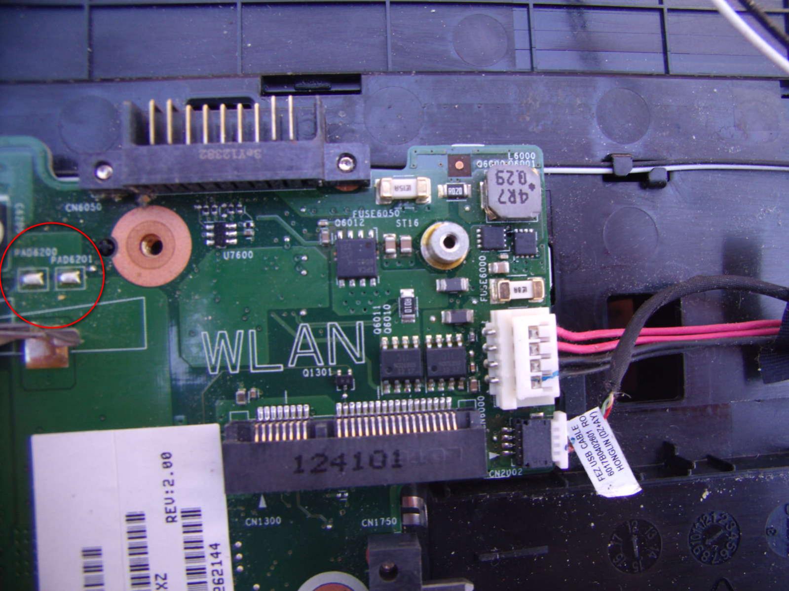

      i can tell you from testing other day that when power plugged in i tested Q6011 and Q6010
      and if my memory is correct
      Q6011 i got 0v on all 8 pins
      Q6010 i got 19v at pins 5678 and 0v at 1234
      i will double check when i can

        It looks like there is a pre-charge circuit on this board also, made up of R6015 and D6002. So there really should be voltage on the main power rail regardless of whether the input FETs turn on or not.
        Given your confirmation just now of which exact FETs you had measured before, I'm inclined to change my instructions on what to check first...
        Do confirm your readings of course, but then I suggest measuring between R6000 and ground. Do it with the power unplugged and with the meter in "diode mode". Place the red probe on ground and the black probe on R6000. In diode mode, readings will be in volts (or may even show no continuity at all).

            ok here are results..i could not really test Q6000 or Q6001..too small my probe too big...would have to grind end down to do that...but i dont believe those are issues per doing my research i tried to run my probe as best i could along the pins and saw no voltage but not really sure
            unplugged... using diode test R6000 as u stated 001 reading
            plugged in.... pin 1 2 3 4 5 6 7 8
            Q6010 0v 0 0 0 19 19 19 19
            Q6011 0 0 0 0 0 0 0 0
            Q6012 .41 .41 .41 .19 0 0 0 0
            R6000 0v

                  You don't need to measure the last 2 FETs. What you've found out so far is really good so we won't need those. And by good I mean bad. There is indeed a really nice short to ground on the PVBAT rail.
                  But just for any FETs you measure in the future.. as long as pins 1-3 are connected together and 5-8 are connected together (you can usually clearly see they are because the trace on the board touches all of them), you don't need to be too careful with the probe. Just jam it in between a couple pins. The only one you have to be really careful about is pin 4. But since that one is on the corner, it's usually not too hard to get to without touching anything else. Just be aware that not all 8-pin components are FETs, so you have to make sure the pins really are connected together before trying to stick a probe in between them rather than on one at a time.
                  Do you have a bench power supply with a voltage and current control? If so, it is possible to inject a voltage on the PVBAT rail and then feel which component is shorted (it will get warm). Since it's a dead short, little voltage is required (even 1V will do), but the amps should be limited to probably no more than 1A to start with... and then increased a bit if there is a need. 12V from a regular PC power supply will also work if run through an automotive 12V DC 1A bulb to limit the current.
                  If you don't have a power supply to use, then the alternative is to start disconnecting parts of that rail until the short goes away. That way you can narrow down where the short is.
                  Fortunately, that board has solder jumpers connecting various parts of the board. Those are very easy to desolder. Just use some copper desoldering braid to make sure all the solder is removed and the connection is completely broken between the two sides of the jumper.
                  The solder jumpers on the PVBAT rail are:
                  PAD6000
                  PAD6110
                  PAD6210
                  PAD6310
                  PAD6610
                  PAD6710
                  PAD6760
                  I've circled a couple examples of solder jumpers in the attached picture. Those aren't on the list of ones you need to remove, but it lets you know what they look like. They aren't hard to spot.
                  After removing each jumper, measure from R6000 to ground in diode mode again. Once you get a higher reading, you know the short must be somewhere in the circuit you just removed the solder jumper for.

                                      those jumper pads you are referring to are very very small..so you say that each one of those tiny blobs of solder are within that blob is connecting 2 pins together? .

                                        The things that are labeled "PADxxxx" (where xxxx is a number) and have a white box drawn around them, are solder jumpers. And yes, they are connecting two traces with a tiny gap between them. If you remove the solder (cleanly with some desoldering braid), the two sides of the gap will be disconnected from each other. When you want to reconnect the sides, just put a blob of solder across them again.
