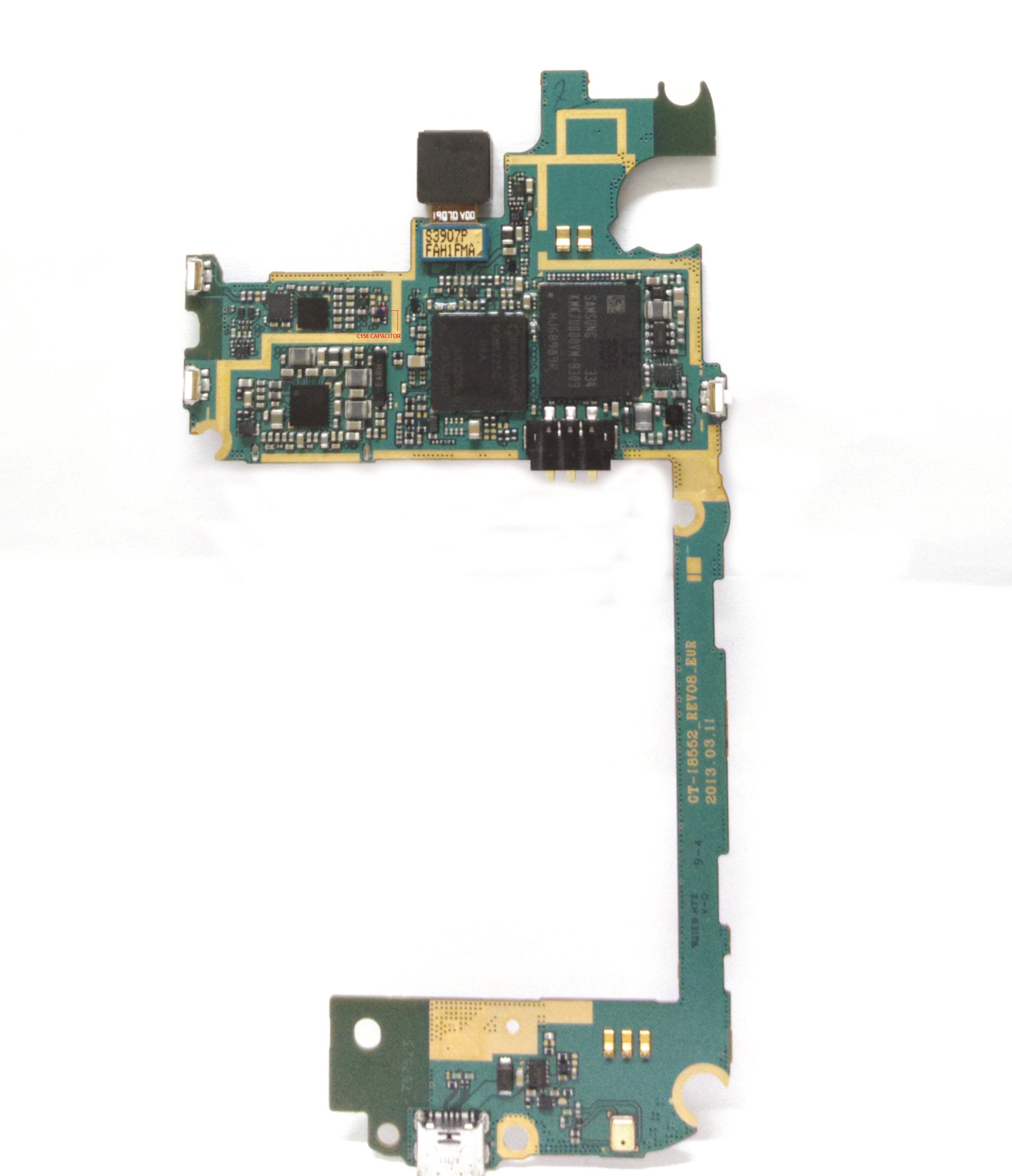

    Hi Badcaps.net,
    Does anyone here has any idea what the value of this ceramic capacitor (C158). I do able to download the schematic for my Samsung GT-I8552. They included only the part lists but not able to provide the values for the use of anyone who attempting to fix their useless product...that's the reason I'm here to post the photo of my SAMSUNG GT-I8552 mainboard asking for just little help from you guys. Thanks in advance if any kinds of help available to fix my leaky ceramic capacitor issue on my phone!

    Re: Suspected leaky cap causing fast draining batt for SAMSUNG GT-I8552
    Picture is very blurry , at least to me . Can you get higher resolution ?
      Try this site http://originalspareparts.com.ua/pho...2_galaxy_win#c
      C152,C158 2203-005734 - C-CER,CHIP 0.082nF,5%,25V,NP0,0603
        Hi R_J Badcaps.net,
        First of all I'm saying thanks for the very useful link you have posted here for me which will definitely provide the exact value of the C158 capacitor. I'll be likely ordering it at soon as possible as well as posting some photos of the repair here in this forum later on. Another thing is on the previous post I've mistakenly spotted a wrong ceramic capacitor label, it is C518. BTW thanks a lot for looking up the precise value here for me so that I can repair it instantly..
          Hi R_J Badcaps.net,
          Do you have any ideas how does the C518 ceramic capacitor of the mainboard GT-I8552 connect to the rest of the circuit for instance, THE CHARGING CIRCUIT of this phone and also if possible can you pls explain in briefly how and where it leads to. Here would like to attach the PCB diagram of SAMSUNG GT-I8552 for your reference..THANKS AGAIN HERE
