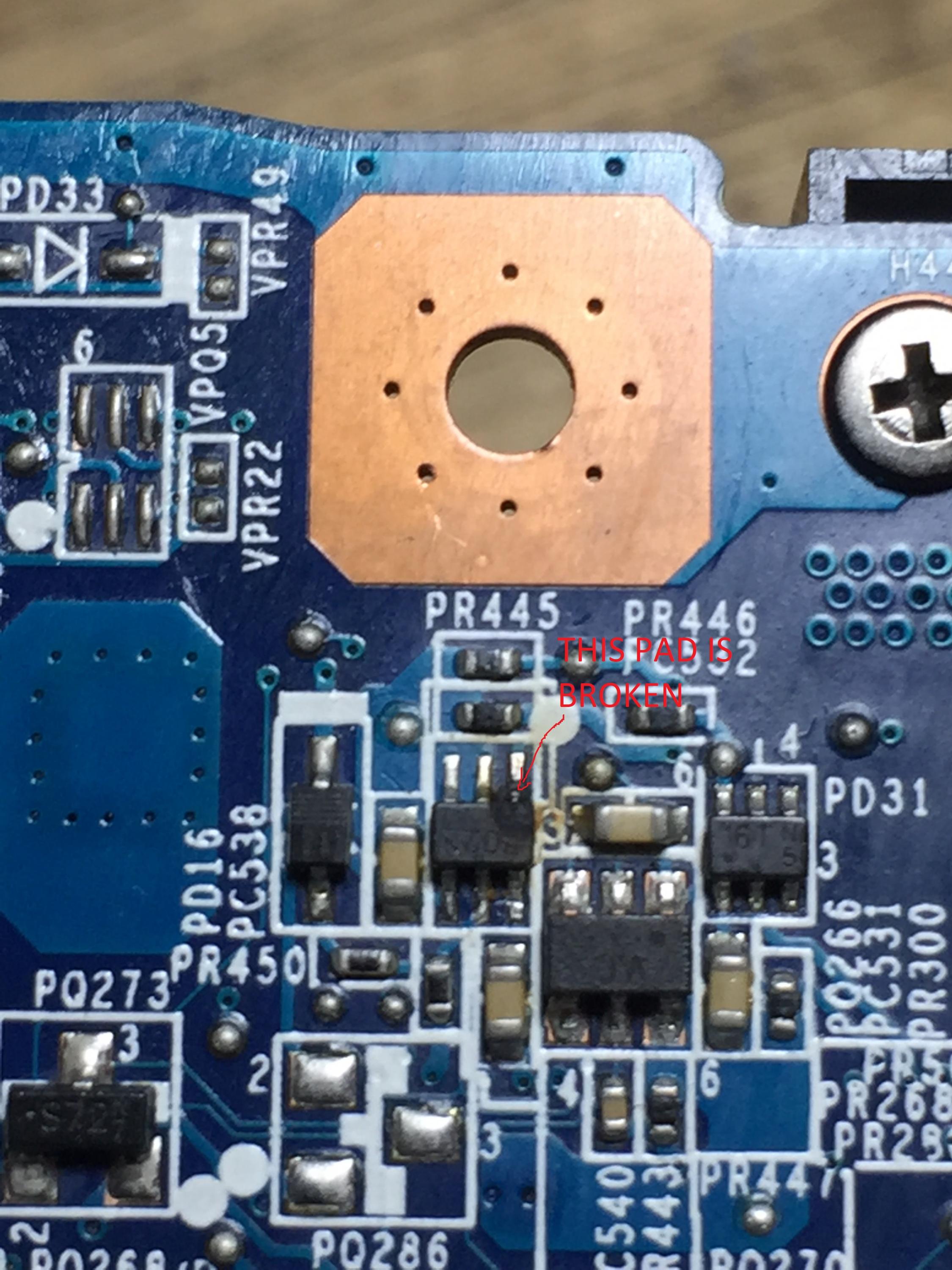

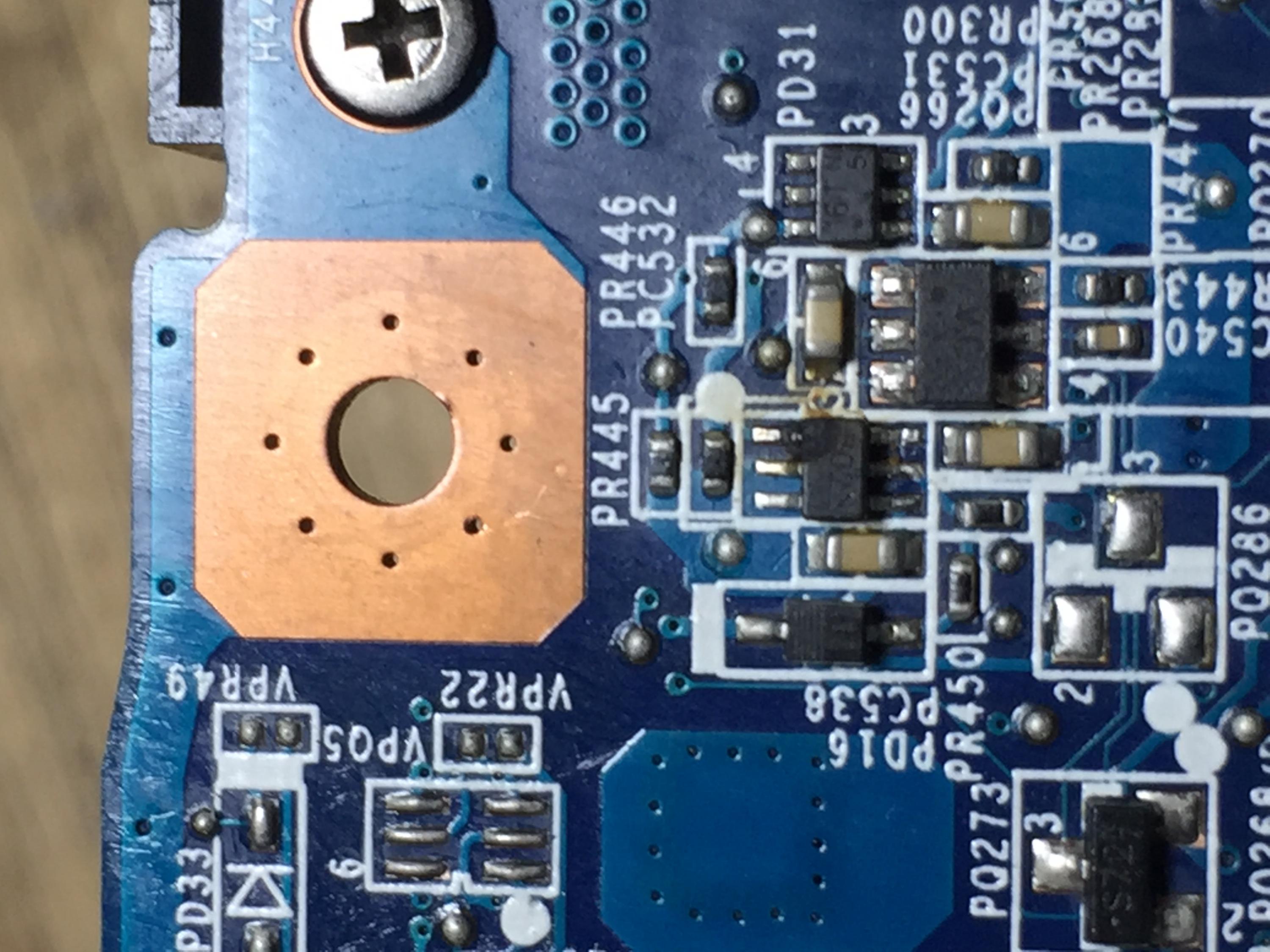

                      already done replace the burnt chip with the same 2N7002DW, but i have problem pin1 the pad is broken where should i make jumper to connect this pin1?I have attached the image

                        #31
                        Re: SONY VAIO SVE141D11L dead
                        If it is pin one, then looking at the schematic it goes to ground, same as pin 4.

                          #32
                          yes it is pin1 should i connect a jumper to the ground for this?and also i checked after replacing without this pin connected still there is no voltages on this pq270 and pq269.anyone please help on this

                            #33
                            when i replace again with another chip and jumper the pin1 to the ground since the pads is broken, now i measured pin2 and pin3 of PQ270 it shows only 9.5v and same voltage on PR445 but PR447 have 19v on one side other side have 0.anyone please help on this
                              9.5V isn't bad. It's not the voltage we want there right now, but it shows that part of the circuit is working. We do want it to be 0V eventually though.
                              That must not have been PR447 you measured, however. PR447 is right above PQ270 in your last photo and directly connected to pins 2/3 of PQ270 on one side, and ground on the other. It must read 0V on one side and the same voltage as PQ270 pins 2/3 on the other side.
                              The FET on the right half of PQ270 on the schematic is responsible for causing the gate of the left FET to be pulled to 0V, turning off the left FET. It only does this when VIN is high enough. Otherwise pins 2 and 3 of PQ270 will be roughly half of VA+ because they are in the middle of a resistor divider made of two 1M ohm resistors (ignoring the insignificant 10k ohm one). 9.5V is perfectly half of 19V, so no problems there. We just need to know why the right FET is turned off at the moment.
                              It would be helpful to know the measurements on all pins of PQ270 and not just a few. And because there is always a delay when speaking on a forum, it would save time to just measure that whole part of the circuit: PQ270, PR452, PR450, PD16, and VIN.

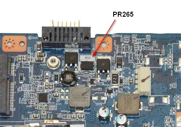

                                  #36
                                  PR450 and PR452 are connected at one end and have one of the voltages in common. And 19V isn't possible there. So I don't think that was PR452 that was measured.
                                  I highly recommend writing your measurements on the PDF (either in your PDF program or by printing the page and writing on the paper). That way you will immediately spot these kinds of inconsistencies and know to double-check your measurements.
                                  And now I am again suspicious of VIN because it is 0V. I see you wrote PR465 in a previous post after I mentioned PR265 and I misread that and didn't realize it before. So I'm not sure if that was a typo or you measured the wrong resistor. But we need to be very very sure about VIN so I'm going to ask you to confirm this. At PR265 (or anywhere else where you can find VIN with absolute certainty) please measure the voltage with the board powered. Also, with the board unplugged, measure from there to ground in diode mode.
                                  PR265 is the white component indicated in the attached photo (the color may vary). I like doing the measurement from the sense resistor because they look so different from other resistors (making them easy to find), and you don't have to worry about which pin is which.
                                      I had originally written PR265, so PR465 never needed to be checked. This new information is very helpful. It looks like there really is a short on VIN (or downstream from it).
                                      I also suspect that PQ270 was damaged when you saw the spark trying to measure pin 2. If you had accidentally bridged pins 1 and 2, there would have been a spark (which should never ever happen while measuring voltages) and the 19V on pin 1 would have been shorted to ground through PQ270, destroying it. It happens. We've all done that at least once in our lives. But now that is out of the way, so we can continue finding that next problem.
                                      The next step is to inject power at PR265, but this time you can slowly let the current go up to ~1A (with the max voltage set to 19V). Then feel to see if any components are getting hot. The most likely components to be bad are capacitors, ICs, and FETs. Hopefully 1A is enough to notice something, though you can go a little higher if needed.
