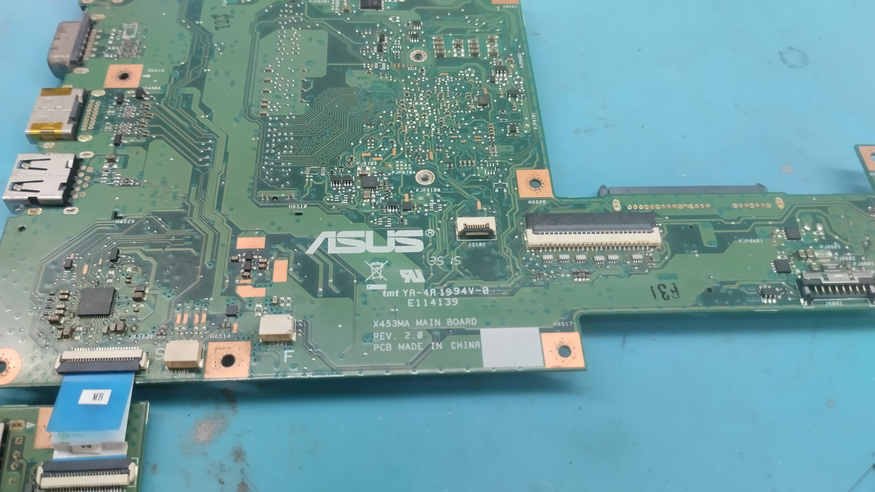

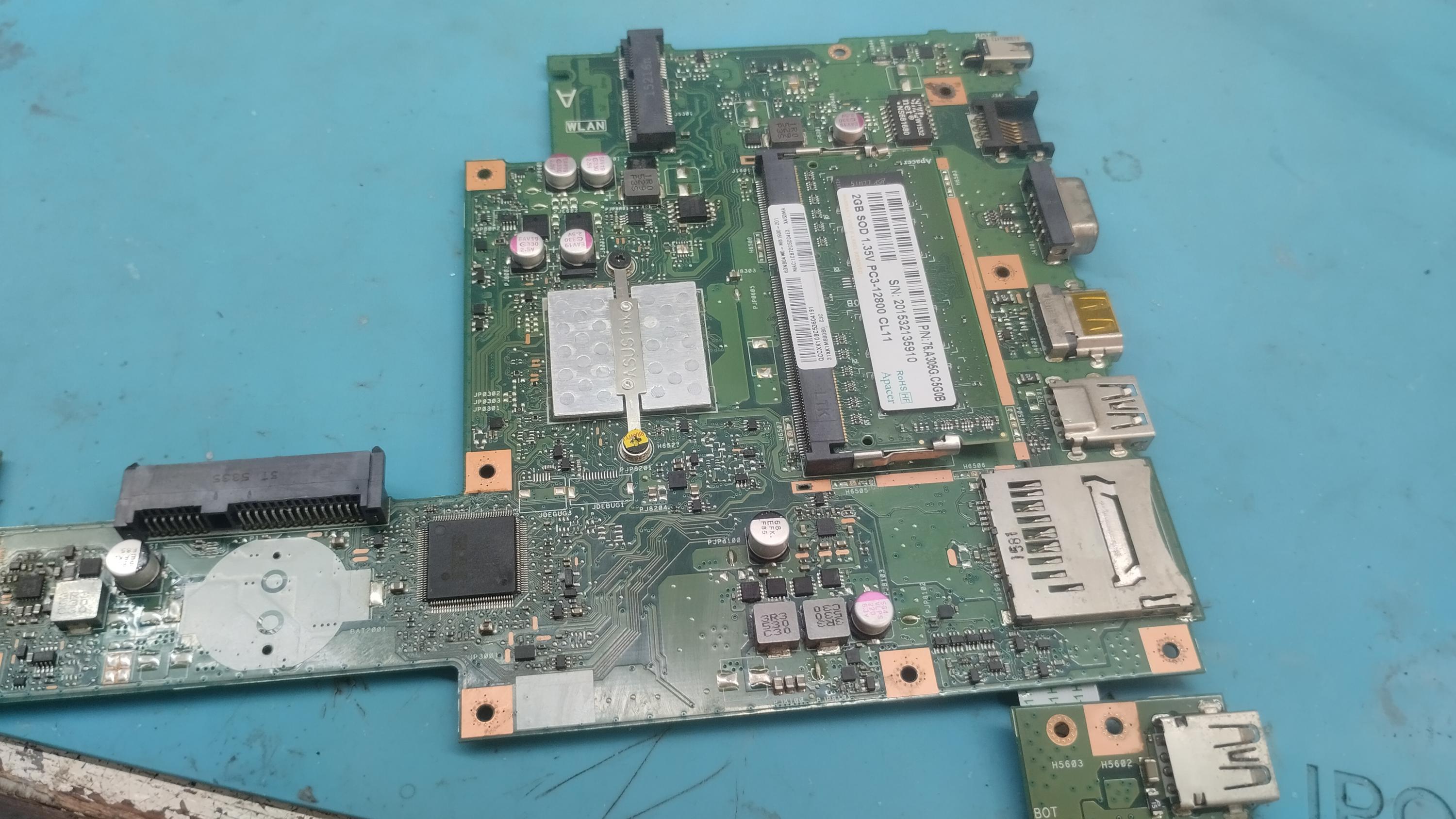

x453ma motherboard, turns on and off inmediatly
  • Gashadow
    • Mar 2017
    • 5
    • Phillipines
    Re: x453ma motherboard, turns on and off inmediatly
    did you try to change SIO and program?
    • jimore
      • Nov 2020
      • 179
      • mexico
      +3va_ec is zero-means ec is not getting power. So ec will not work. Look for shorting in 3va ec line. Might be sio itself is bad.
      i have no power asus x453ma what posible problem
      • mcplslg123
        • Jun 2015
        • 7262
        • india
        You are not new here, so should know by now how to describe problem. Give us measurements and what you have probed so far.
        • Aziz aj
          • Dec 2021
          • 25
          • Bangladesh
          my board turns on and off inmediatly after switching 2 time 3v 5v ok but board not run properly
          how to solve
          • mon2
            • Dec 2019
            • 14631
            Remove all power -> meter in resistance mode -> measure the resistance to ground of each inductor on the board. Each inductor is linked to a local switching power supply and the resistance check is for confirming if there is a shorted component on that power rail. Make a note of any low resistance inductor and post your measurements.
