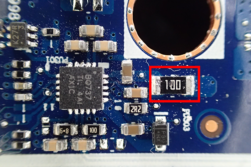

    this is my first request of help. I'm an hobbyist without electronic skills, just willing to repair some laptop of friends.
    I have a Lenovo G50-70 ACLU1/ACLu2 NM-A271 Rev.1.0 without power at all, no led if adapter ac connected. My friend gave me after he broken the pin of the ADAPTER_ID of the cable. I thought I need to change only the part (DC POWERJACK PJ718 DC30100LD00) but after reassembled all the laptop boot fine and entered the OS, but the battery was not revealed . I thought was a software problem: no. The laptop shuts off after 20-30 minutes, even with the ac adapter attached. After few attempts to reboot with power button, the laptop doesn't turn on.
    I removed the battery and even with the ac adapter only attached the laptop doesn't turn on (battery discharged? no battery charge from AC?)
    I tried to reset bios desoldering and resoldering the battery: nothing changed.
    So i'm here to track down what component failed. This is my first time trying to read a schematics but with some help form other posts, I managed to track down these values:
    -- All values are readed with no battery, ac adapter in (not original)
    JDCIN1 20,3v
    PF101 20.3v
    PQ301
    1 20.3v
    2 20.3v
    3 20.3v
    4 0.5v
    5 20.3v
    6 20.3v
    7 20.3v
    8 20.3v
    PQ302
    1 20.3v
    2 20.3v
    3 20.3v
    4 0.5v
    5 20.3v
    6 20.3v
    7 20.3v
    8 20.3v
    PU301
    5 0v
    6 2.6v
    16 6.1v
    20 20.3v
    PQ307
    1 0v
    2 3.11v
    3 0
    4 0
    5 3.11v
    6 0
    I hope in some help, thanks!

                  Originally posted by piernov
                  By the way ACOK is active low on bq24737 (and 247x7 in general).
                  You can still check that you have voltage on B+, PR301 could be blown but I don't think so.
                  Now refer to the power sequence on page 47, and check what voltage/signal you're missing.
                  active low and 247x7 means?
                  Anyway, seems no voltage on B+ and PR301 (both sides).
                  Anyway, rechecking the PU301 (somewhere from pin 16 to 20) i think i blow something... smoke from the component (resistor?) highlighted. (maybe PD303?)
                  Here all the new values for PU301

                  • piernov
                    • Jan 2016
                    • 4439
                    • France
                    Re: Lenovo G50-70 ACLU1/ACLu2 NM-A271 Rev. 1.0 no power
                    The values make no sense so check again.
                    Maybe you're not associating the pin numbers correctly, use the bq24707 datasheet to make sure you understand the pin layout.
                    The resistor may indeed be blow. According to the schematics, this is PR308, a 10 ohm resistor. Measure the resistance across its leads.
                    • Funkwarrior
                      • Feb 2016
                      • 28
                      • Italy
                      PR308 seems blowed. I will buy the new components and i will come back.
                      Thanks!

                        I think the bq24707 is the cause. Try replace it. The ACN and APN should be the same . Around 20v. Check the condisors connected to acn and apn too.
