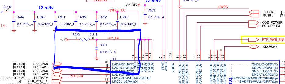

                        Guys i have up lode pic of it8587 can some one tell why pin 11 vcc = shorted to ground is it R232 causing it VCC shorted or some thing else or BAD IT8587 ? BAD BIOS ? help
                        rsmrst = 0v

                          Hi, is it really short with about zero ohm to ground or you just have zero volt on pin 11? Which means you don't have the +3V, do you have the +5V?
                            Re: e5-471 no power
                            pin 11 is ok/not short/ but 0volt reading when you pull out the r232 resistor,which means before caps 269 and before r232 the line of +3v is already shorted to ground..
                            i already pulled out and measured all the line of +3v but all i pulled is good..

                              What are the voltages on pins 1,4,5 of PQ15 and pins 1,2,3 of PQ16.
                                Re: e5-471 no power
                                Pq14
                                1=0v
                                4=0v
                                5=5volts
                                pq16
                                1=0volts
                                2=0volts
                                3=3.3v
                                pq16 pin 1 is shorted to ground

                                    Re: e5-471 no power
                                    This is normal, if you have a single short circuit to ground on the + 3V rail, all components measured will be short to ground. In addition, you can check the PQ31 transistor. AVDD is connected to DVDD through L34 and DVDD is connected to + 3V.
                                      Re: e5-471 no power
                                      jarotech thank you,i already lift off pq31 and test
                                      pq31 pin
                                      1=0v
                                      2=9v
                                      3=0v
                                      pin 3 is shorted to ground,so i lift off pq31 to check,but still shorted at pin 3 even pq31 is pulled out
