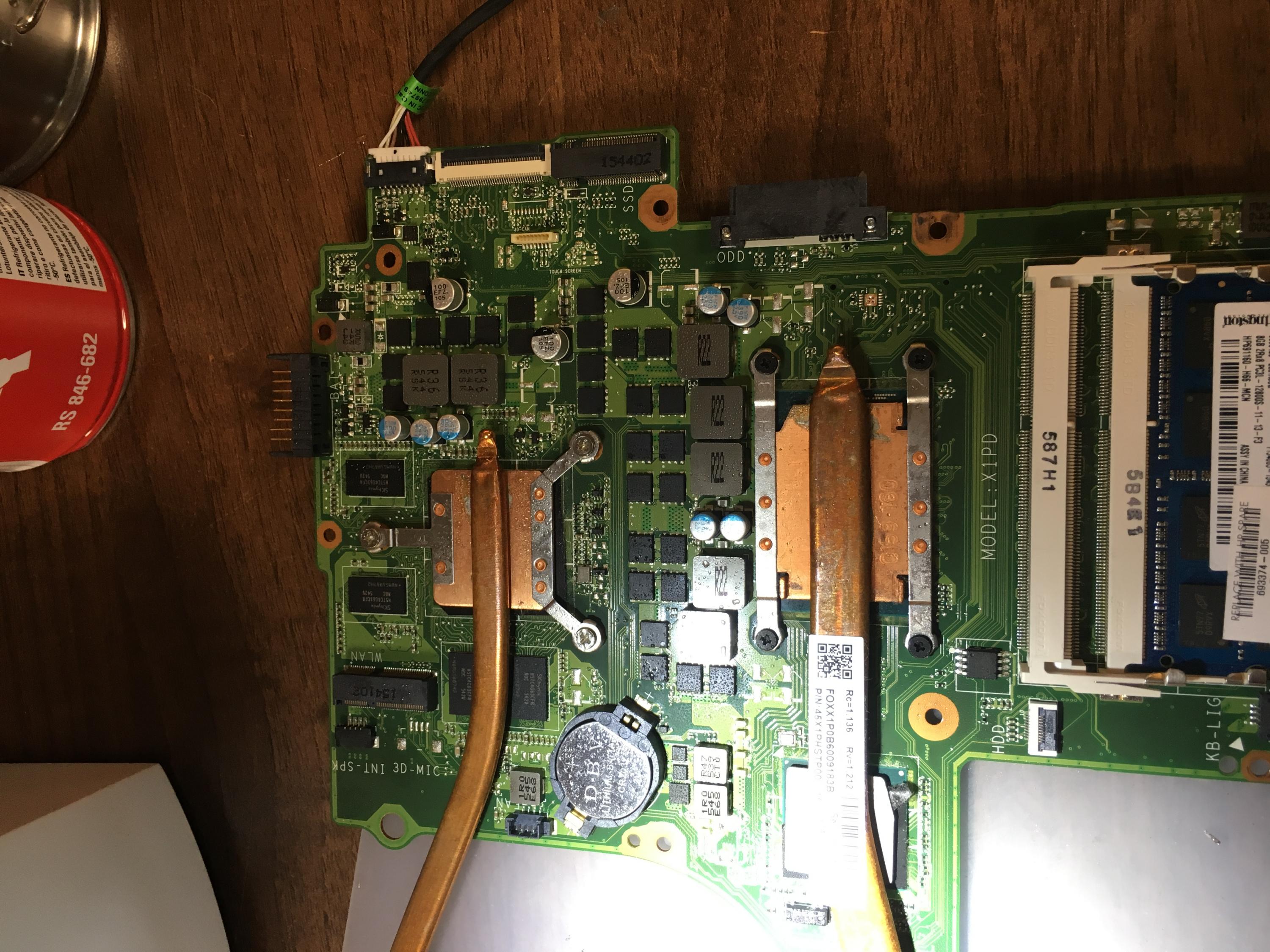

    HP Pavilion Gaming short circuit

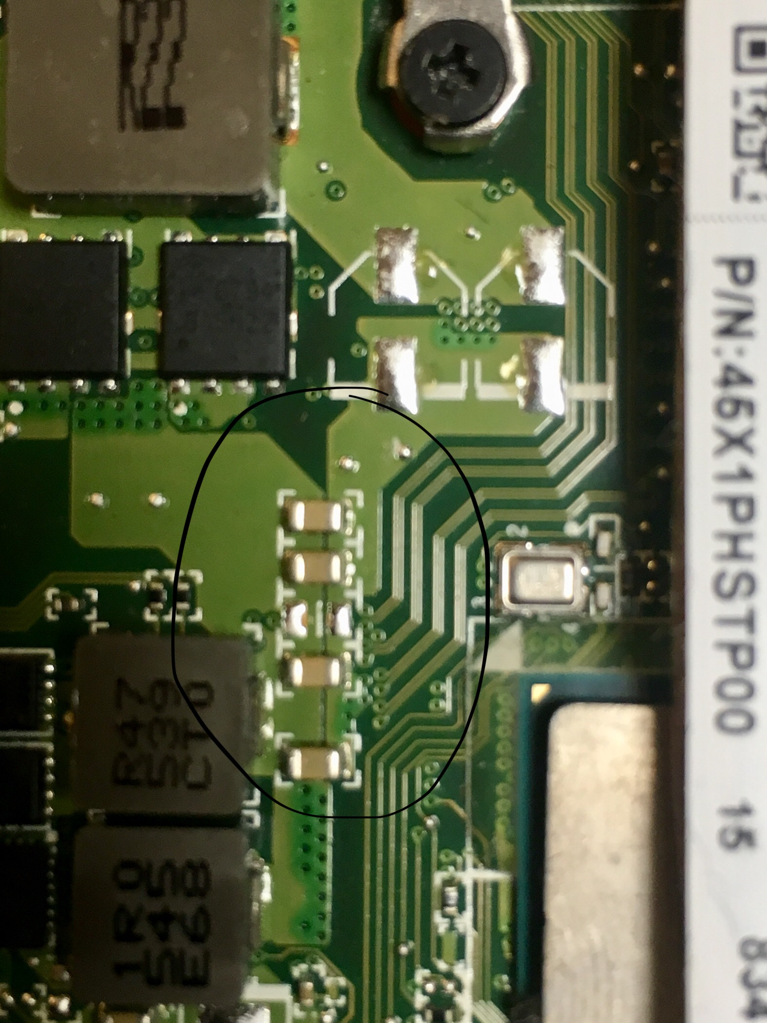

    Hi guys HP with board X1PD, "Boot option not found" on start up, no volts at hard drive. Clusters of caps in the centre of board all seem to be shorted, I've sprayed freeze spray on both sides of the board but cant find anything getting hot. Any suggestions?

        Re: HP Pavilion Gaming short circuit
        i dont see any clusters of caps...

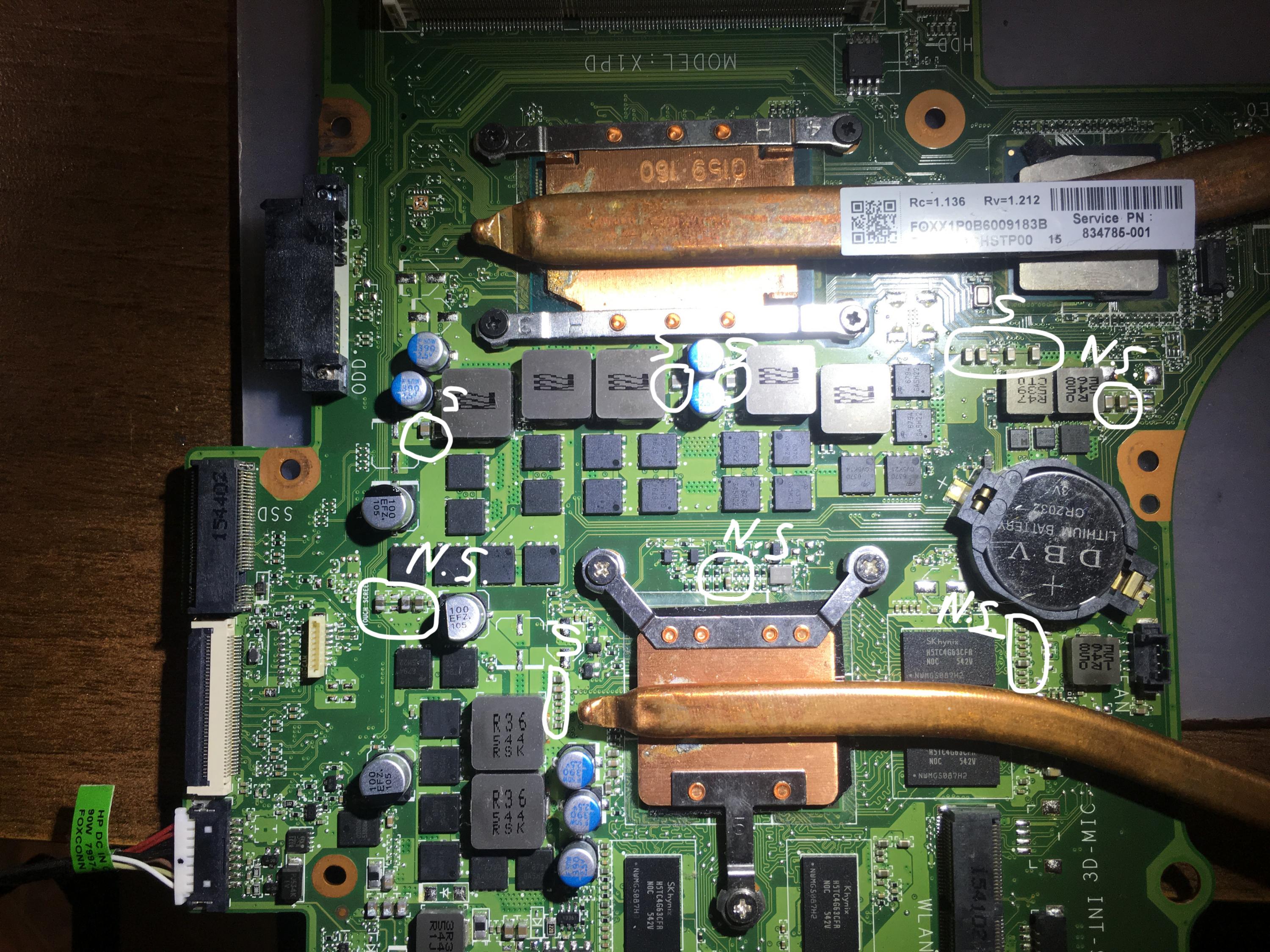

              My freeze spray freezes then melts leaving a wet residue. I usually brush on isopropyl and then give it the once over with the hot air station. I thought they all worked like this. It is electrical freeze spray. The caps in the centre are all shorted, laptop does power on, just no volts at the hard drive....just realized I posted in the wrong section, I do believe it was late when I originally posted
                Those caps are connected in parallel, so if one shorted out then they will all show shorted circuit, if the load is shorted out then you will also get short circuit reading.
                    N.S. = not shorted
                    S = shorted
                    nothing burnt, nothing getting hot
                      You need to remove the caps to see if the shorts will go away or not first, if the shorts are still present then you need to trace the circuit to find out what it is connected to that may have shorted out.
