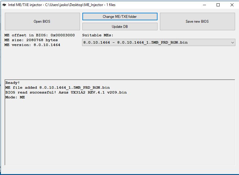

    Another ux31 with a fan issue, but this time I could not solve with a clear ME.
    The strange is:
    with no lcd cable connected
    FAN_PWM and FAN0_TACH change value
    the fan speed goes from 0 to 50% of the maximum
    with lcd connected
    FAN_PWM and FAN0_TACH don't change value
    the fan speed remain at max speed
    This for me exclude a ITE problem , but what connection there is with the screen ?

        Yes boot, all works fine , temp are very low (cpu < 33 c°) but fan always at max speed.
        The tool to control the fan speed recognize fan rpm but it not be able to change the fan speed .

              Re: UX31A2 rev 4.1 fan always on
              SMB1_CLK and SMB1_DAT signals also come from lvds connector. Probably problem with those signals from lcd screen. Try to replace screen. What if you disconnect those two signals from lvds connector (remove the two resistors, r4505 and r4507);
                Thanks for replying back. I did find out that it is the LCD screen and when I unplug it I was able to hear the sound when it loaded into windows.
                              In my case the external display works well (internal lcd flat disconnected) the fan speed change but not with correct speed / cpu temp.
                              And The fan speed tool now can change the speed. I try with another lcd with the some result. Unfortunately it''s not simple open the lcd case because the frame is firmly in place with strong adhesive .

                                This is the tool and the ME bin file to perform a clear me.
                                1 - use bootable dos pen and FPT tool to make a dump of your bios
                                2 - run ME_Injector as administrator
                                3 - choose the directory where there is the file me 8.0.10.1464_1.5MB_PRD_RGN.bin
                                4 - load your bios dump
                                5 - If in "Suitable MEs" not appear the me file chose Update DB
                                6 - If no errors use "Save new Bios" to save a clear ME new bios
                                7 - Use FPT to programm the new bios
                                I attach a UX31A2 clear me that I make for my laptop
