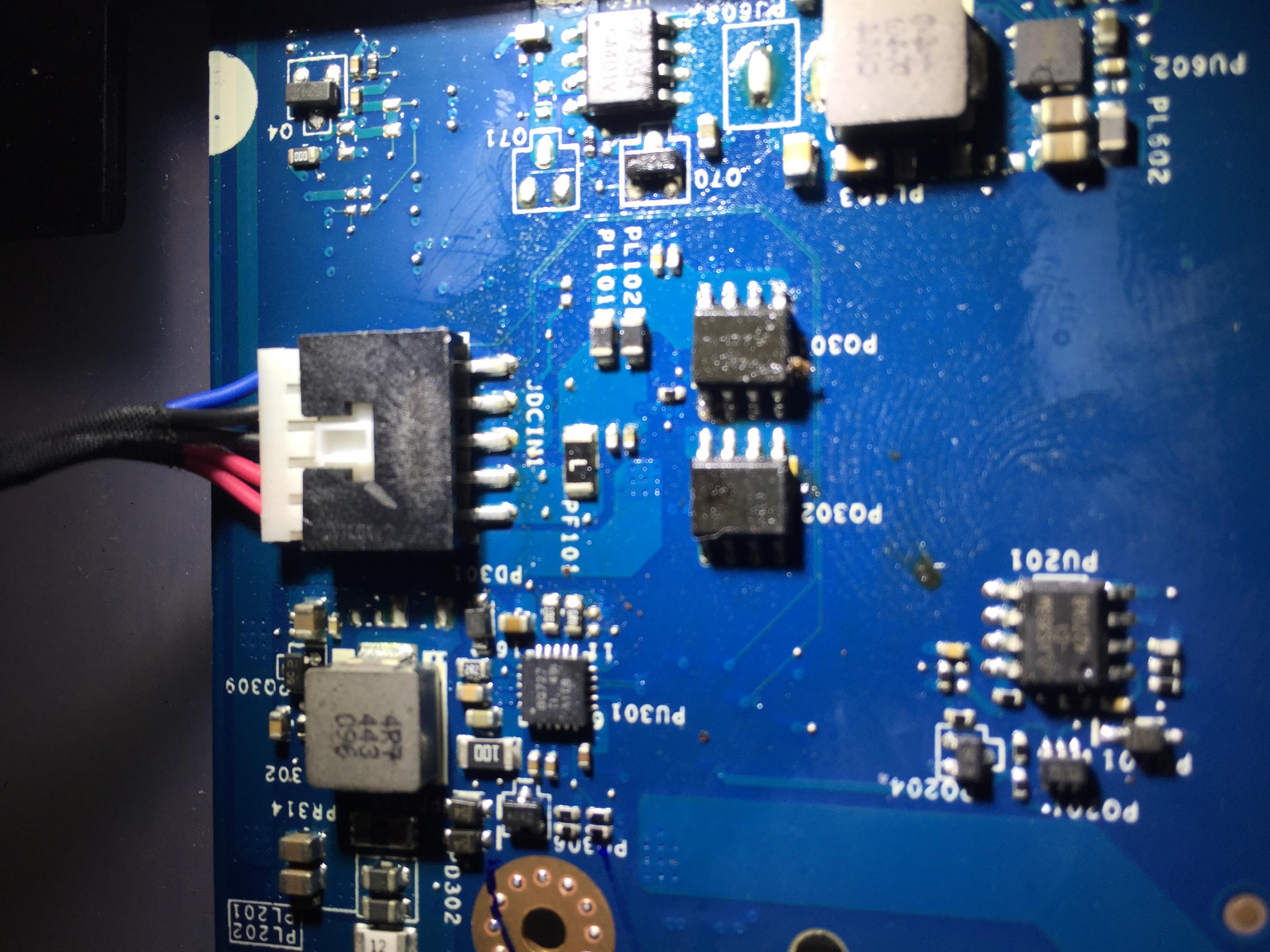

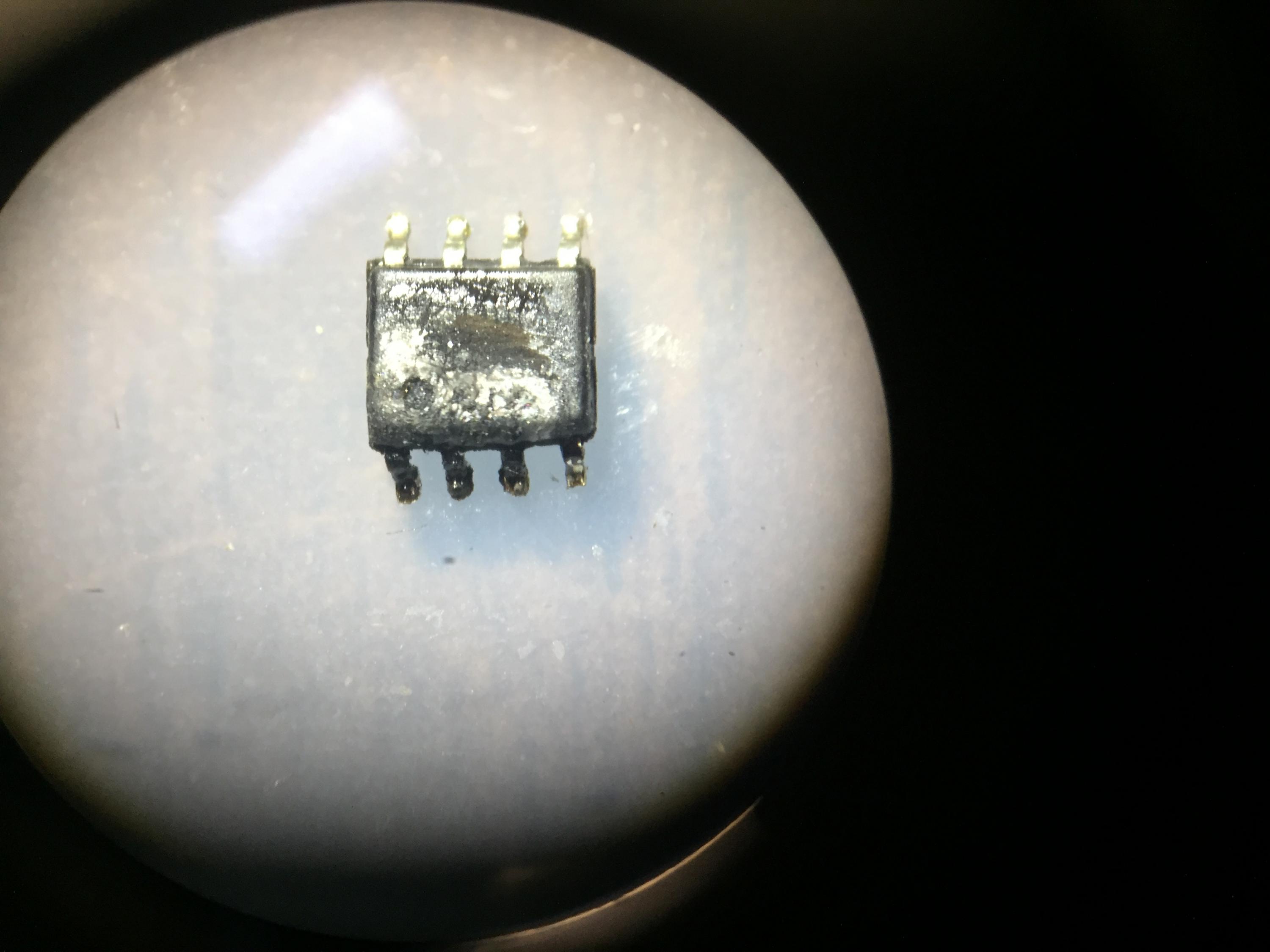

    Hi guys motherboard took heat after dog chewed the power cable I replaced one fried component, can anyone tello me the next step? Im getting 20volts on the board side of the DC-In jack, that's the extent of my testing

    u didnot mark component but it is two mosfets that activate VIN main power. u must find 19V after second mosfet or u have problem :-)

      Re: Lenovo B50-30
      trace first the 19v rail on the first two mosfet

        Re: Lenovo B50-30
        if the first photo was rotated 90 degrees anti-clockwise (as i should have done ) Im getting 0 volts on the right side of the mosfet P0302. This was the mosfet that was badly burnt, I replaced it using a mosfet from a donor lenovo board but Im still getting 0 volts. Do they have to be 100% the same or will a similar one do the job?

            Re: Lenovo B50-30
            check BQ24727

              Re: Lenovo B50-30
              vhat voltage do u have on base of second mosfet?
