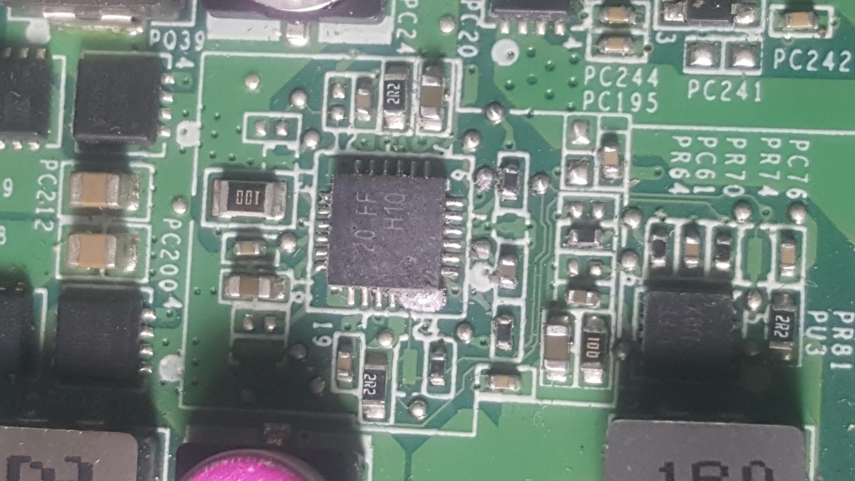

    hp DA0U93MB6D0 unknown chip
    Hi, schematic or boardview unavailable for hp amd DA0U93MB6D0 so
    I have some difficult to recognize this component
    thanks

    Re: hp DA0U93MB6D0 unknown chip
    People say that Quanta u72 is similar, that schematic is available. RT8223?
      thanks
      Replace with Tps 51123-100% sure. Richtek marking 20=RT8223=TPS 51123
