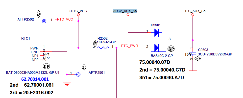

                Here is the schematics document for Dell inspiron 5458.
                first check if it matches your laptop.

                  thanks caspian for the schematics i already checked in the rtc1 section voltage on d2501 3D3V_AUX_S5 is there and have 3v but i cant find the C2503?

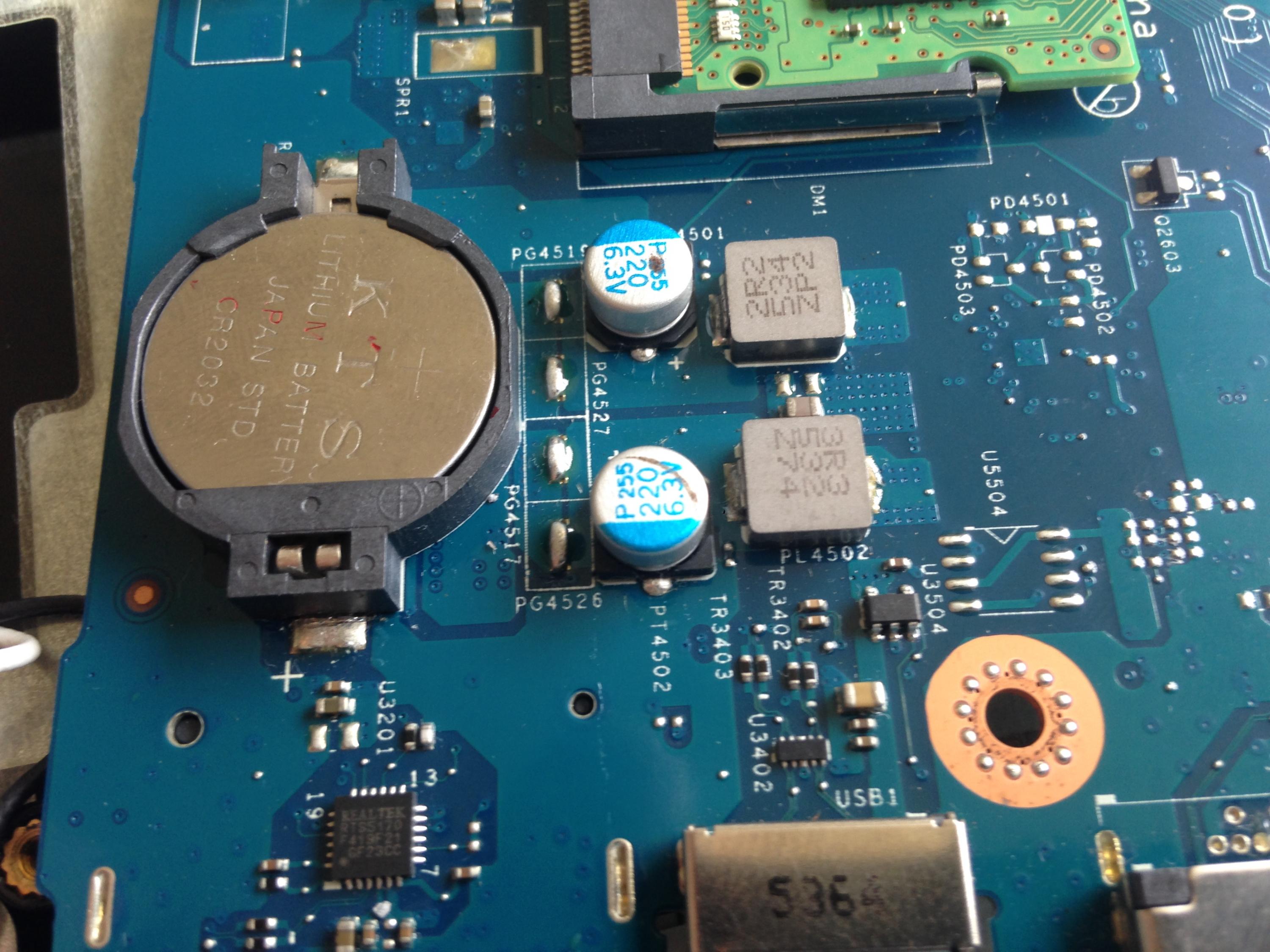

                        thanks but i cannot find on the board the r2502 c2503 voltage on D2501 pin 2 have 3v on 3D3V_AUX_S5 and the on Q2505. i have attached the image of the rtc on the board please help on this

                          as per the schematics attached by caspian, you need to cut the pin12 track of the sound ic. No need to remove any components. Its labelled "audio pc beeps". Just do it with 100% confidence as i have done this on many many dells and sound from speakers and headphone will work perfectly.

                            check R1720. it should be 330k.Signal name-RTC_AUX_S5

                                i still cannot find the R1720 on the board maybe ill try to cut the pin12 of realtek ALC3234

                                      Go ahead man, atleast you will get rid of those annoying beeps.

                                        @mcplslg123 thanks man i cut pin 12 and now there is no annoying beeps and laptop boots fine with this 1v cmos battery
