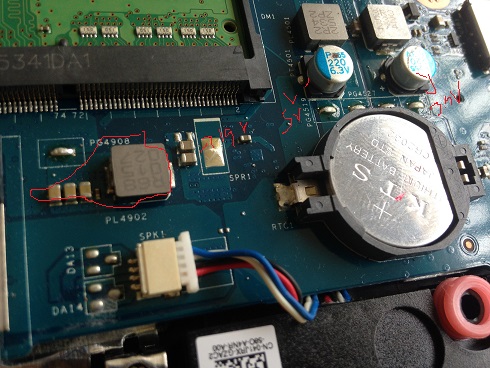

                  Re: dell inspiron 5458 dead after shut down
                  thanks for the response i have attached the image near cmos and mark the coil and capacitor that has 0v
                  • ramneb
                    • Sep 2017
                    • 3
                    • Philippines
                    it could be, there is a short circuit on it, try replace cmos battery, see what happens,
                          can u show the pic of model MB ?
