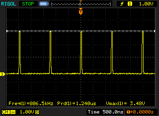

    Check voltage on APU_RST#, APU_PWRGD, +0.95VS5. Any activity on BIOS CS# pin?

      See attached pic of bios cs# pin

          Everything looks fine to me so I don't know why the BIOS POST would fail. Make sure the RAM & CPU are good and compatible with the board, check if any IC (Ethernet/audio/card reader) gets hot or looks bad.
          Make sure you are using a good BIOS, maybe try with another dump.
