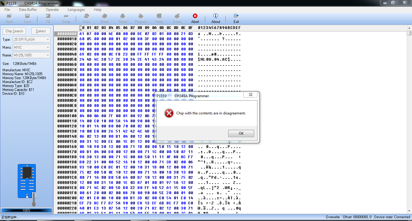

    Dear all,
    plz help me recently i had acer 5740 (i3) wriston JV50-CP which was not power on.
    At TPS51123 i got 5v & 3V @ pin 8 &17
    Battery connector i had 3.3 v
    @ U16 ec bios pin no. 8 - 3.3v
    @ U56 system bios no voltage at any pin
    Plz suggest me what should i do next...sorry for my bad english.

        Re: Acer 5740 dead no power no led indication
        Thanks Guyz for reply .
        i try to flash EC and i have CH341a USB Programmer black edition but when ever i try to write bios it will shows the error "chip with the contents are in disagreement " how resolve it plz suggest.
          Did you delete chip content before flashing?
            yes ,i erase but this to not work
              Try to read the chip and see what you get.
              Probably just a bad connection or maybe a faulty chip.
                Yes i can read data ,is there any dump comparision method to compare with new dump
                And second thing this ic is not available india so can i use alternate ic in place of this
                    try to clean adapter pin on the prorammer with isoprphilic alcohol
