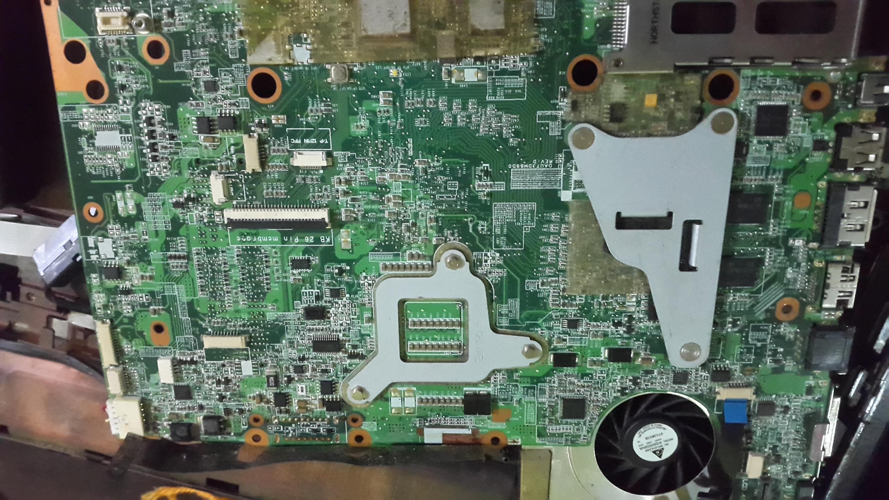

    I have a dv6 1205ee... problem is stanby light is but no power fan not spinning... problem hapend when im installing keyboard powered on then shuts down something shorted somewhere cant find no burnt component... ive checked 19v and power button but theyr ok... check some 8pin mosfet it shows 2.5v... tried discharging the board powering on with power unplugged
    Help im stuck in here

    Re: hp dv6 core2dou.. no power help
    you probably fried kbc

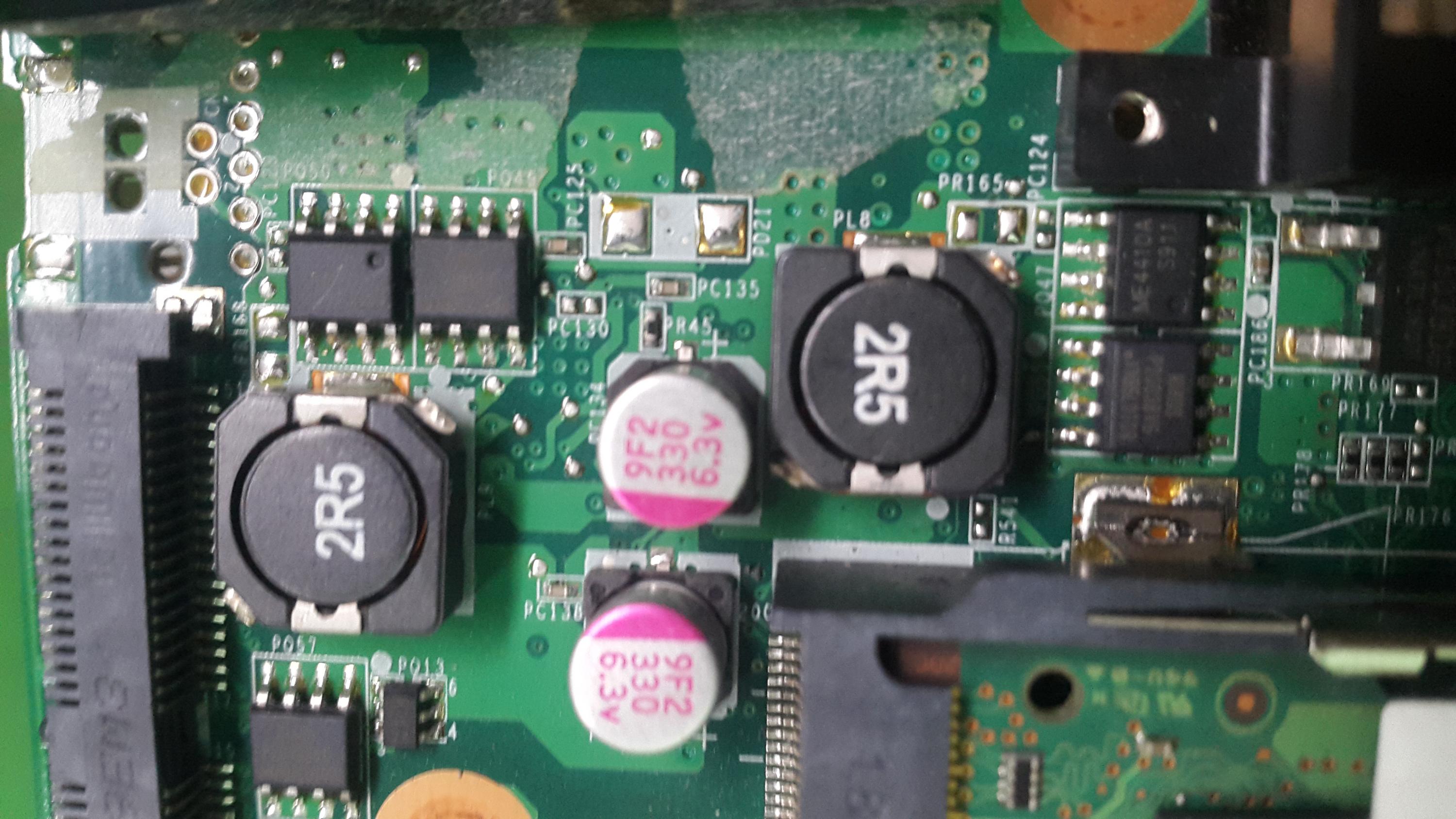

          you must firs meassure if you have +5V and +3V ALW lines present after inserting power adapter.they are created in PU2,you can meassure it on coils PL8 and PL9.schematic in attachment(i think is the same model)

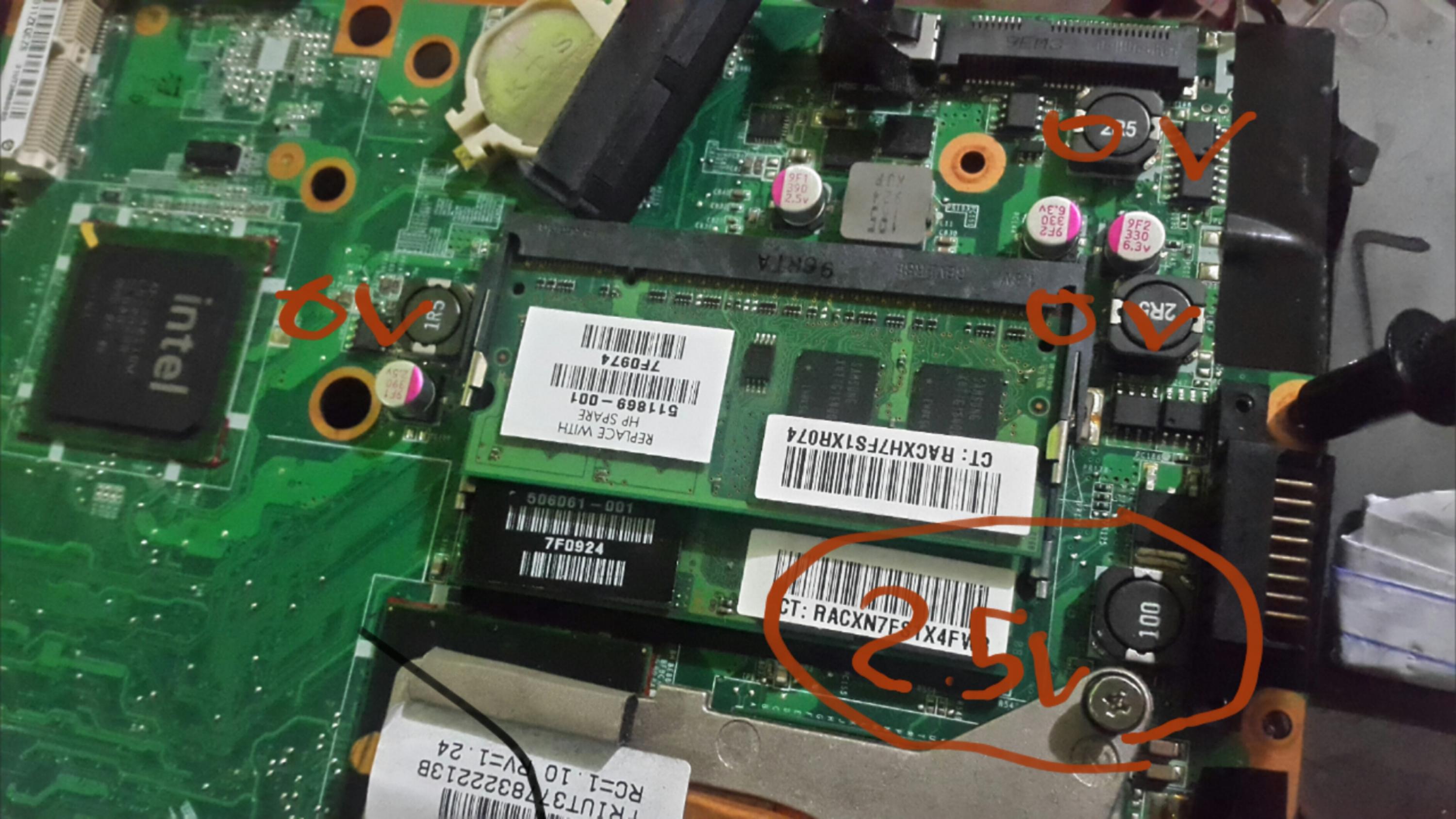

                Theres 4 coils no voltage coming out with adaptor plugged
                  Sorry one coil reads 2.5v
                    you must find exact these two, PL8 PL9 and meassure there,i dont see the marking on your photo.if is no voltage there then check PQ55 PQ47 and PQ49 PQ50 for short.
                      Thanks for you time sir... pl8 and pl9 dont have voltage coming out... pq55 and 47 is near pl8 and pq49 50 near pl9 ive checked those and 4 mosfets theres no short
                        Pl7 has 2.5v and pl12 has 0volt

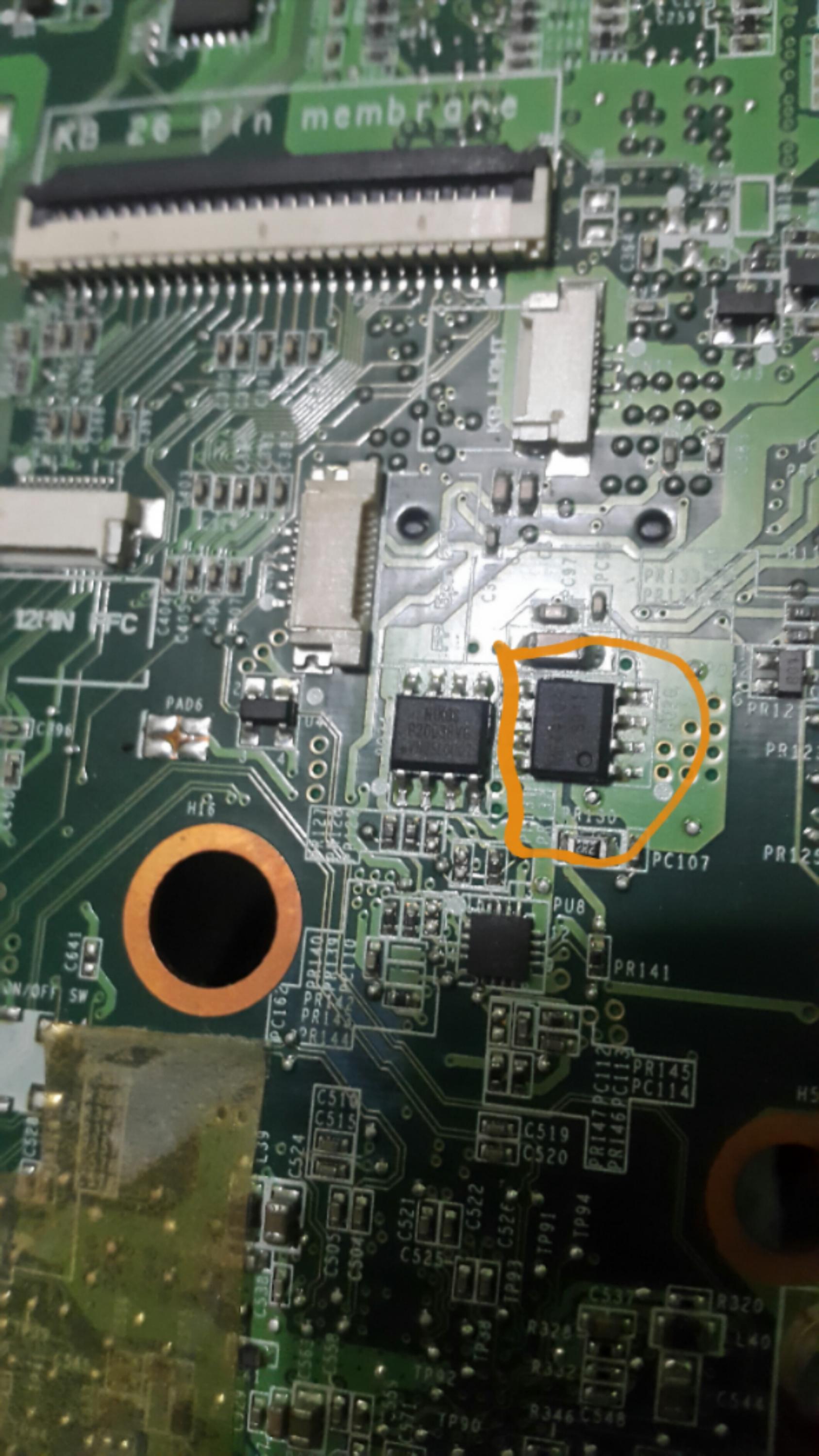

                          ok,you have no ALW voltage present,now only find out why :-)
                          try to meassure pin6 on PU2(i attached datasheet for this ic to see whitch pin is that).if you have voltage here(around 19V)then replace this ic and your laptop shoud start normaly
                              Pin6 of pu2 reads 2.48 volts
                                and on pin 5,6,7,8 PQ49?
