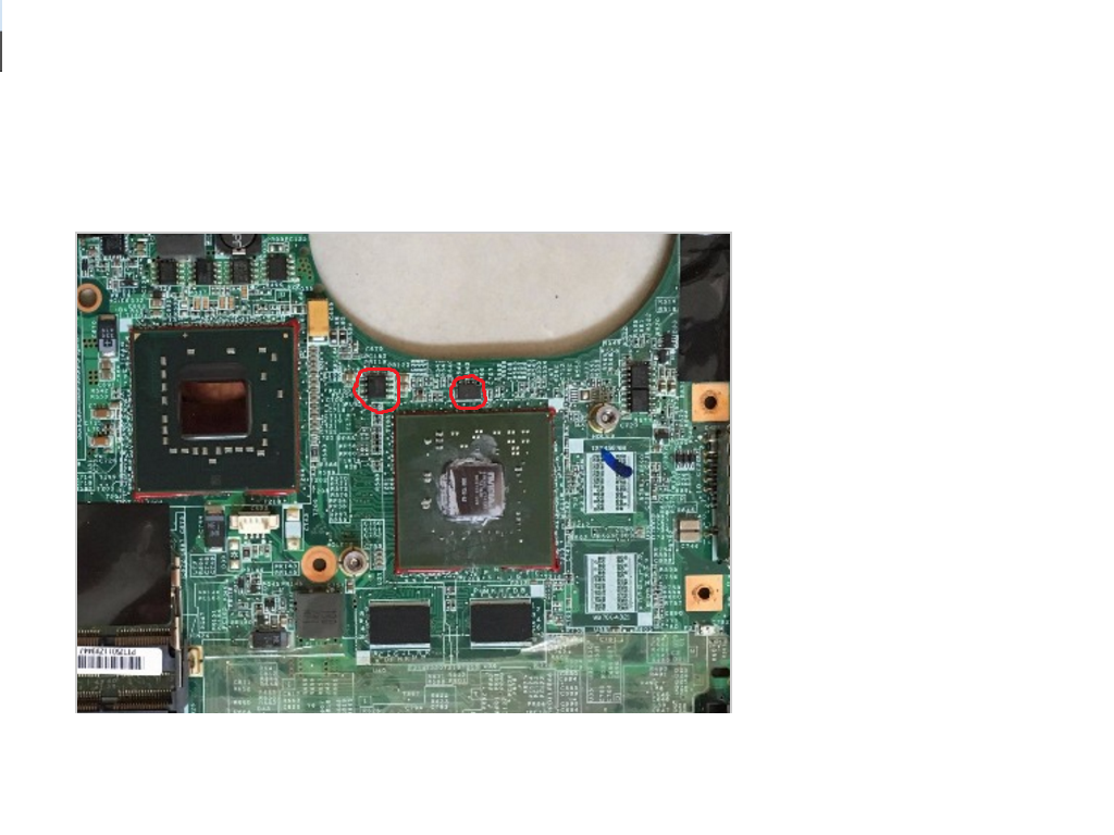

need help identifying dv6500 parts
  • max30
    • Jul 2017
    • 16
    • philippines
    i cant identify this 2 components on top of the nvidia gpu .is this 2 connnected to the gpu connection? i over de soldered it that the soldering pins under it got off is there any way i can trace the connections back?
  • mielta
    • Apr 2015
    • 368
    Re: need help identifying dv6500 parts
    Hi
    i attched the schematic
    First is PU9 on Page 46
    Second is Y5 a 27MHZ Quarz on Page 15
    I hope this help
    • max30
      • Jul 2017
      • 16
      • philippines
      thank you for the reply but there is no chip here in our place selling this pu9 chip . and i cant find pc152 or pc154 in the board .
