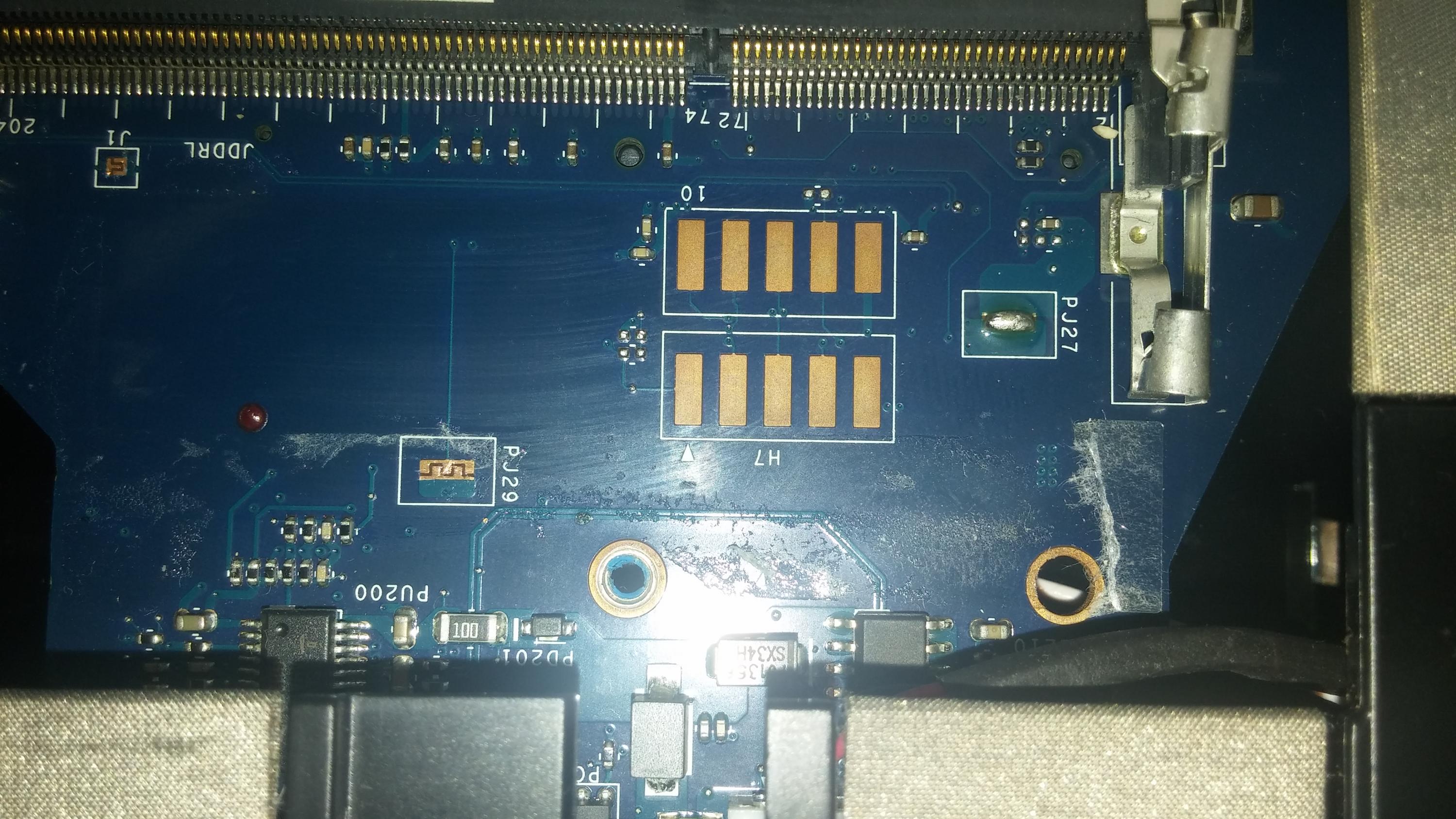

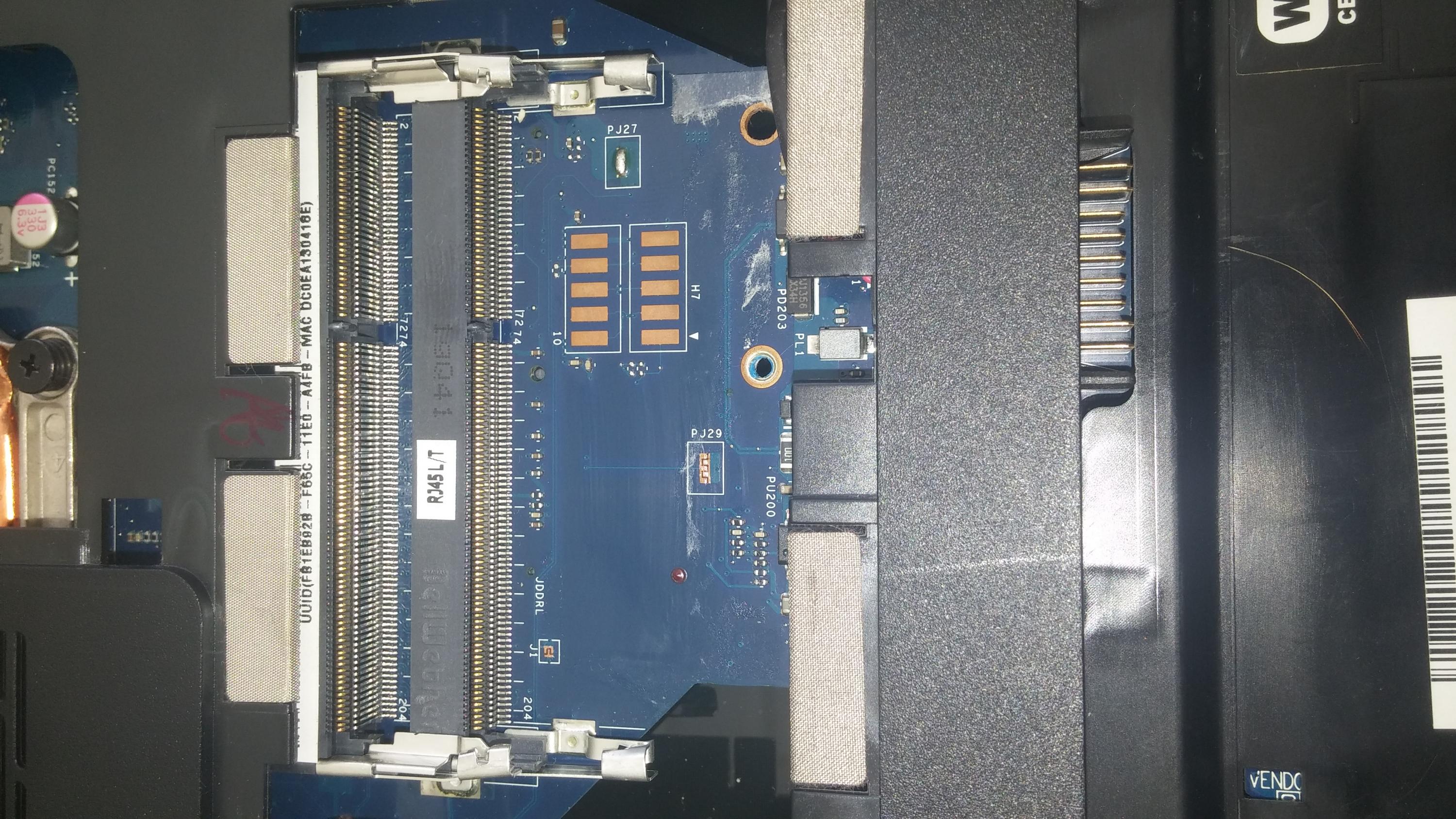

    hi there i got this off of gumtree it has a power on password cant access bios settings or boot without password, i have looked for the normal jumper pads under memory and tried cmos battery out for over a day and still has password.. any ideas please

        Definitely no jumpers under near the memory slots ? Can you take a photo ?

            nope i have looked everywhere

                      Hi
                      PJ29 is the jumper to clear Password

                        YES mielta is right.
                        here is schematic check page 11

                          hi thanks for the info.....does it mean put a solder bridge across pads as it says about 10k res on 10/26 to pull high? "Reserve PJ29 and add R1159 pull high on 10/26" fed with 3v or have a read it wrong ??

                            thanks for the info i was looking at that a day ago the pads that is lol

                              thank you both its sorted held a link across PJ29 for 15secs all is ok now
